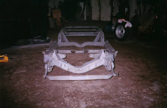

I had my frame dipped, and I would do it again it worked so well! In fact, after I had the frame dipped, I took all the other parts I had and had them dipped as well. This was over 10yrs ago, and the cost then to dip the frame was $250.
Ya, that looks good. I think i will do the same with the parts i am keeping. I thought about buying a smaller sandblaster for those but still don't know. I suppose some sandblasting might not be so bad.
