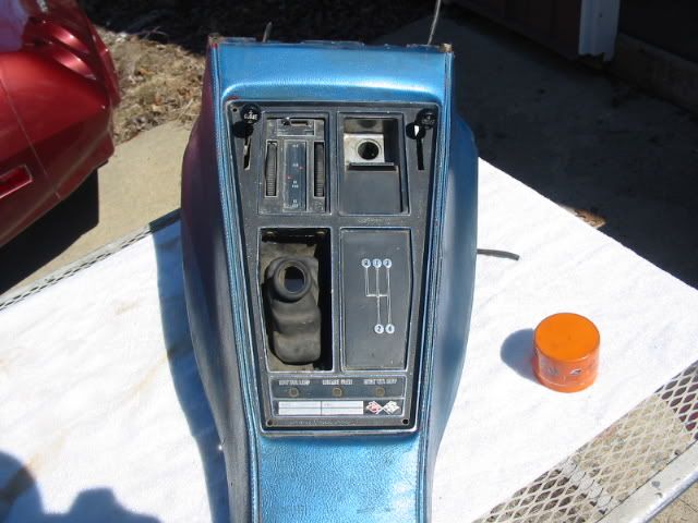

I would say to restore your old one, little talent and you get to still have an original, instead of a repop. Here is a pic of my 73 I didmyself, and one I did of a 74 as well.

I did this '69 not long ago in the kitchen. Very very easy job.
(ignore the custom painted ashtray lid... I ended up not using it. Long story. )
How did you get the chrome to come out so good? My 82 is plastic and the shiny stuff is off in a couple of places.

The 68-76 shifter consoles are chrome plated, diecast steel. The 77-82 shift consoles are black plastic, with a foil type chrome trim, added to them.

The early ones are chrome underneath. If it's damaged, you cant really fix it, However, if they are intact after you paint them, you can carefully remove the overspray and paint on the raised areas like letters and it looks like new.
