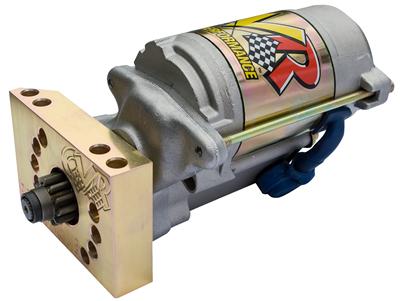

I'm going to be doing an Auto to Manual swap and it looks like my Auto starter won't work with a 168 tooth flywheel. So if I have to buy a new starter, I want to replace it with something lighter. So what fits our cars with the 168 tooth flywheel? Can I use a starter off of a 91-96 LT-1 corvette, or something similar? Are those starters different for manual and auto also? Autozone sells a Duralast brand Mini starter, will one of those fit? help

I replaced the starter in my 68 last June with a mini starter. Smaller, lighter and 3HP torque 168 tooth. Here is a sample posting on ebay.

Thanks, That's just what I had in mind.
And you're using this on a manual transmission car?
How's the quality of these DB electrical starters? I've read good and bad on them. are they made in China?

Yes, I have a 4-speed Muncie. For $45, free shipping and easy installation, even if it fails every 12 months, it costs less to replace than to fill my tank Seriously though, it cranks up every time no problem. For what it's worth, this part was recommended to me by a reputable CF member whose recommendations and experience with C3s is beyond reproach. Anything he recommends for C3's is 2nd to Duntov in my book. He uses the same one in his C3 which is now in the process of a LS swap.

Did this just bolt right it, or did you have to shim it?
What are starts like on hot days?
I have a standard-type starter that hasn't failed me yet (knock wood), but I was really holding my breath getting gas on the way home from Carlisle last year, being 175 miles from home and hearing the starter turn the engine a half turn about every 4 seconds! Do you know how the torque of this relates to the standard-type starter? They are easy enough to change, and at $60, this thing doesn't break the bank.

One of these 'mini' starters, which mount to the engine block, fit both 153 and 168 tooth flywheels/flexplates. Plus they are adjustable to clear exhaust, oil pans, etc. Summit Racing also sells repair parts. Much lighter weight than OEM starters. They are gear reduction instead of direct drive. The one I bought happens to be ProTorque, and it has never failed my mouse motor.

I installed a DB Electrical 168 tooth mini torque reduced gear starter.
They have great tech support if needed in helping with application.
My orig BB starter was struggling to turn over the stock engine.
The mini turns it over like its a riding mower.
1/3 the weight to have to bench press during install.
Easy as all wires were a direct swap over.
I still have points.
Starter can be used on either TEI/points.
Ill see what happens this summer.
But for $57.00 shipped I figured I'd giver it a try
especially since it got rave reviews on this forum by actual
users.

Well, it might not be all sweetness. If the one I bought is any indication, you cannot just align the correct bolt holes for your flywheel diameter and bolt 'em in. Shims are provided and you must measure the proscribed distance of the ring gear to the engaged starter gear. I used a bent paperclip per the instructions. Which on the face of it doesn't sound like it's all that hard. If you have the driveshaft, shifter, transmission and bellhousing out, it's not.
Choose carefully which model you buy. Some might be like Ron Popeil's "set it and forget it." Some are not. If you think counting up to 153 ring gear teeth is a chore, you won't like trying to measure the engaged starter gear at 3 or 4 locations around its perimeter.
