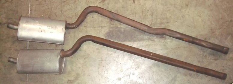

Not to continue the hijack, but simply to clarify: '68's with N11 had 2 1/2" pipes. SB engines of either power rating with standard exhaust had 2". The N11 mufflers both on C2 models and '68, which was the only year N11 was offered, looked very similar to the standard mufflers but differed considerably with the number of baffles as Alan noted above.
Here's a decent write up on the CC site
http://www.corvettecentralexhaust.co...k_off_road.php
and a picture of a used set off a '67
I don't doubt that you've owned the car that long but it seems somebody changed the pipes before you bought it.
