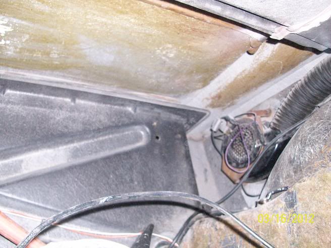

got my interior gutted and was wondering, what is the roof of the rear bay behind the seats suppoed to covered with on a 73? is it open to the body, or am i missing something? mine actually has a piece of galvanized sheet metal flappin around..pix appreciated...ill go grab a couple of mine
also, the doors for my rear storage areas are good, but dnag i cant get the old carpet off. when i scrape or cut it only small pieces come loose. is there anything that will loosen up the nearly 40 year old glue?

heres some pix

The brown in the second photo looks like stock bare fiberglass. I have no idea where your galvanized material has ocme from. The AIM shows what is and is not supposed to be there.

yep the browns the fiberglass. the tins from bubba im sure. ive been through the AIM page by page and cant find anything
thx 73, but im guessin none of that is original..im changin the tubes, they r cracked, but just wondering if there was any roof liner im missing

astrovent blocked from the factory according to the aim. who knows what bubbas thinkin when he does this kinda stuff. no matter anyways. no signs of water leaks back there, although the plenum tubes are rotted. still curious what was up there from the factory, how about older or newer years? any of the all original guys have any pix?

I was just kidding.....wanted to keep it looking original is why I hid the components back there....
Our car is original and there was nothing back there....I don't have a pic of that area before I dynamated it....but, it was just fiberglass.......

Nothing. Underside was bare fiberglass.
