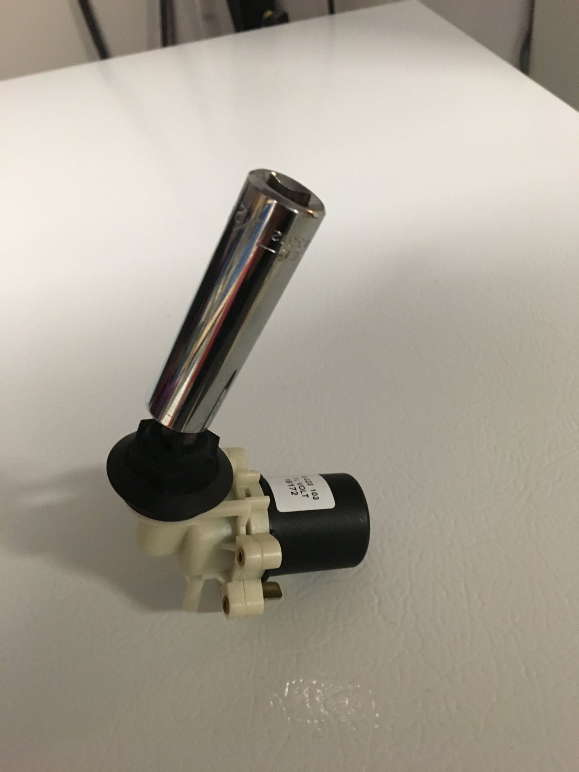

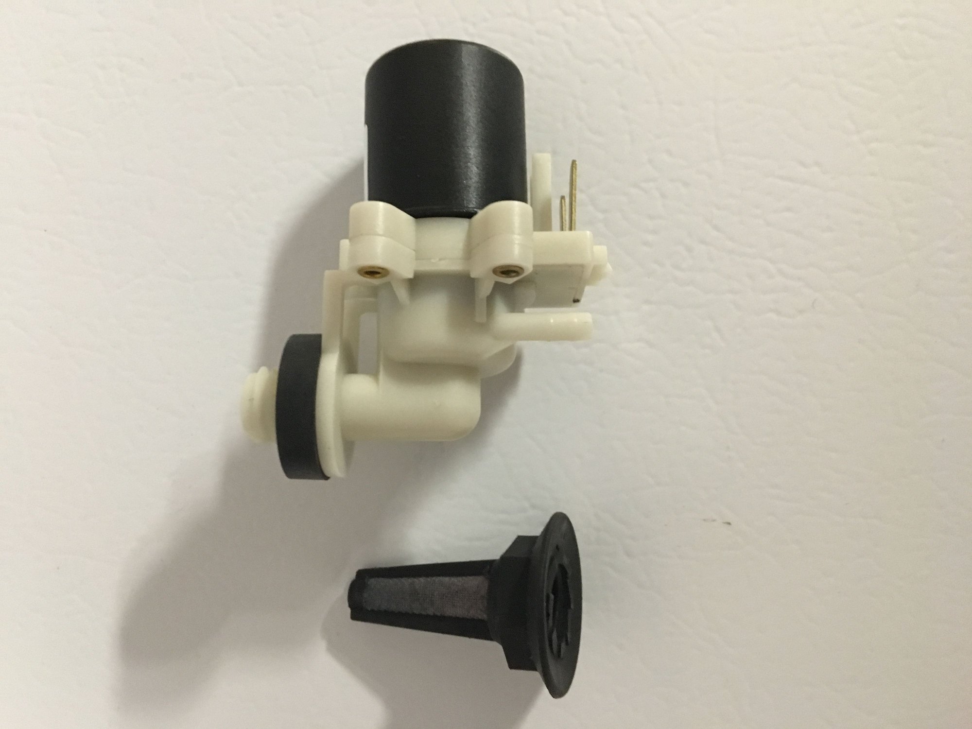

Pump with filter removed

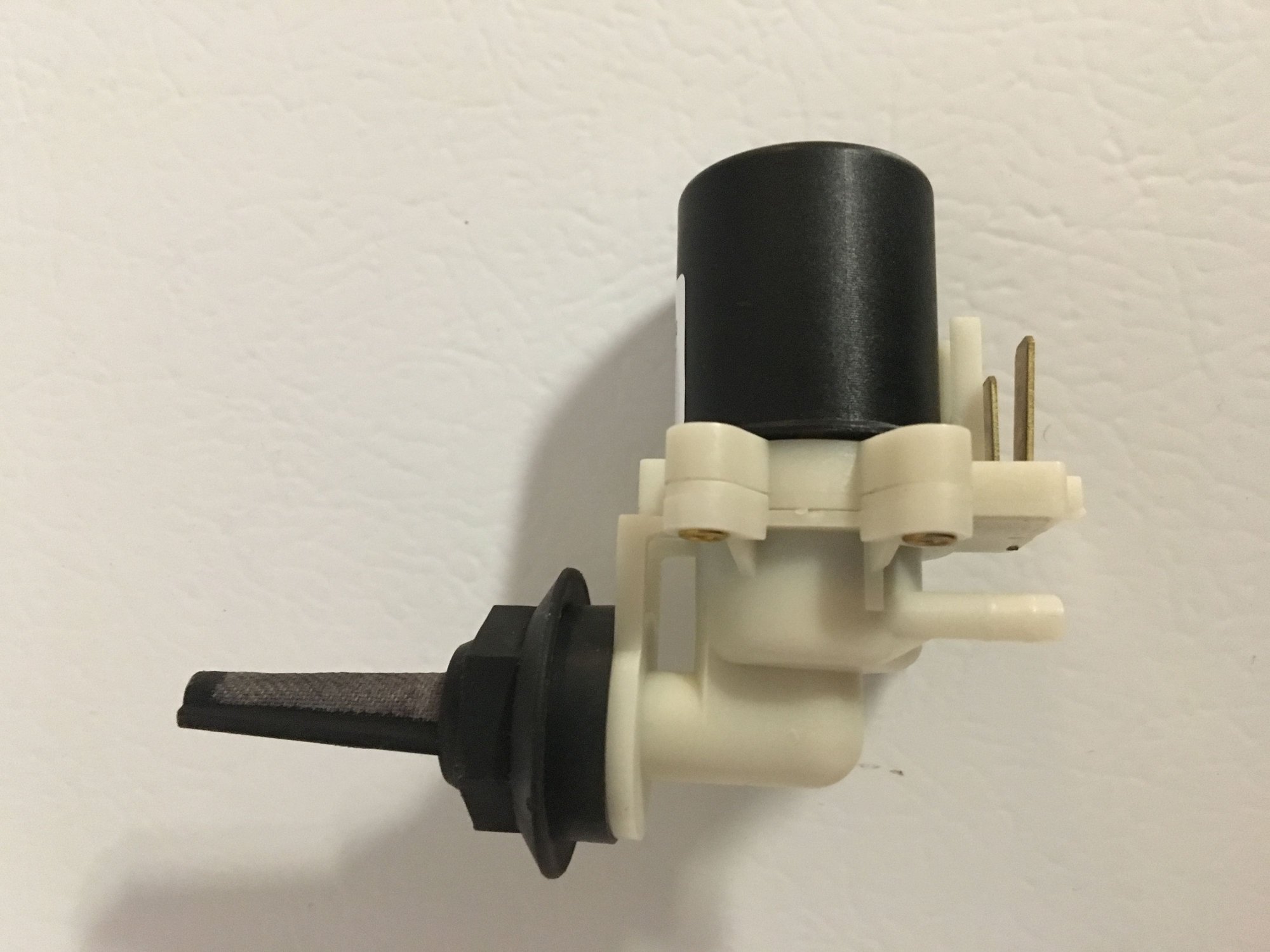

Pump with filter installed

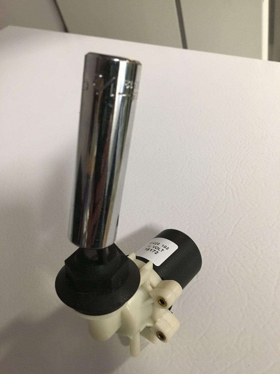

Deep well socket on filter. I think it was a 1/2” socket
Another view of the socket on the filter

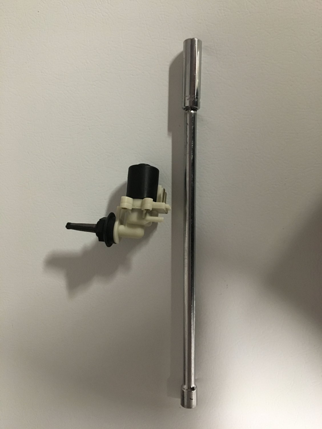

Deep socket on a long extension
Not it sure if this will help you or not, but this is how I did it on my ‘77. I couldn’t get the reservoir out of the car so I had to do it with the reservoir inside the engine bay. I did remove the reservoir from the bracket that holds it on. Then I took the filler neck off. It just pulls off. Removing the pump was just a matter of rotating it until the filter came off in the reservoir. You could also use the deep socket and extension to remove the filter.
To install the new one, I turned the reservoir on it’s side and held the pump on the bottom of the reservoir. I put the filter in the socket which was on the extension. By holding the whole assembly sideways I could get the filter into the reservoir without it falling out of the socket. I got the filter on the threaded part of the pump and screwed it on using the extension as a nut driver. Discovering this took me about 2 hours of trial and error and more than a few choice words. Once I came up with the socket and extension trick, putting the pump in took less time than it took me to put the reservoir back, reattach the electrical connections and the plumbing and test the new pump. All told, using the extension trick this could take less than 30 minutes. Hope this helps someone. Cheers!
