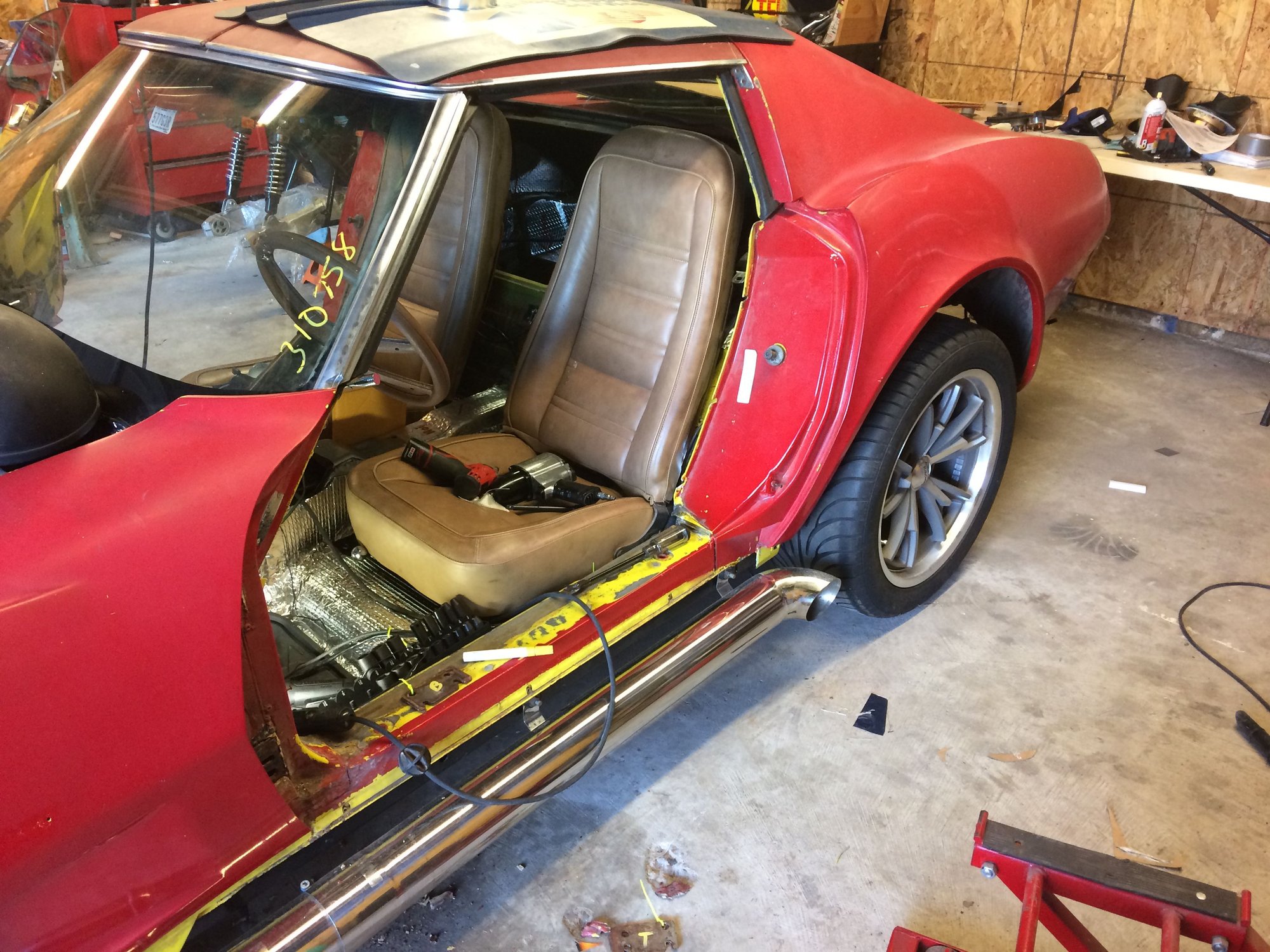

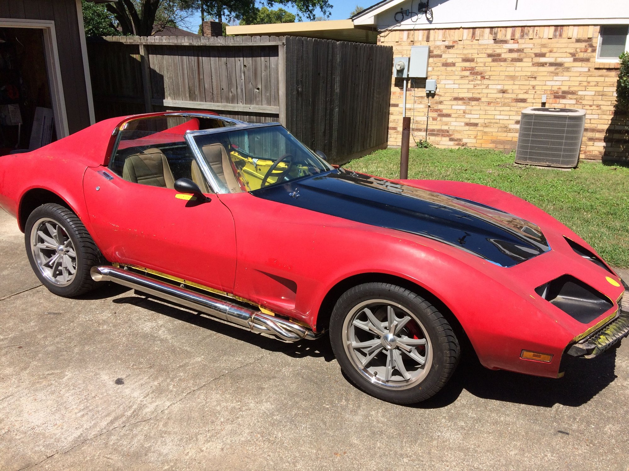

Almost four years, so good time for an update. I moved to Houston, had a kid, and been working on motorcycles instead of the Vette. Finally dusted it off over winter break. I finished up wiring the motor, got the fuel system plumbed, made custom power steering lines to fit the Lt1 and the hydroboost, installed jeep steering box, made my own sidepipe mufflers, rebuilt the hydroboost after it leaked on the first startup, installed sound deadning/reflectix, etc.
Drove it for the first time today. Feels good to have a running car. Long way to go though.
After test drive

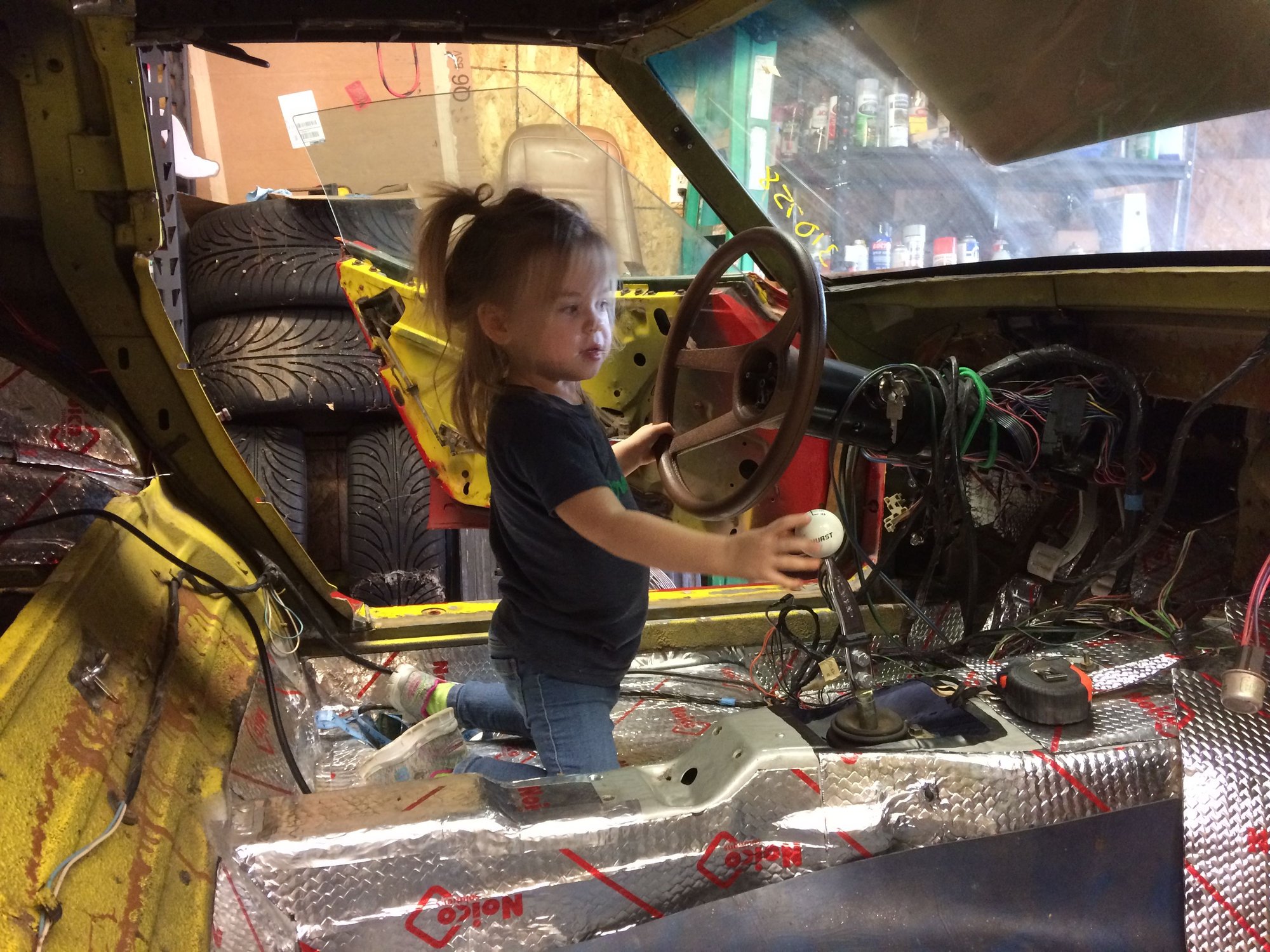

Little helper.

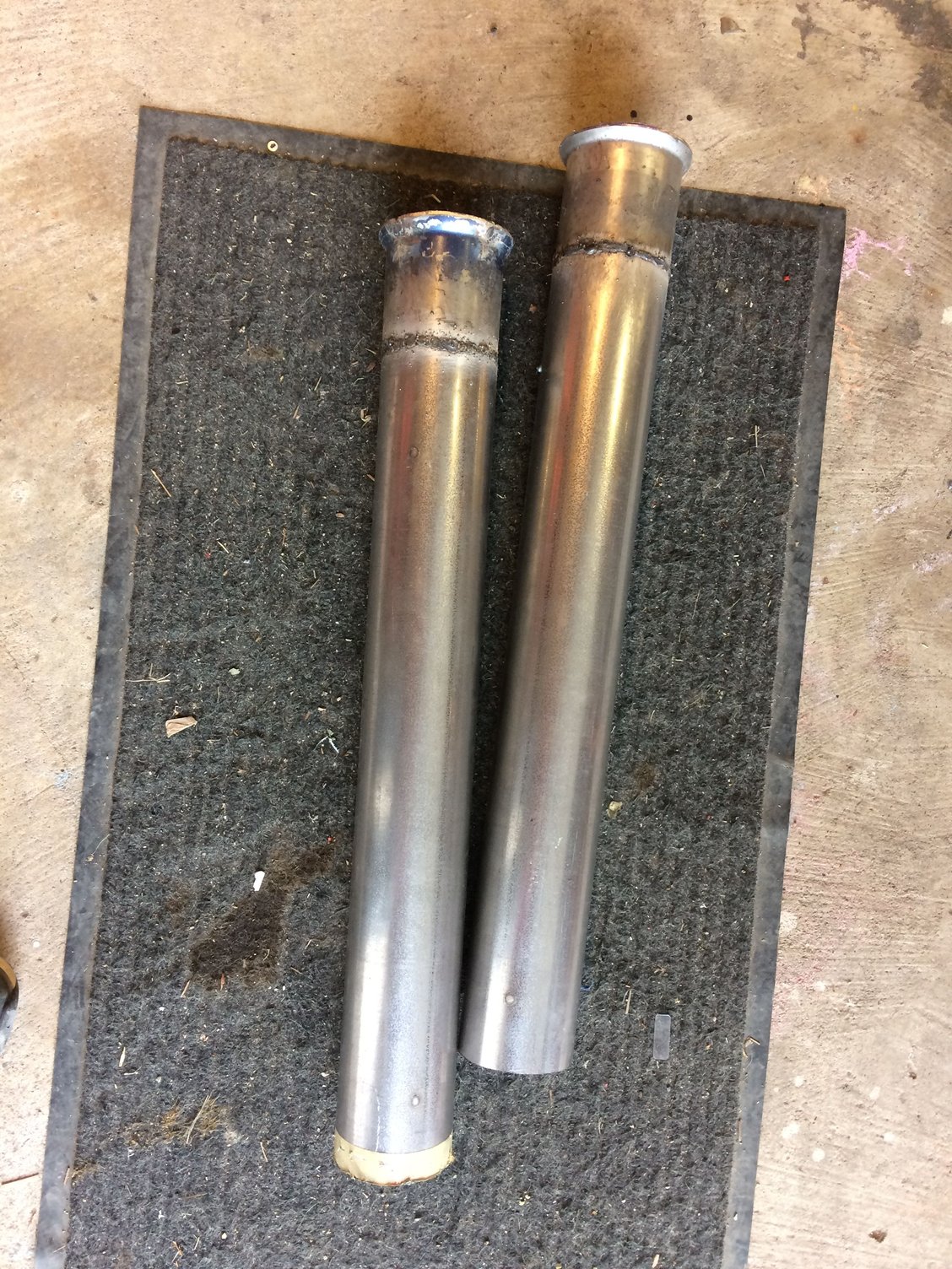

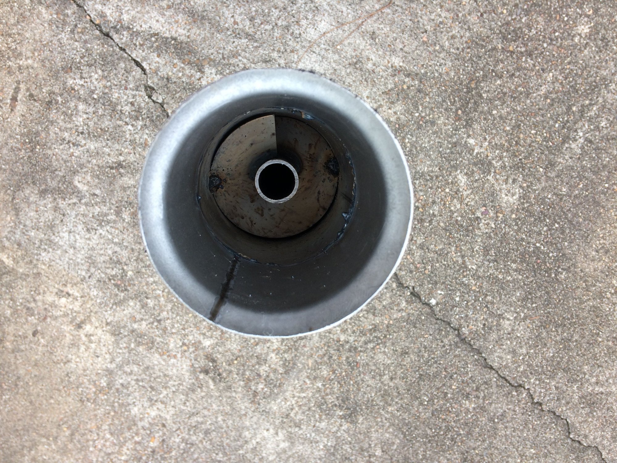

Homemade spiral sidepipe mufflers. Two speedway augers per side. I'curious how the sound compares to STS.

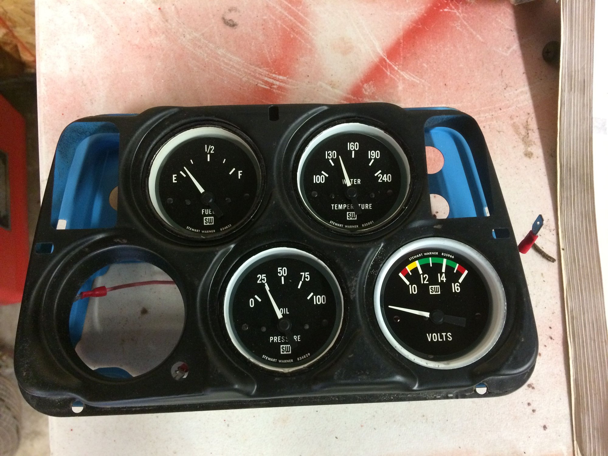

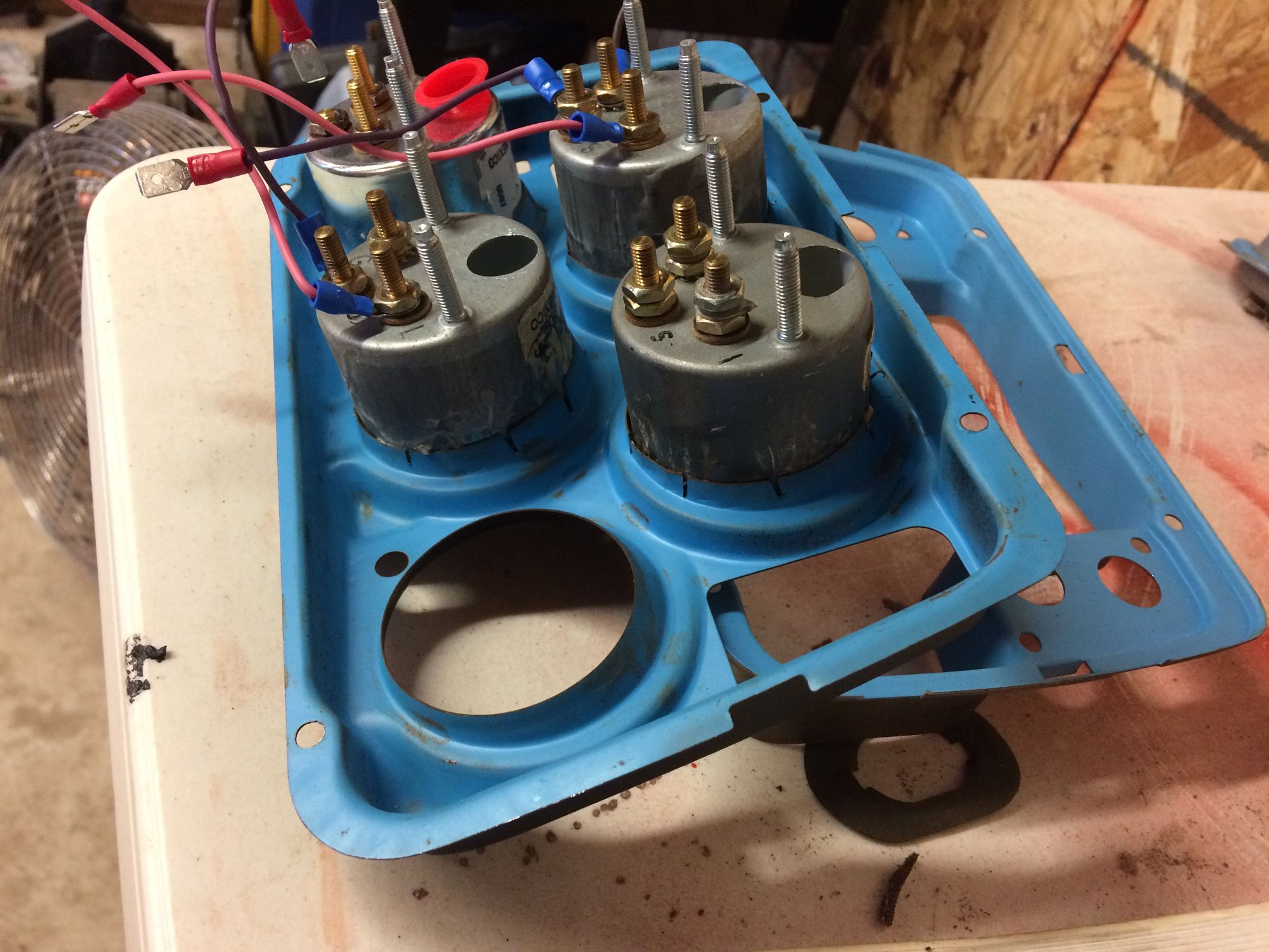

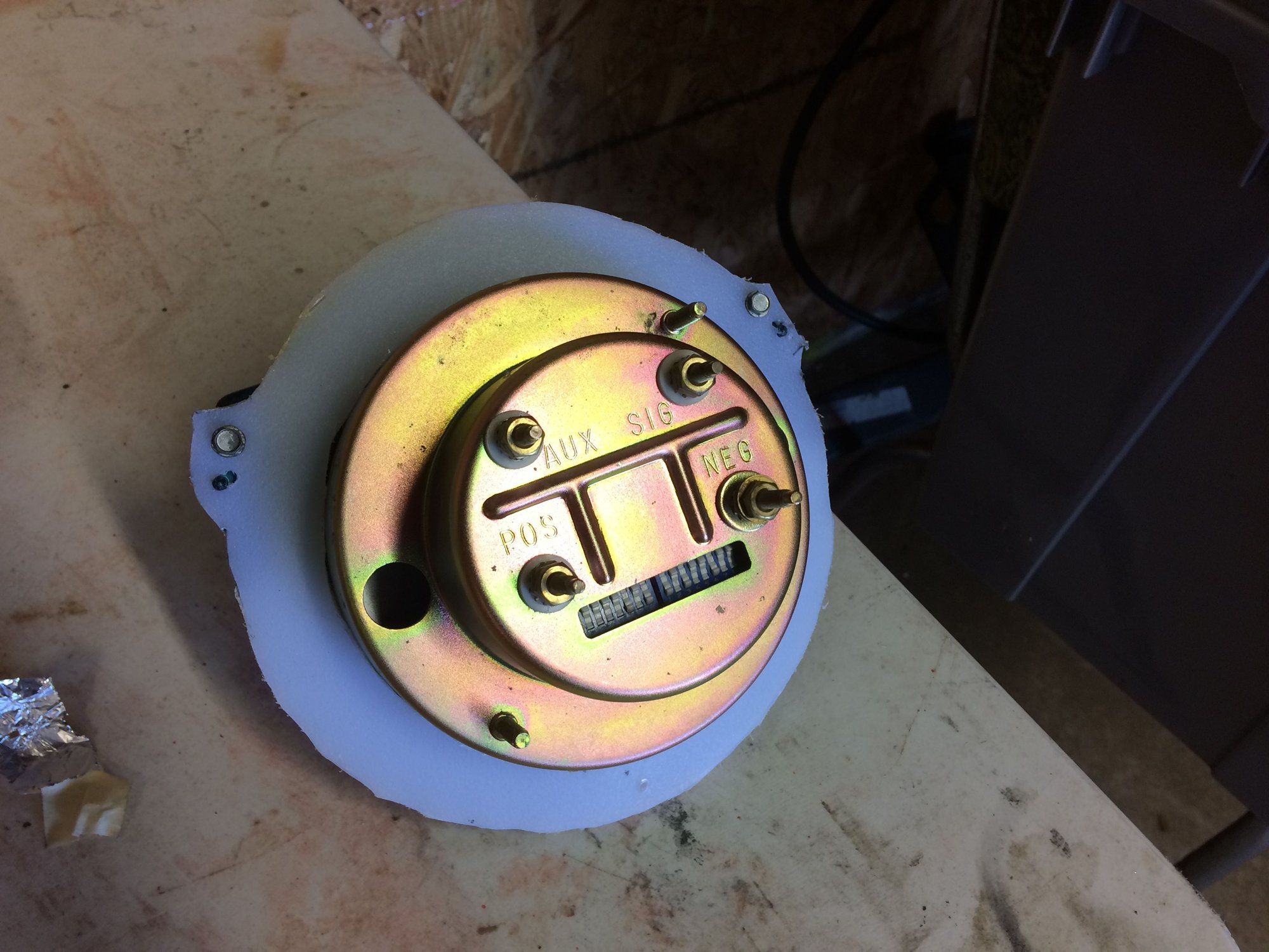

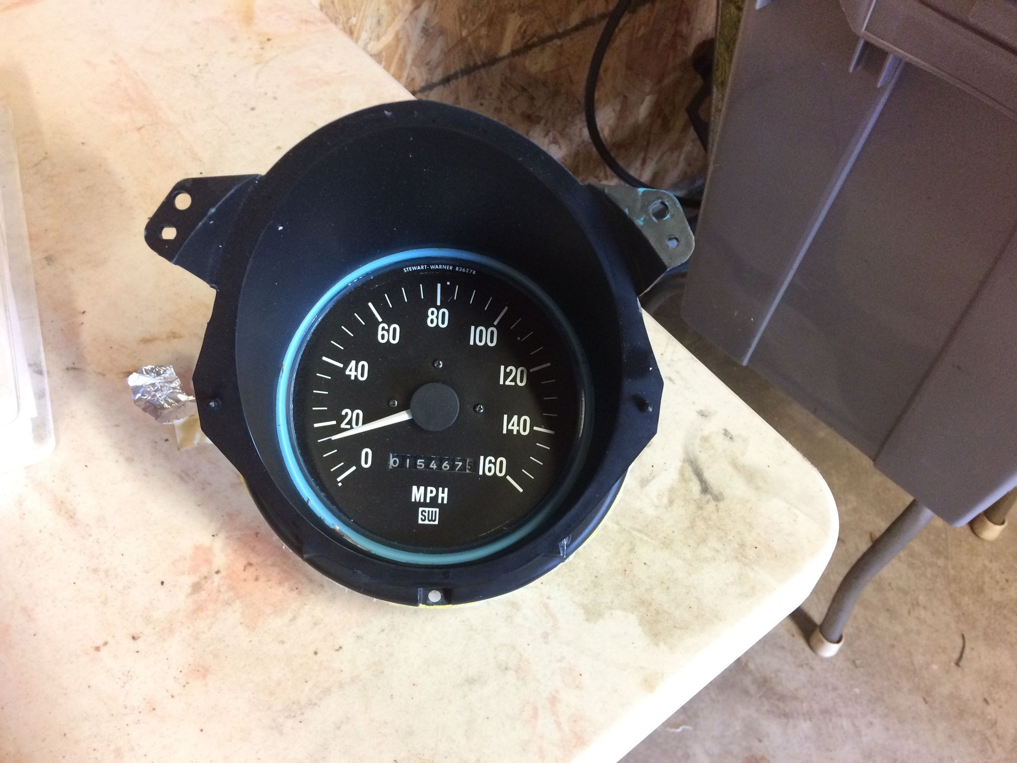

Adapting aftermarket gauges. I bought them used and the came without bezels, so they will sit behind the factory "glass".

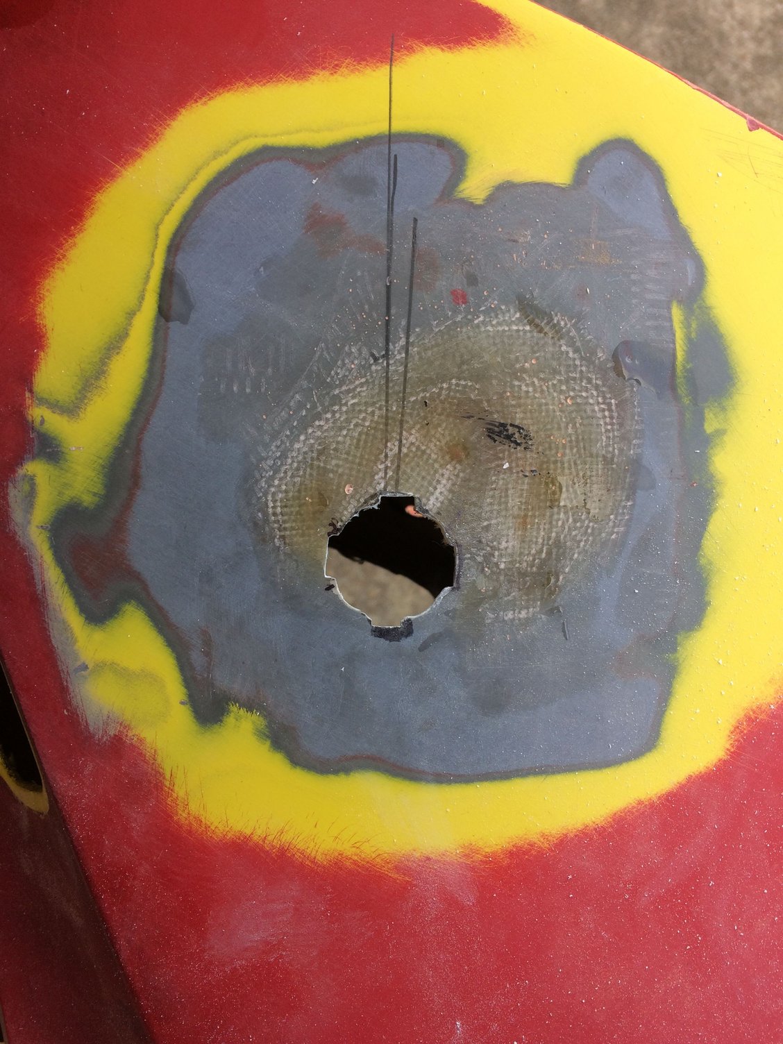

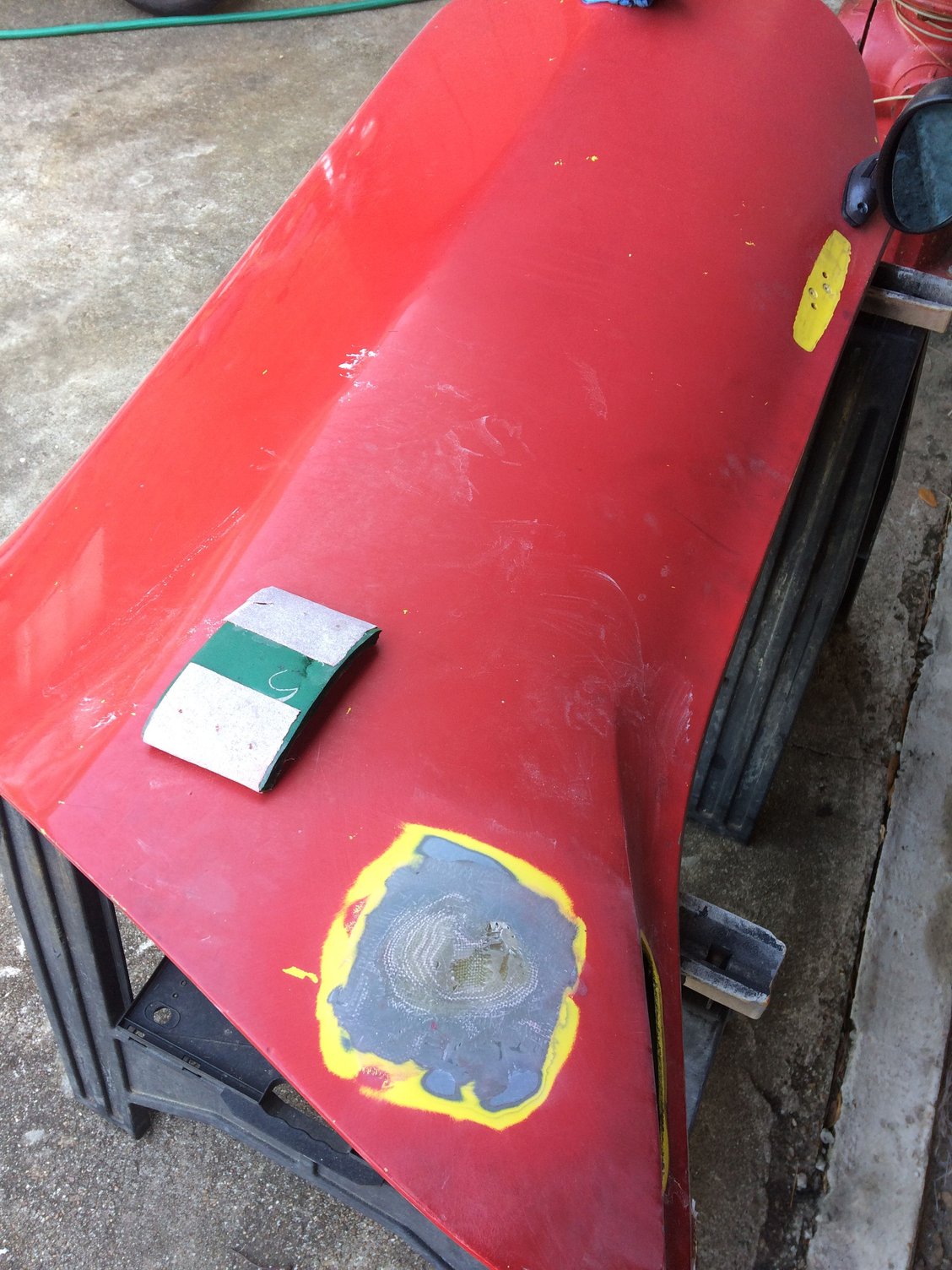

Fixing the hole left by the thieves.
