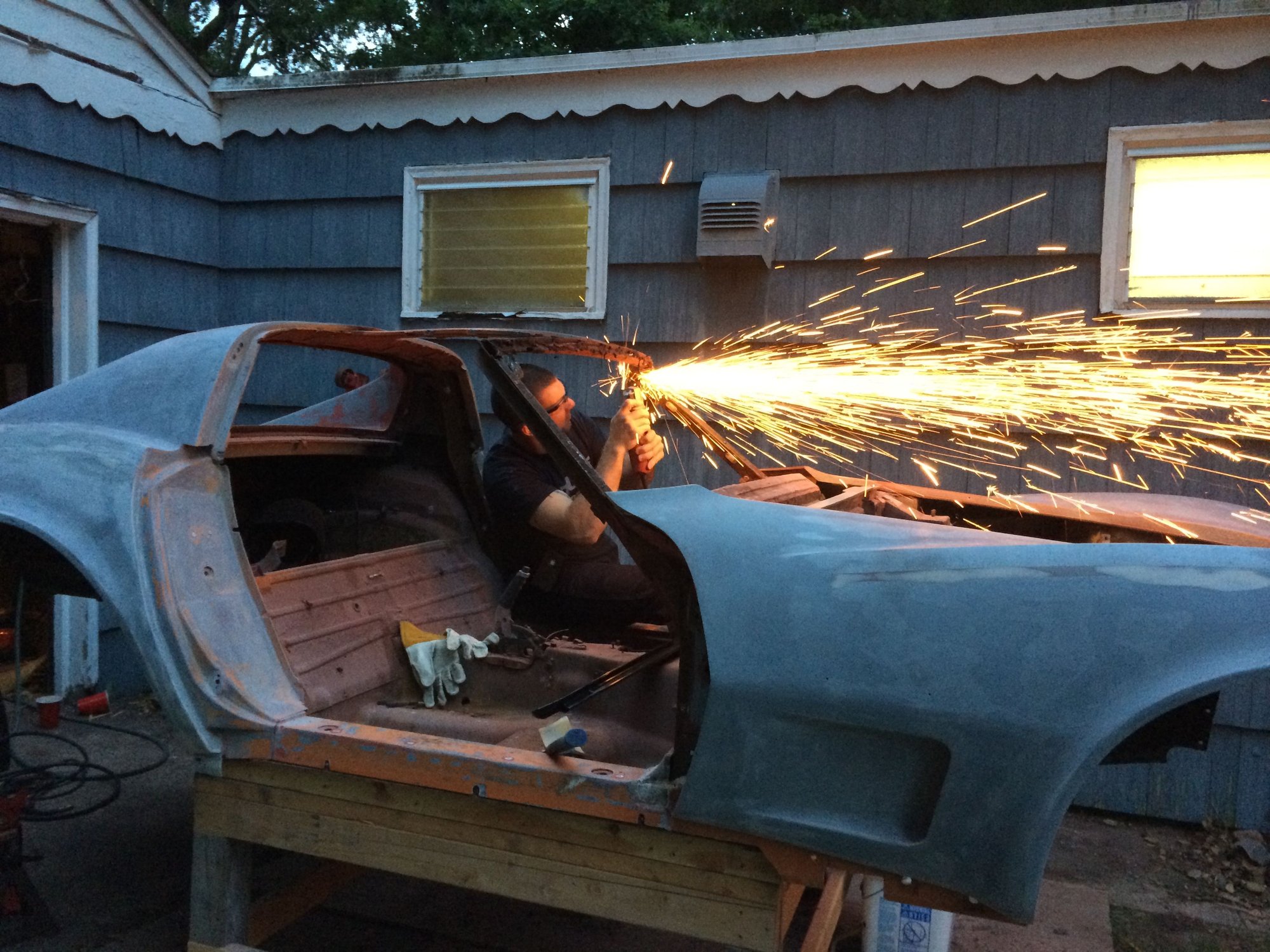

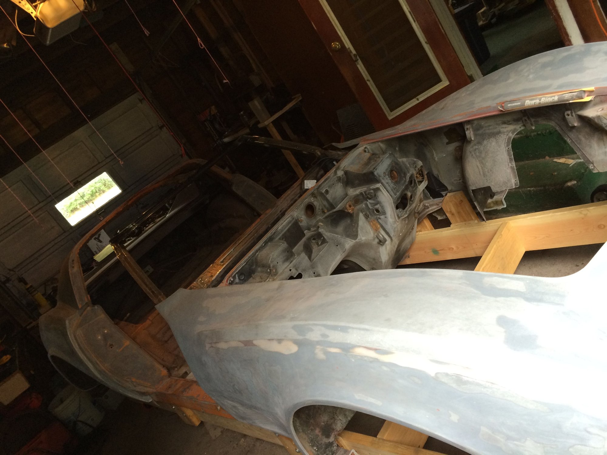

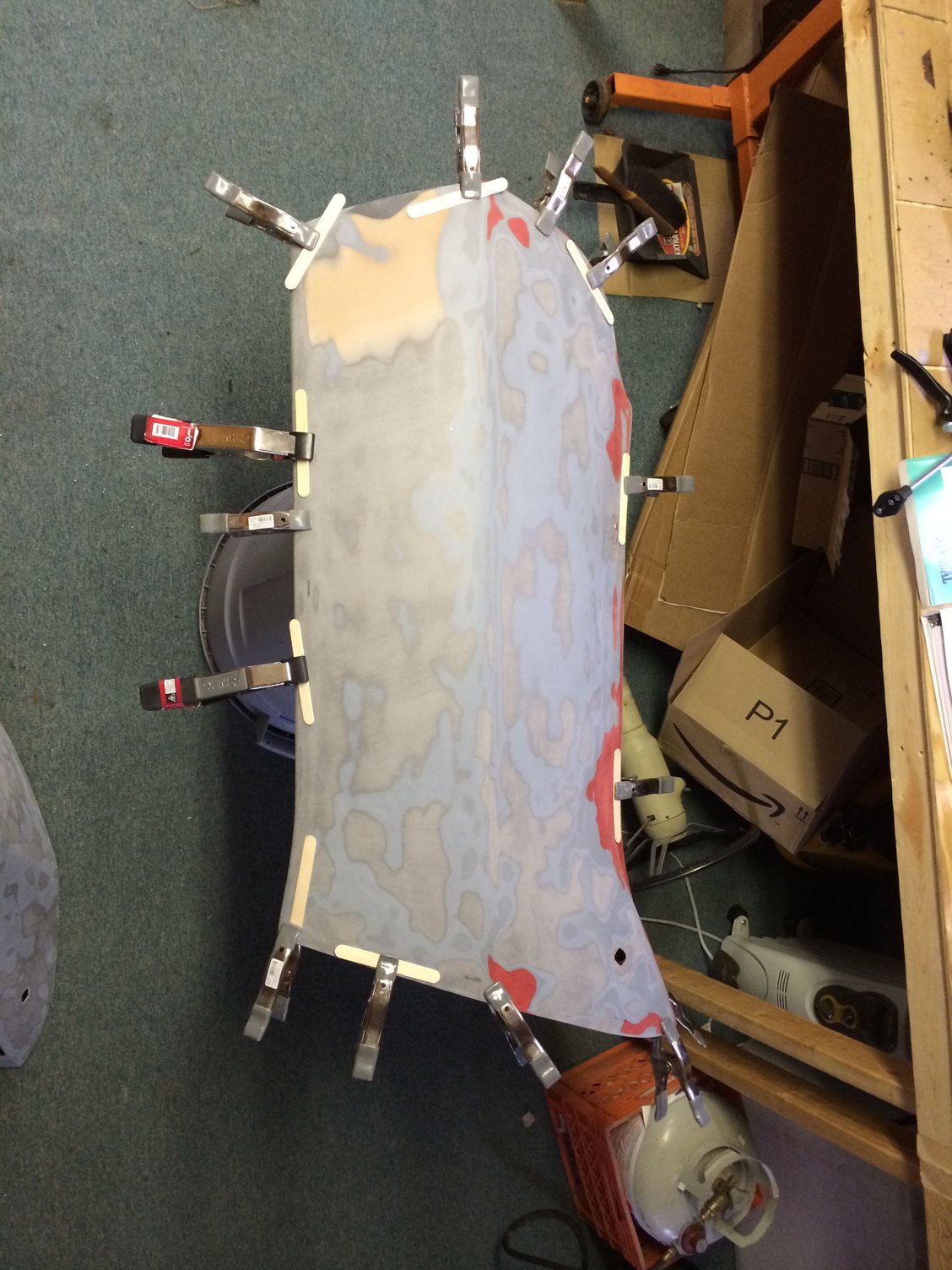

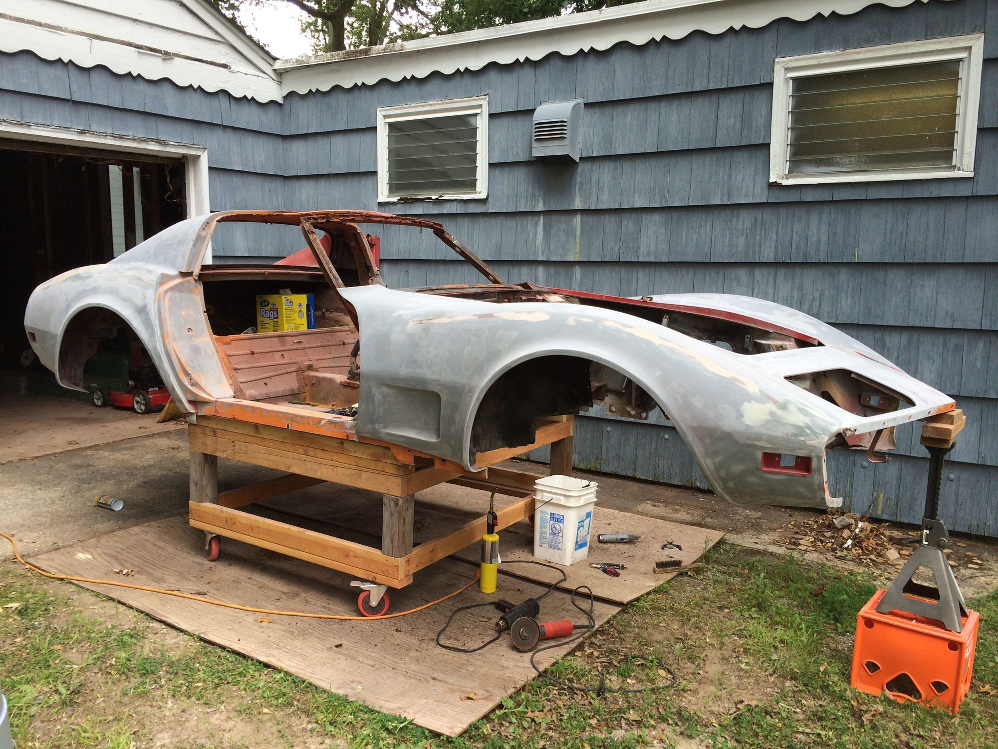

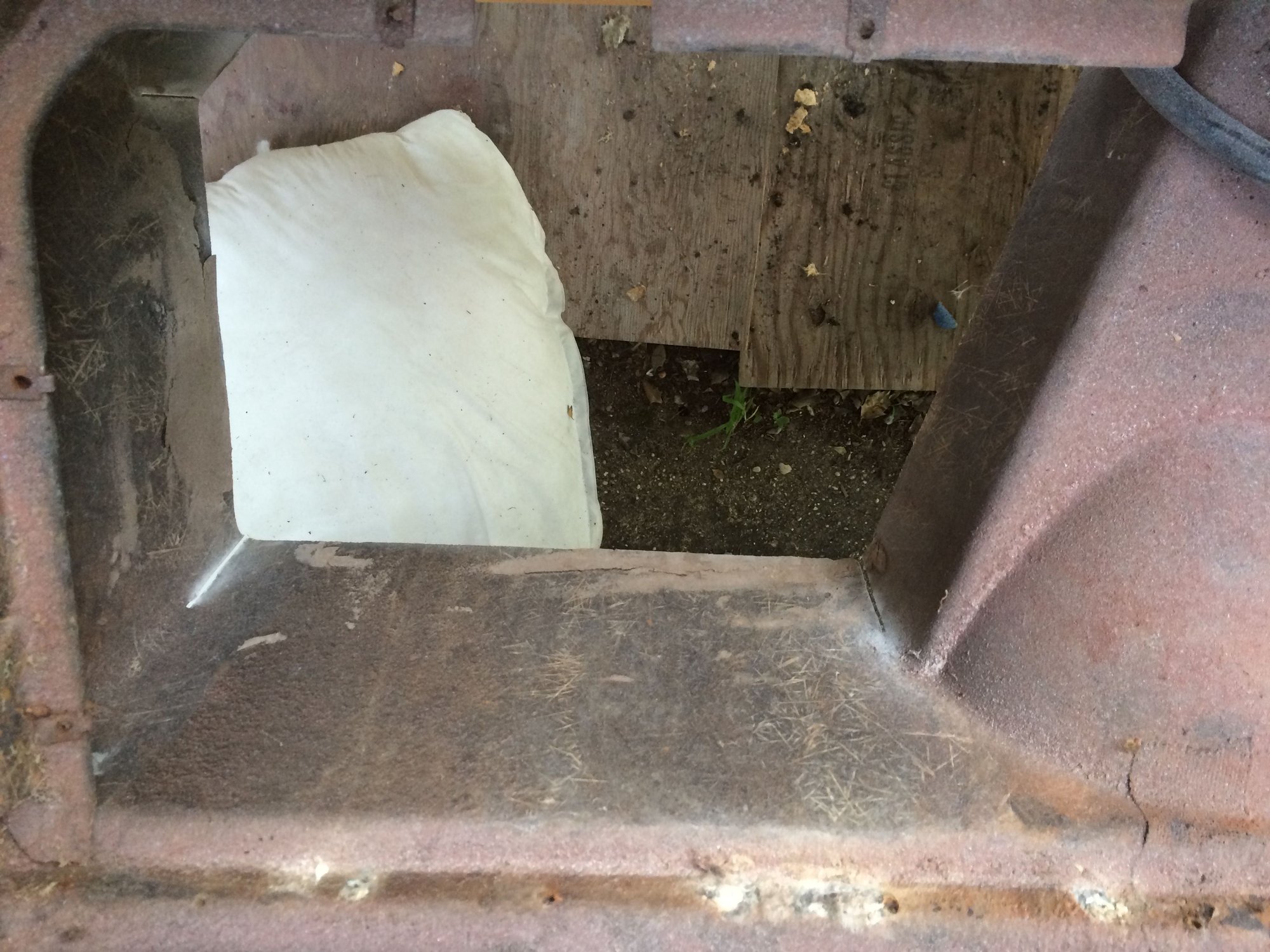

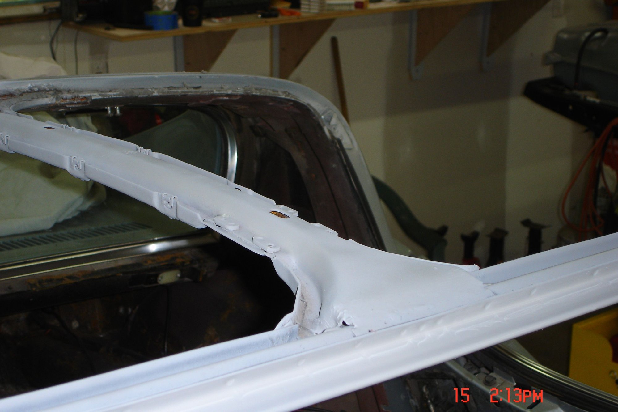

De-laminated one of the doors that was seperating.
Cleaned up the firewall

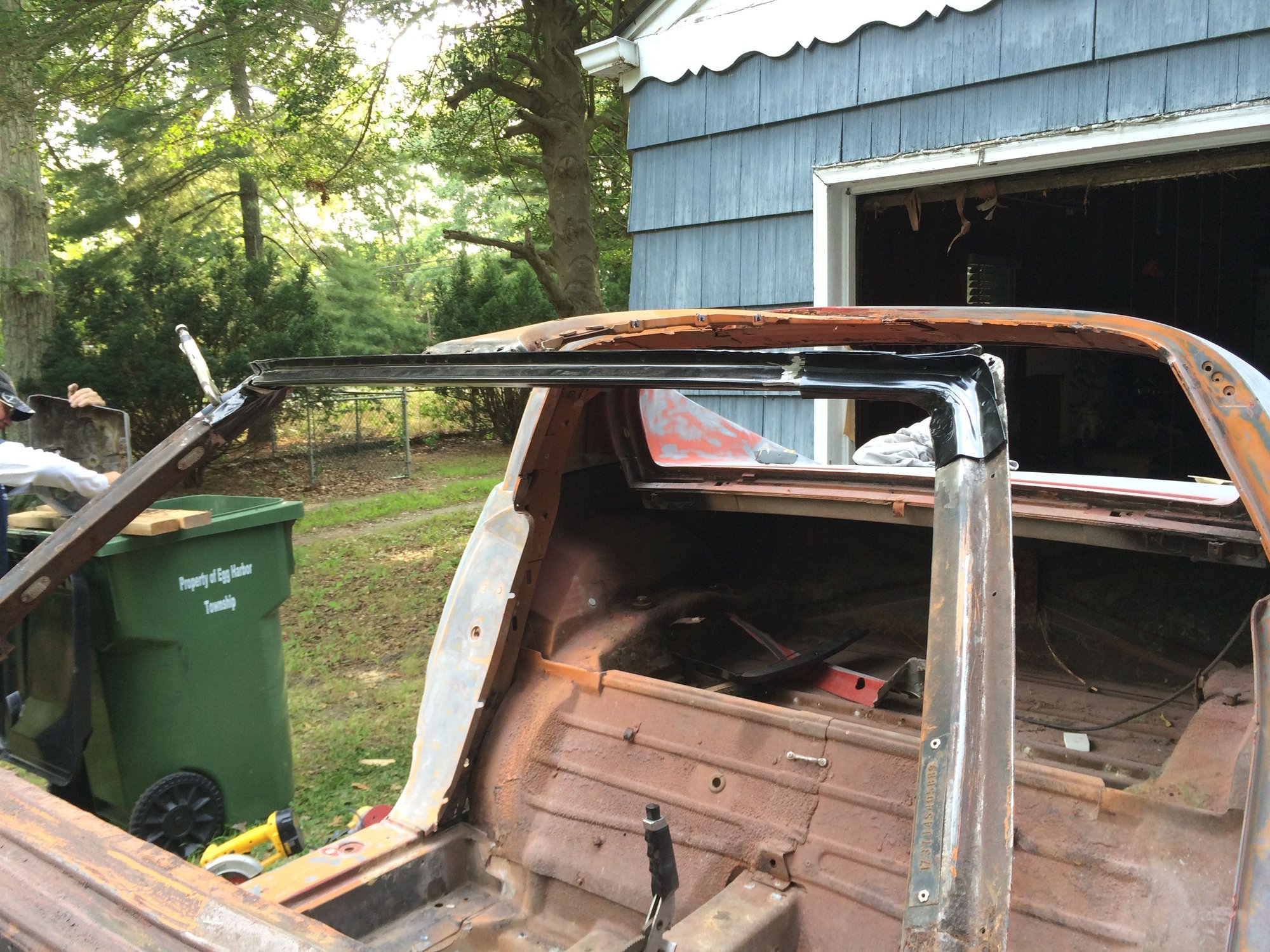

Replacing windshield upper frame

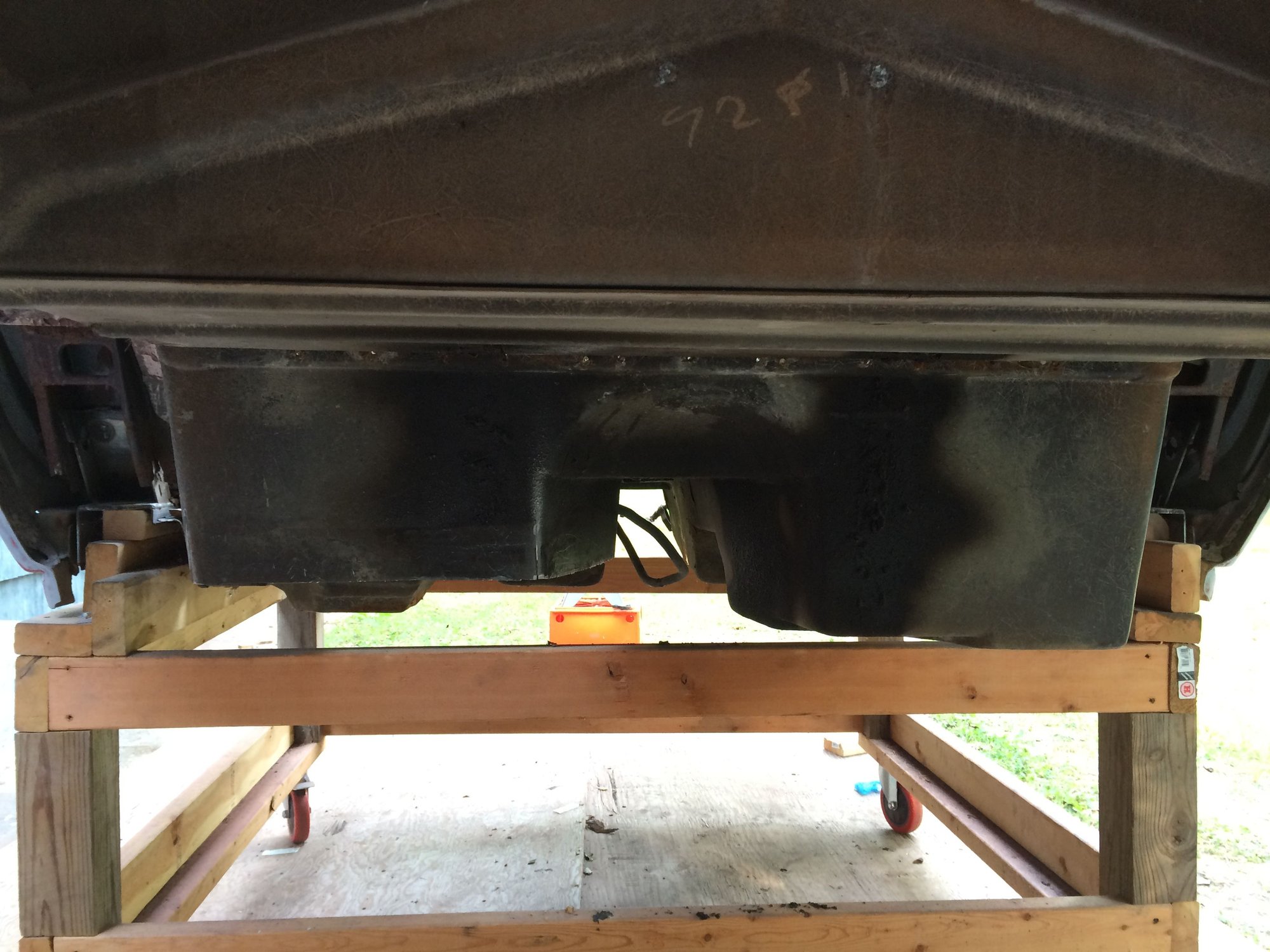

Replaced the bottom of the battery box.
Battery box.
Bonding the door skin.

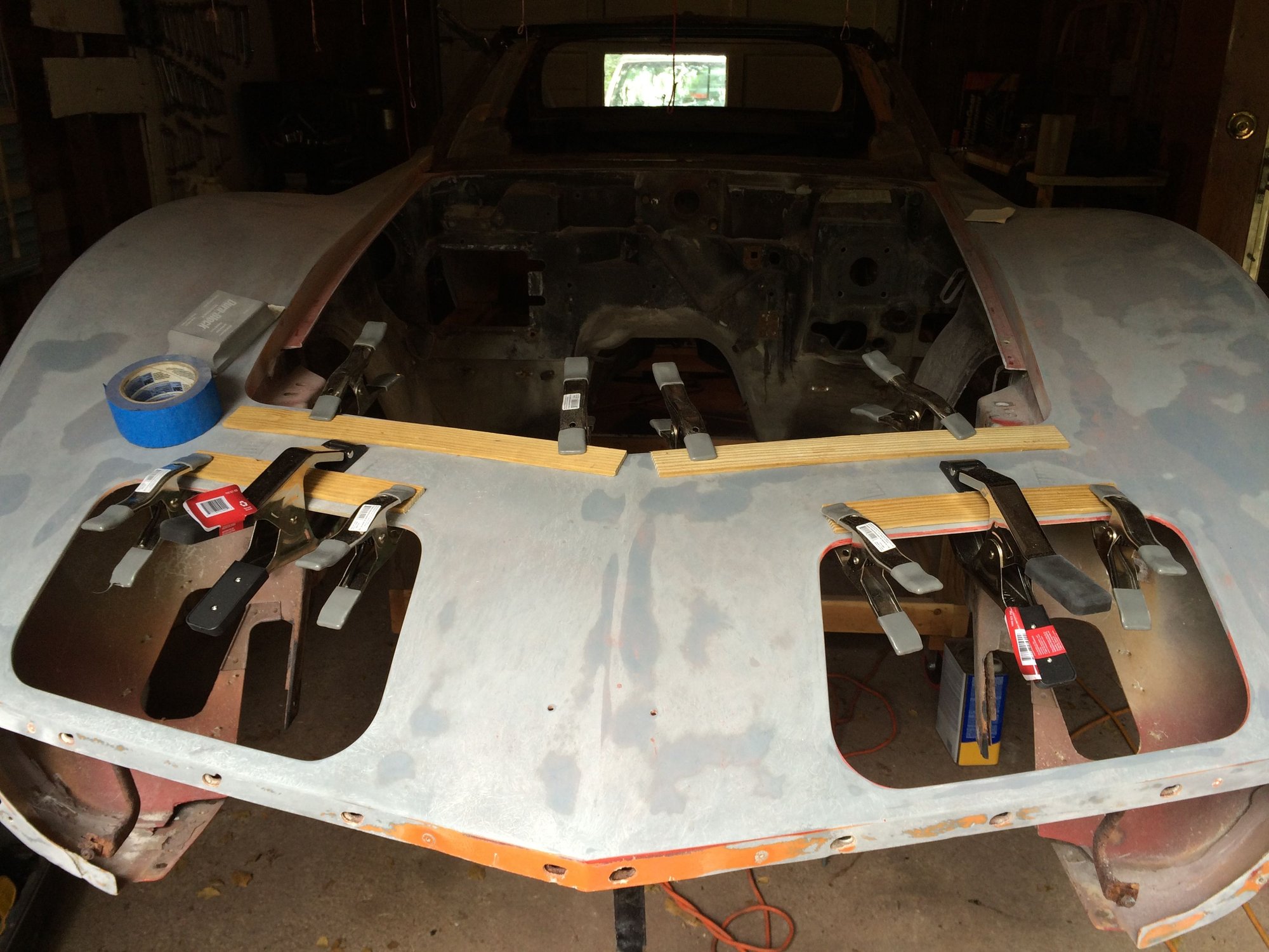

Bonding the headlight header

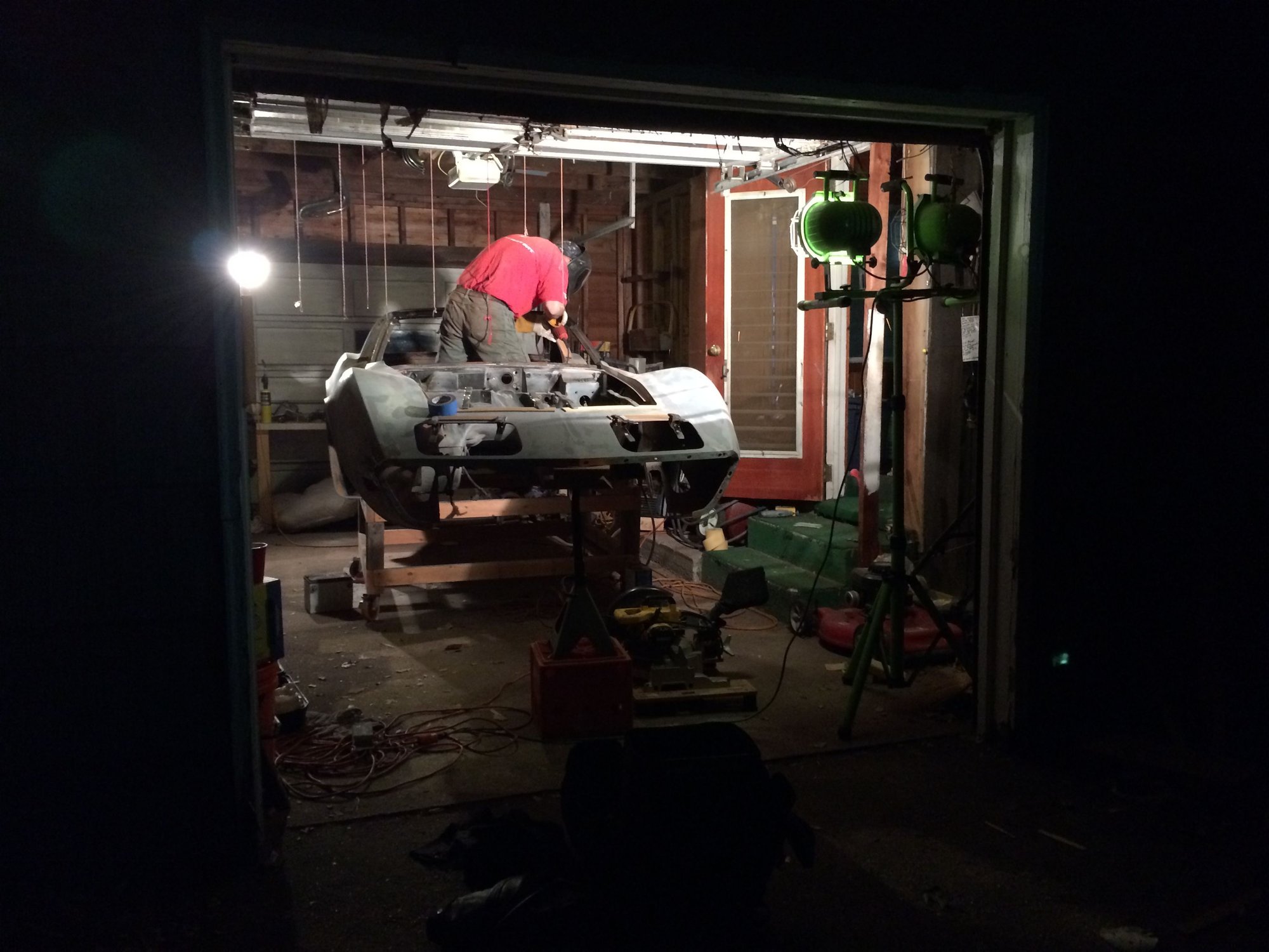

Late night welding

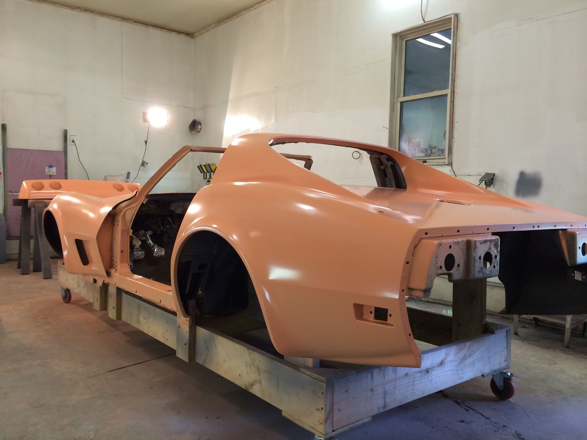

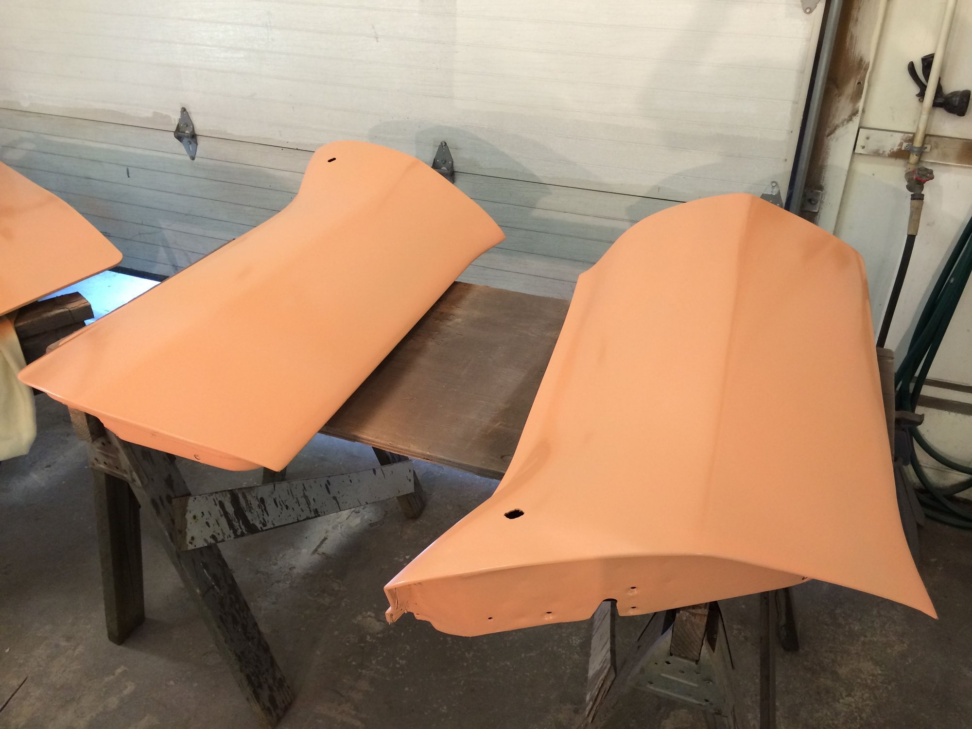

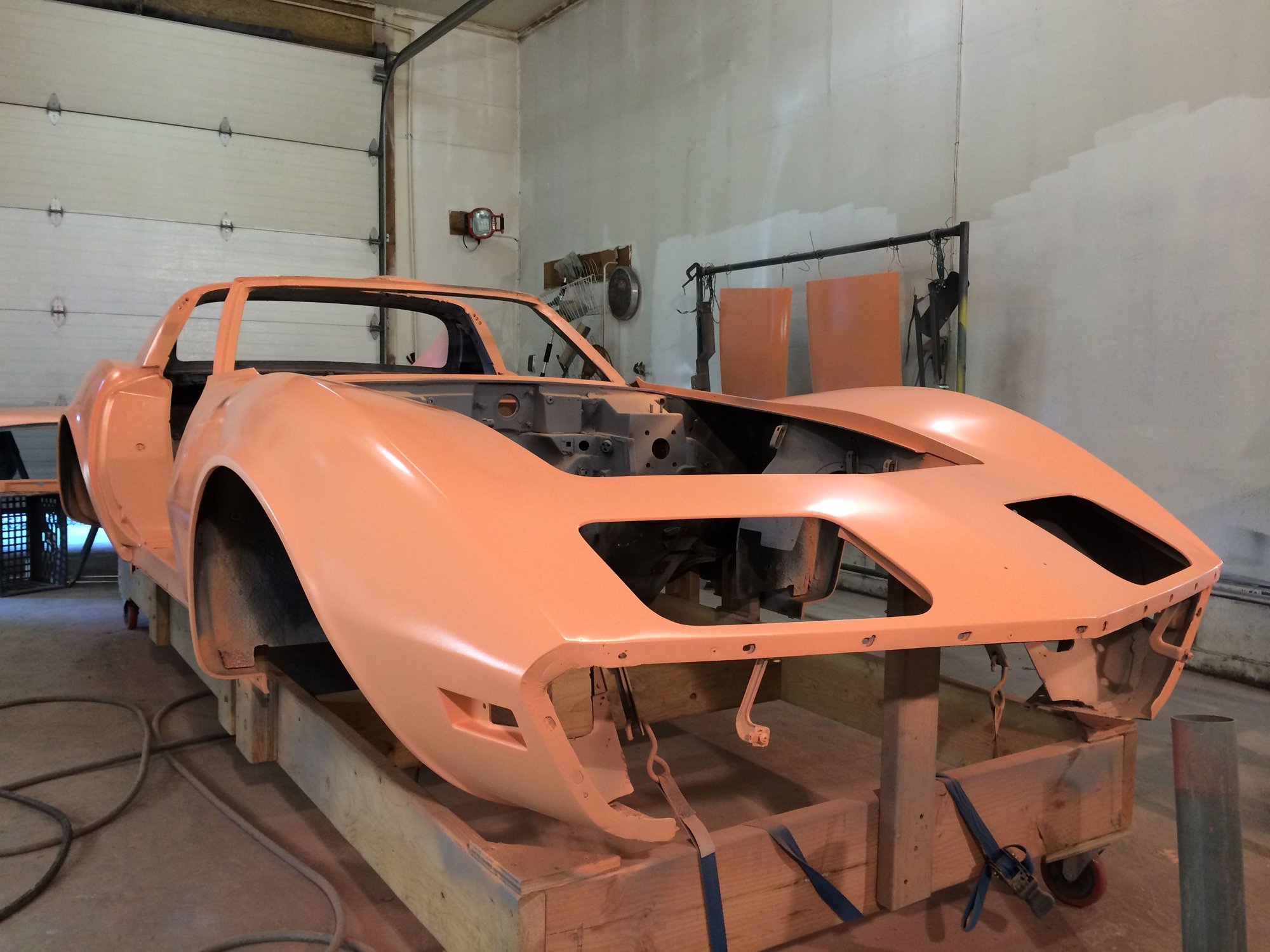

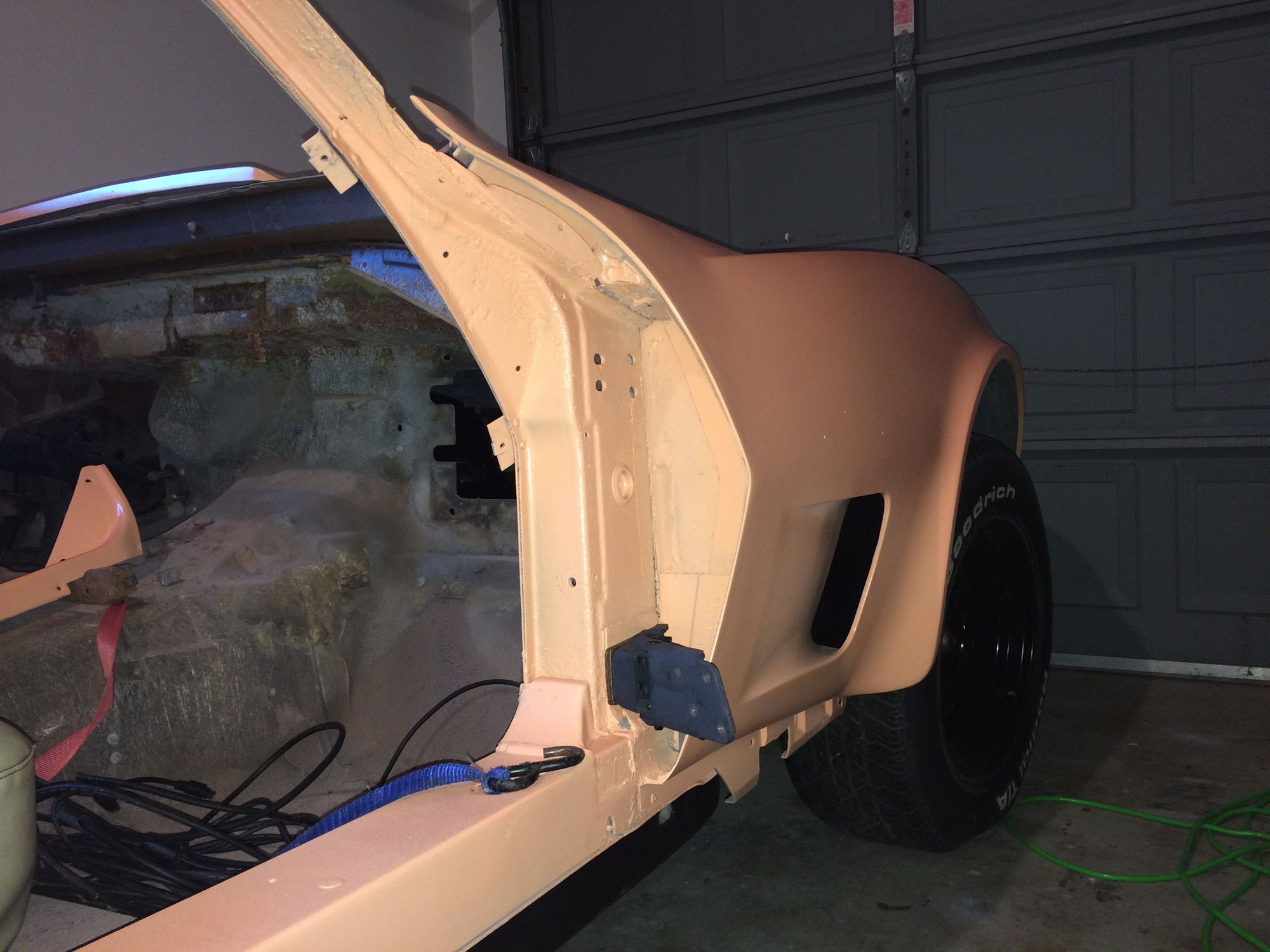

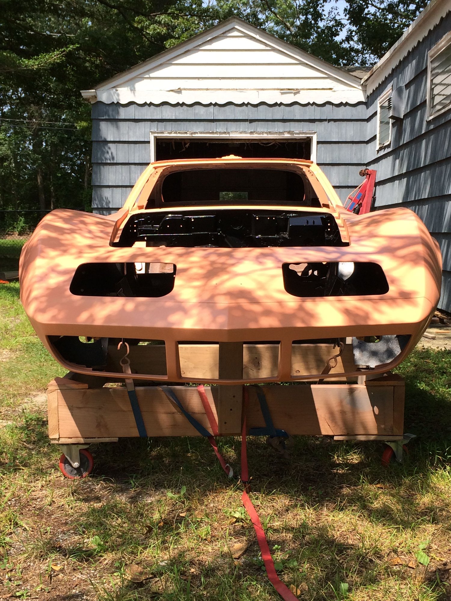

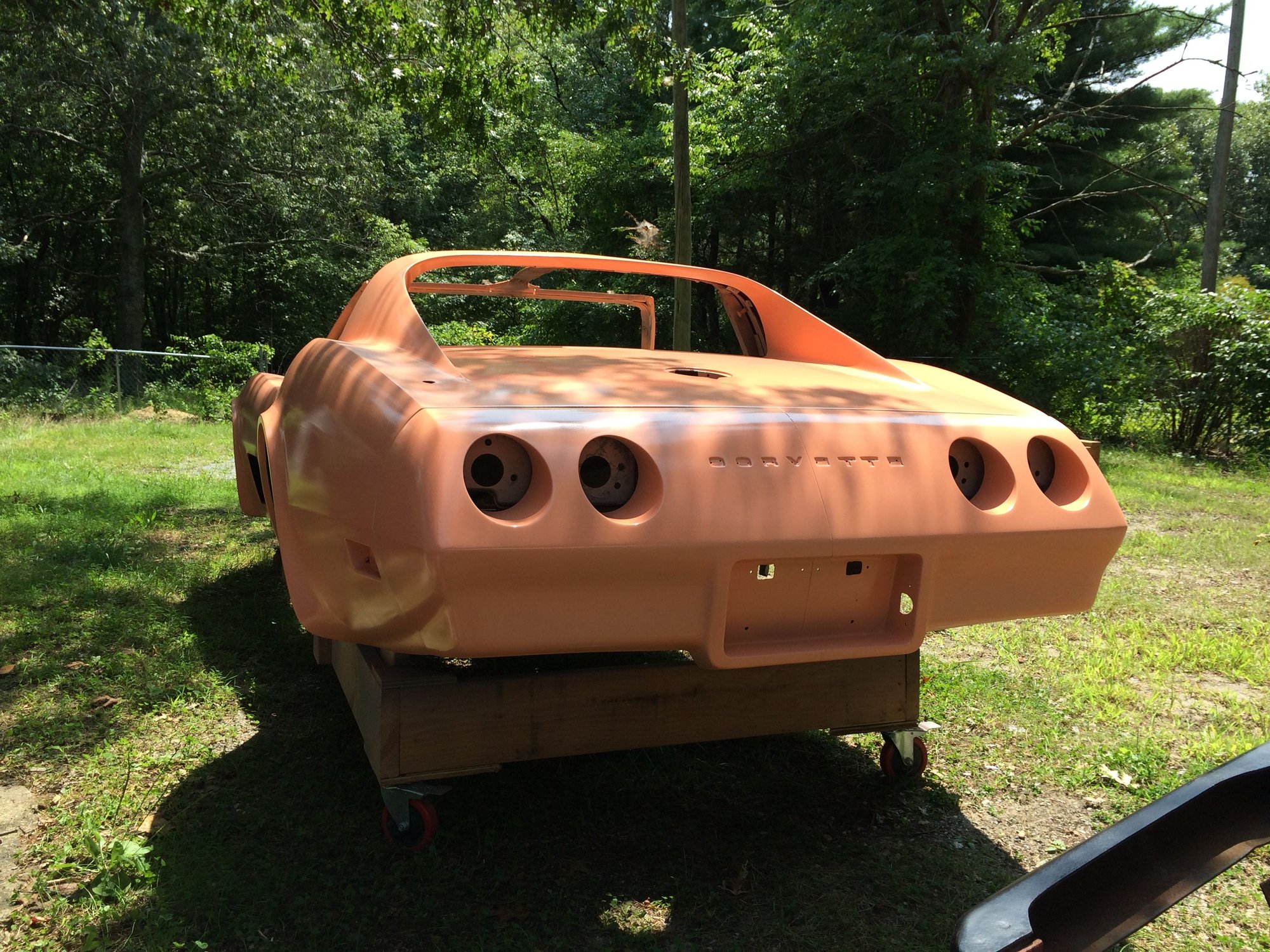

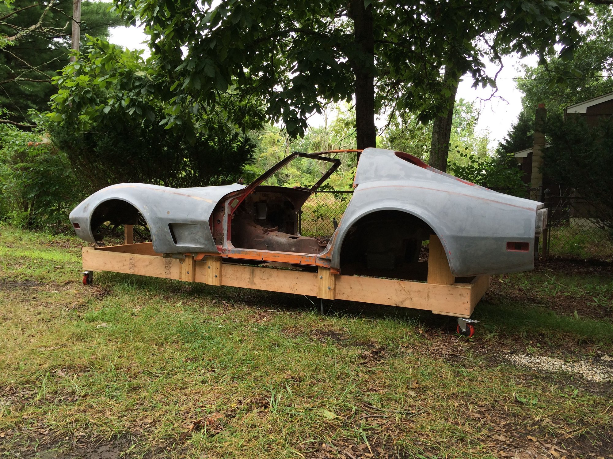

Picking the body up from getting primed and sealed tomorrow. Sealer has a little orange tint in it to give the paint a deeper base.

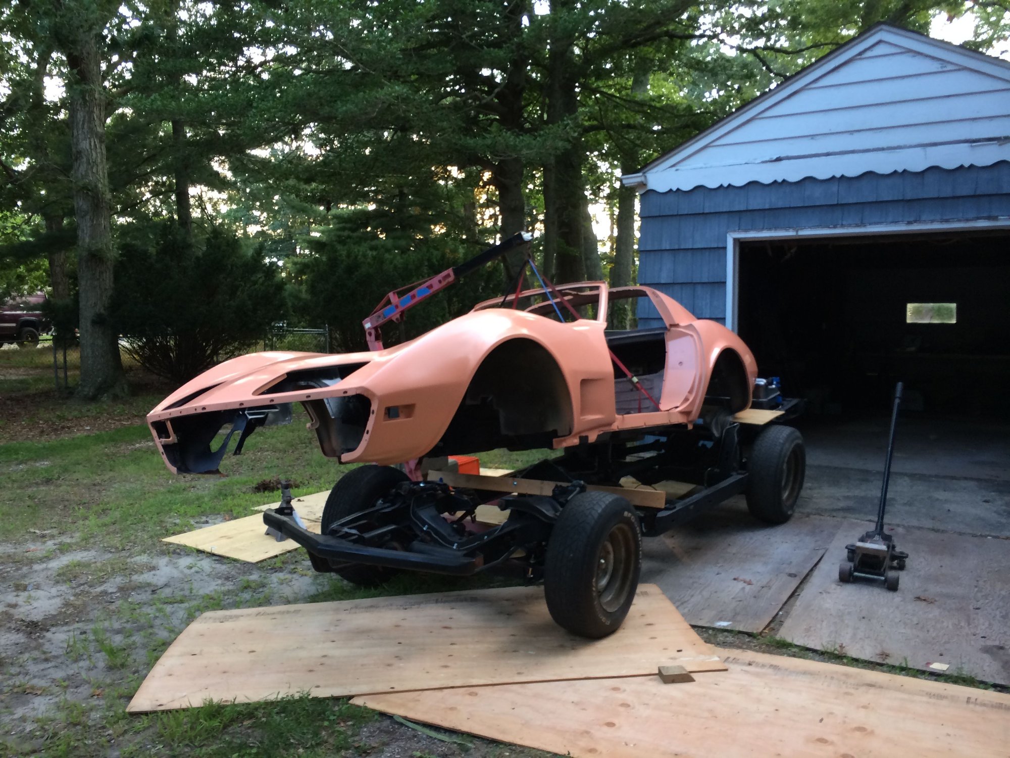

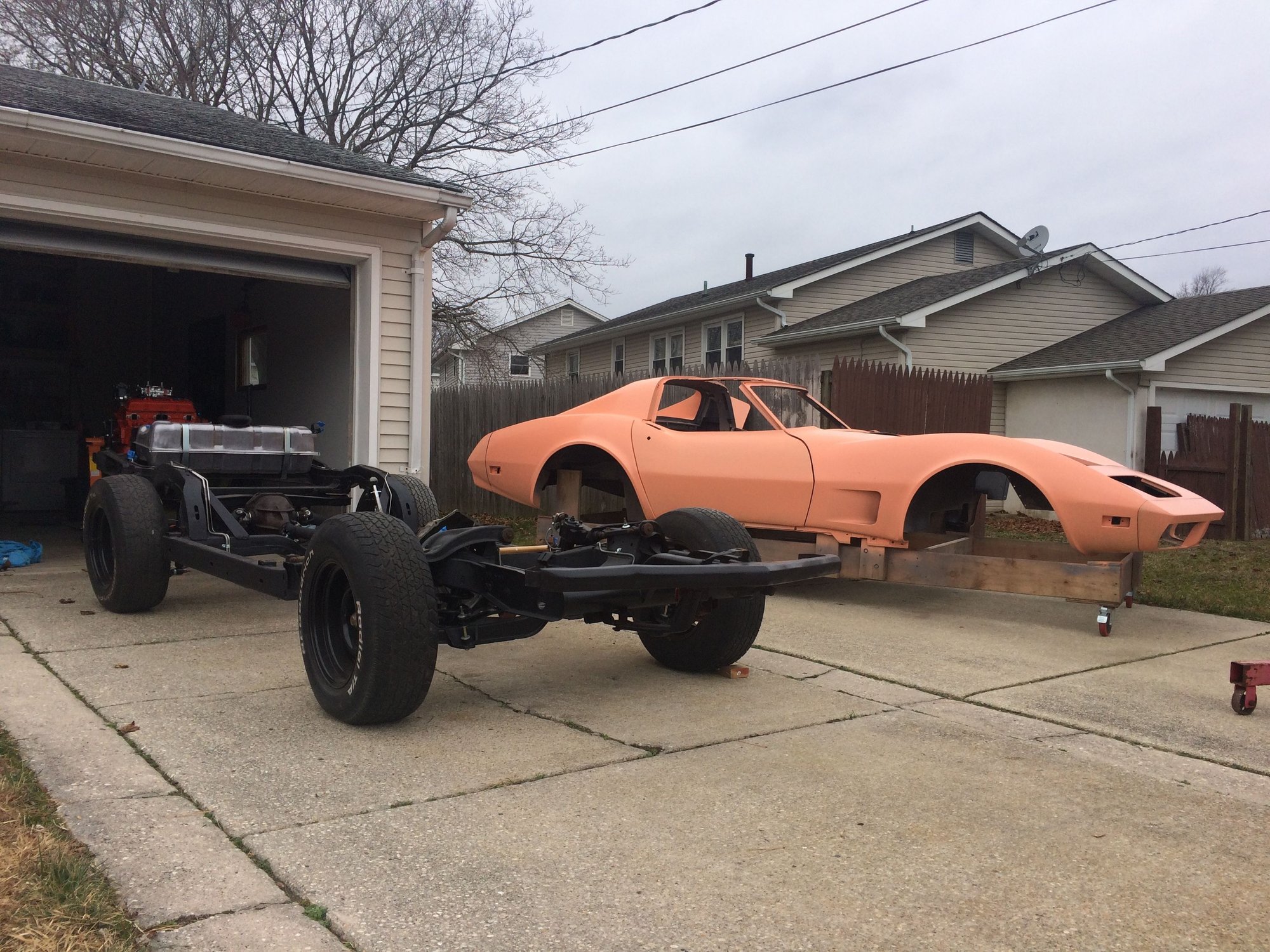

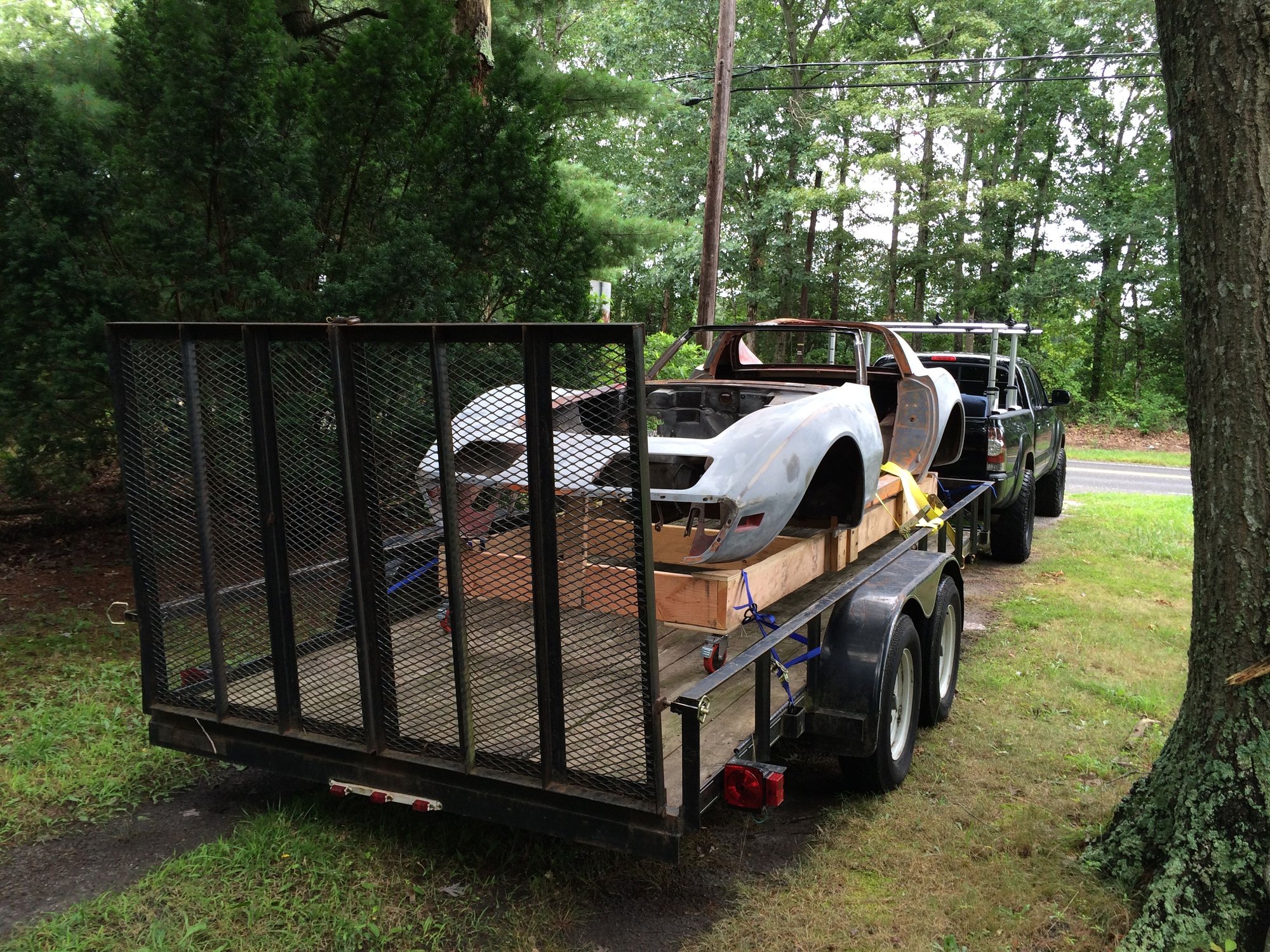

Got it home. Prepping to get it back on the chassis. Not sure I thought I would ever get there.

Feels like a major milestone. About a week away from two years since I pulled the body off the chassis. I wasn't sure I'd ever get it back on. Still a lot to do but it seems like serious
progress.

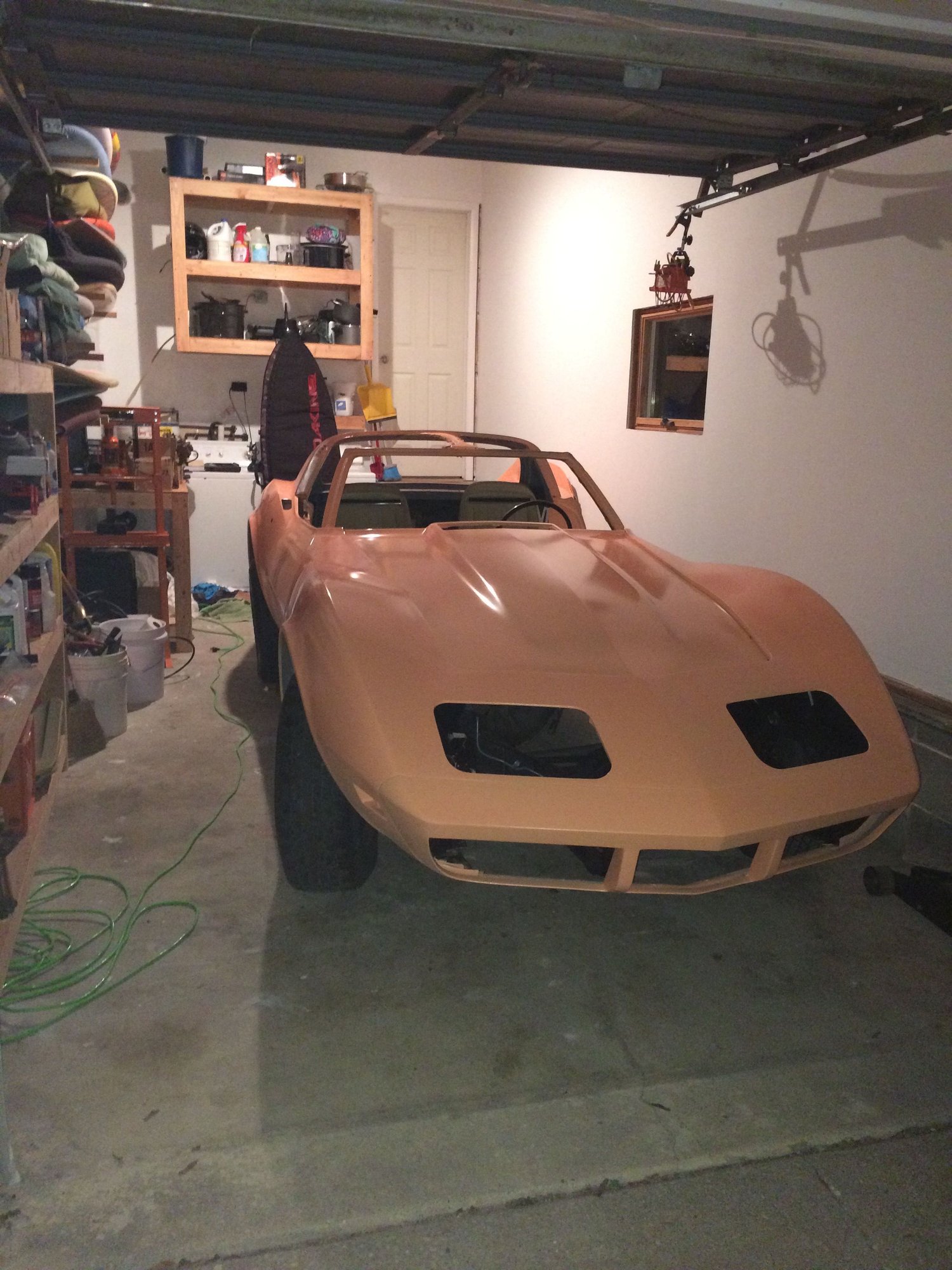

Bolted down the body and hung the passenger door to begin shimming the body.

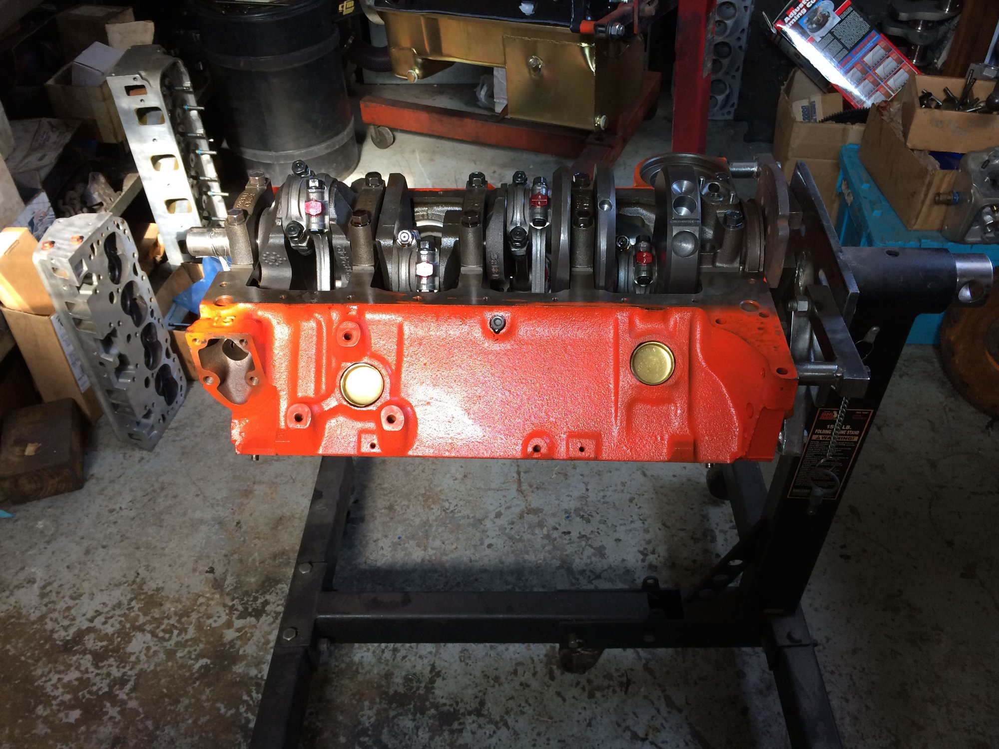

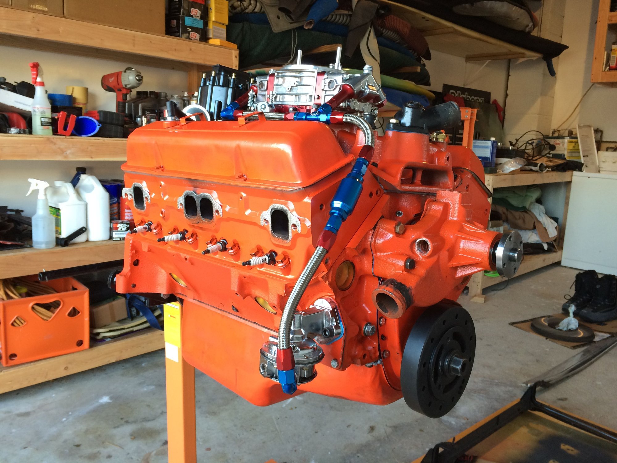

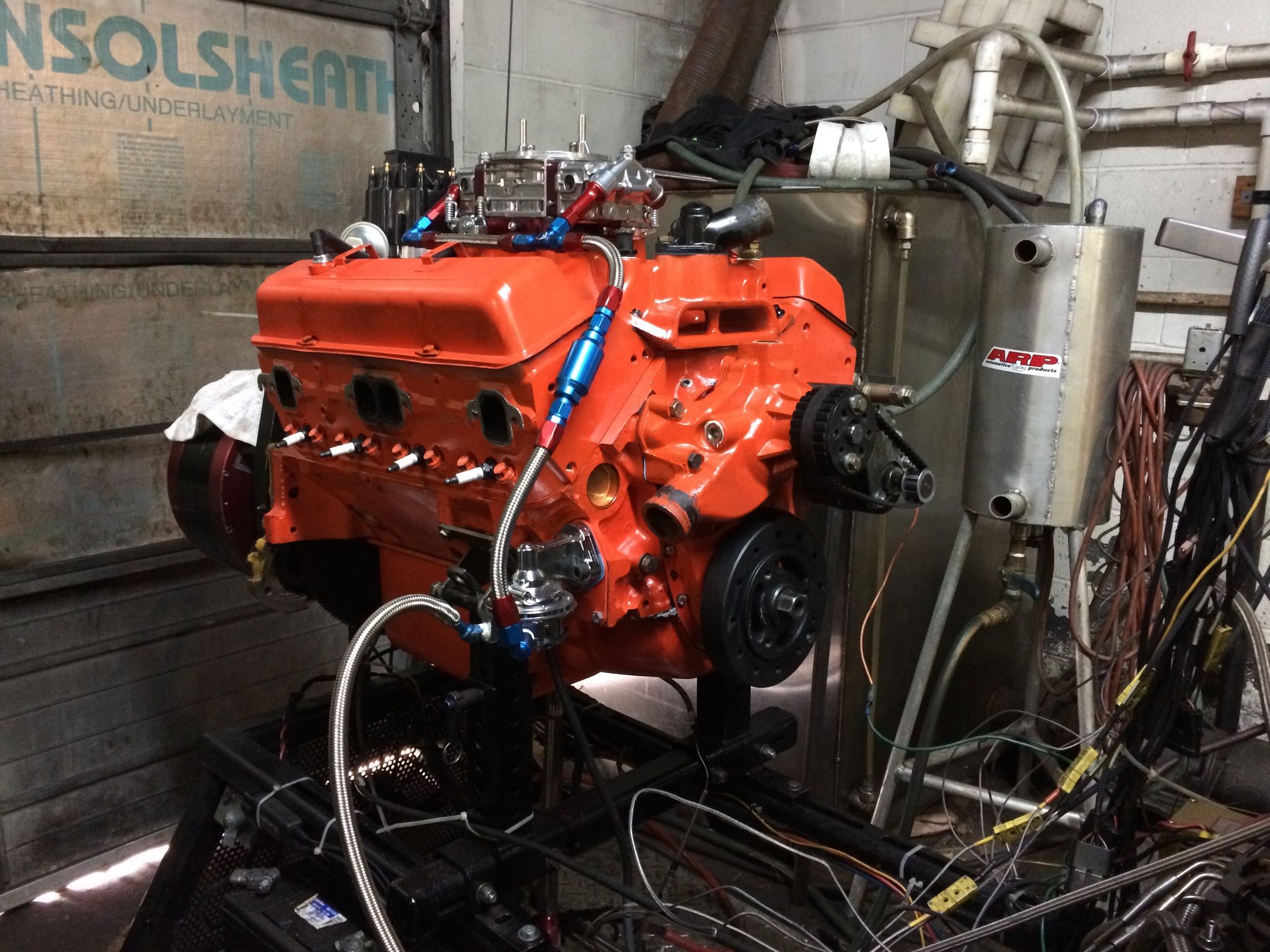

I get my motor back on Thursday. Peaked at 469.3 on the engine dyno.

Motor looks good Jeff.
What cubic inches did you wind up with?

@LS4 Pilot I stayed with the original motor and crank. It was bored but I don't know how much until I pick it up.
