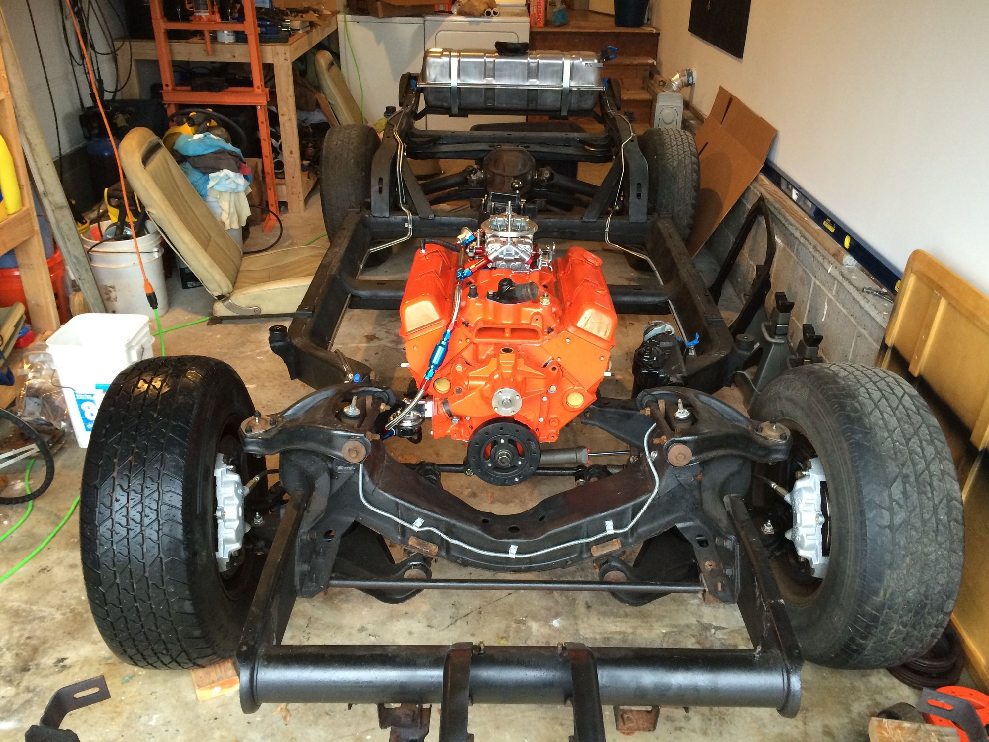

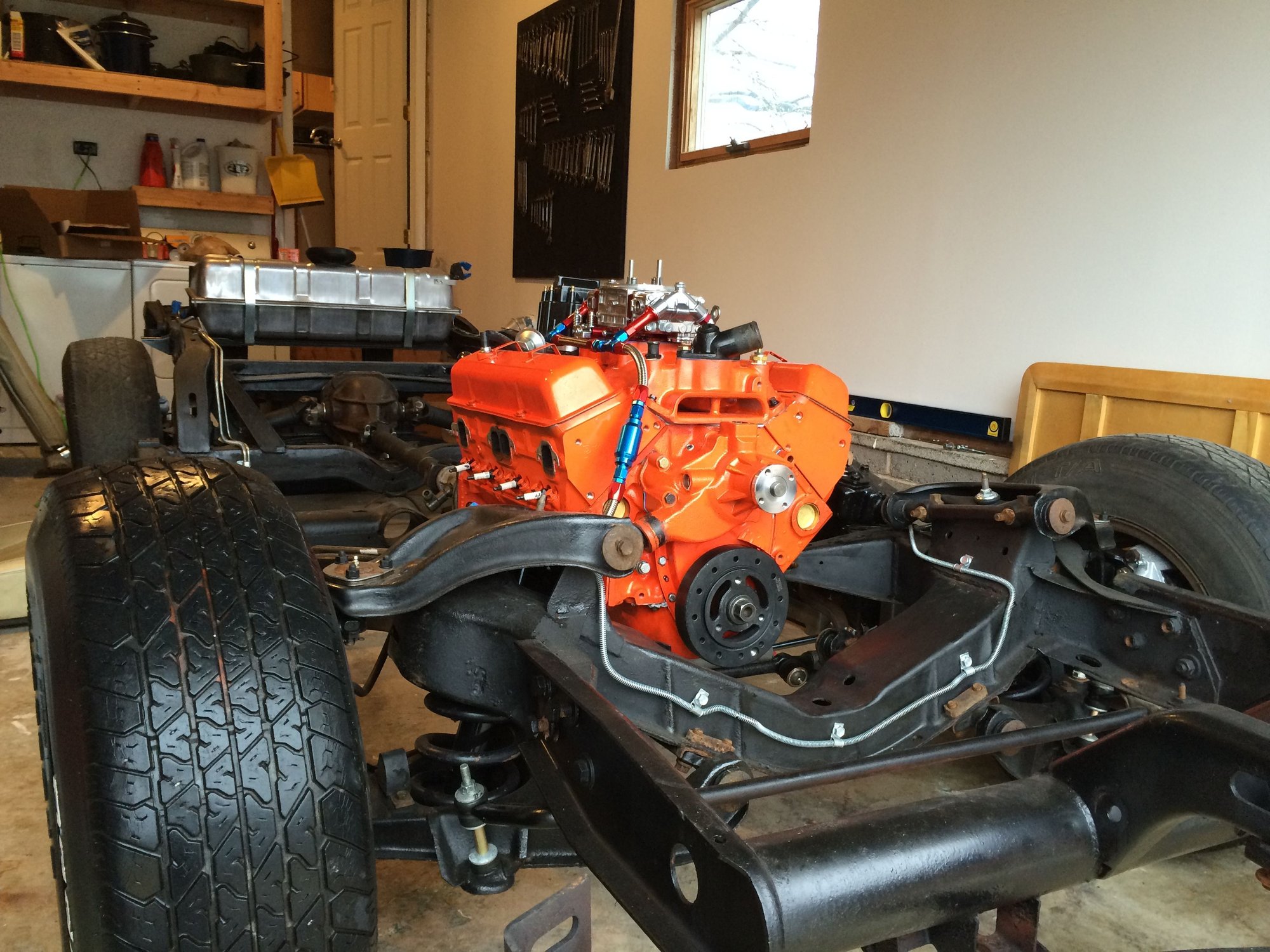

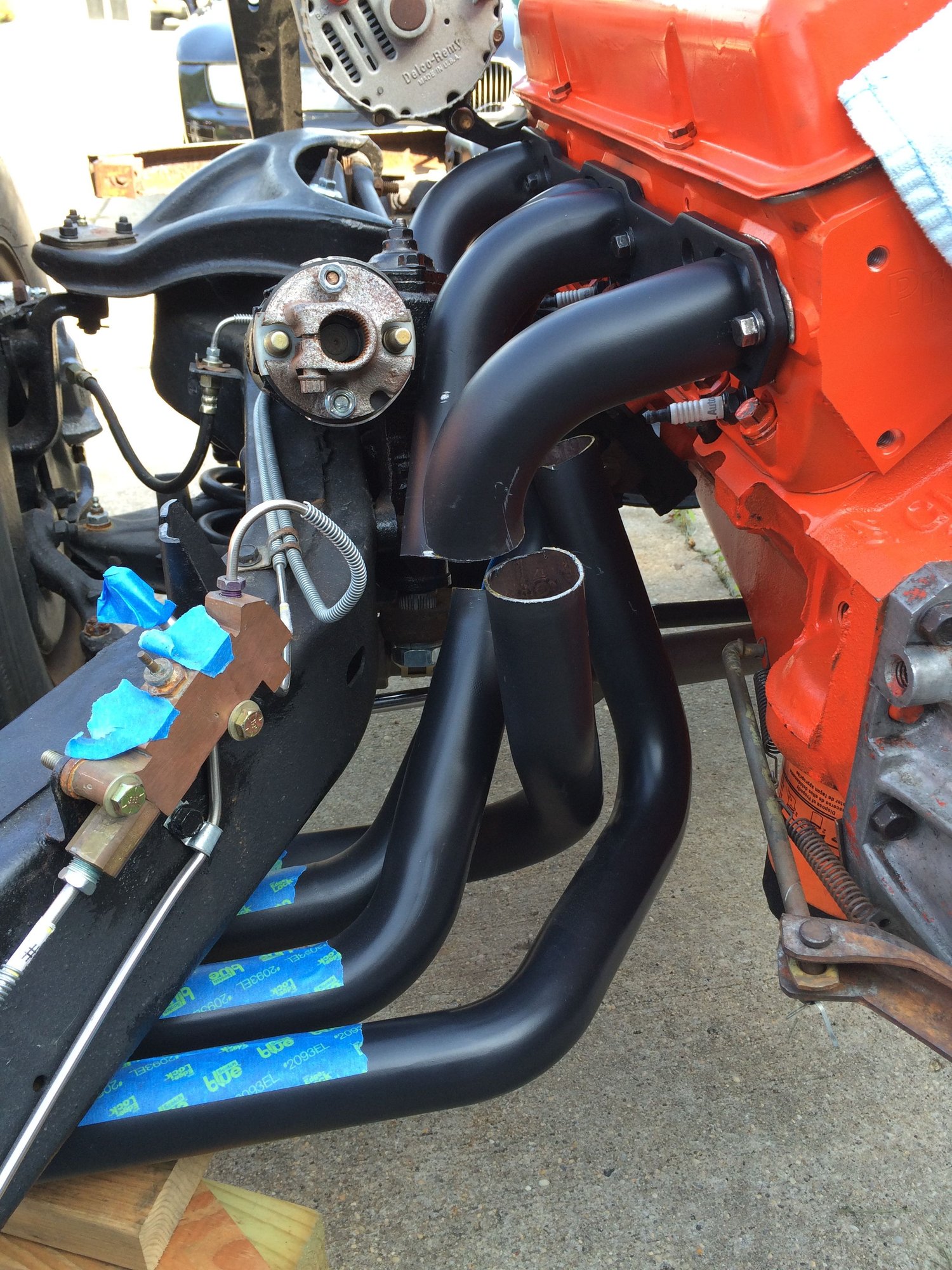

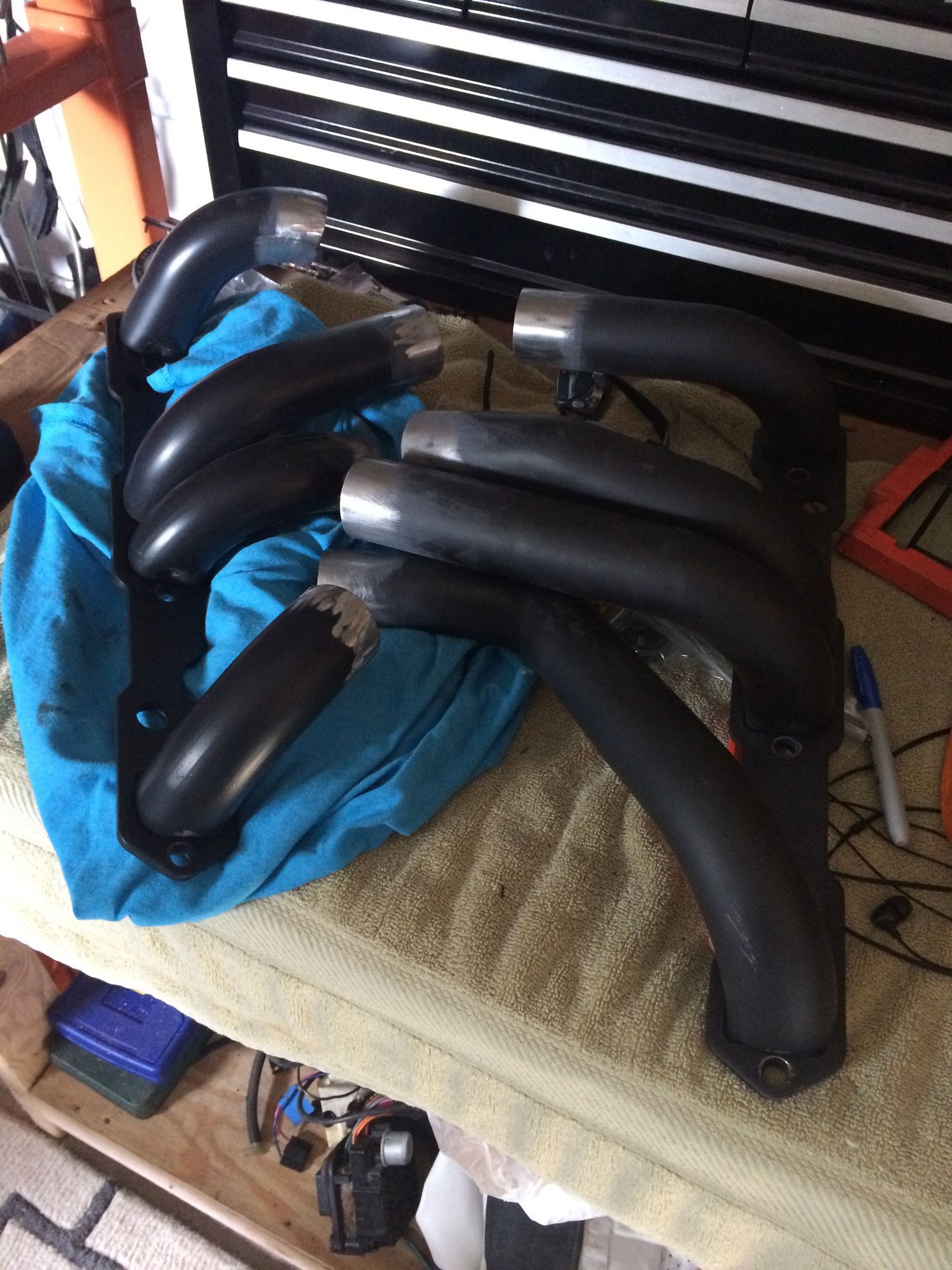

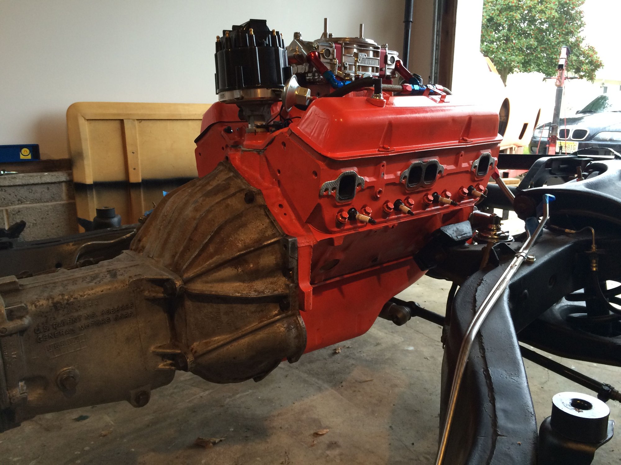

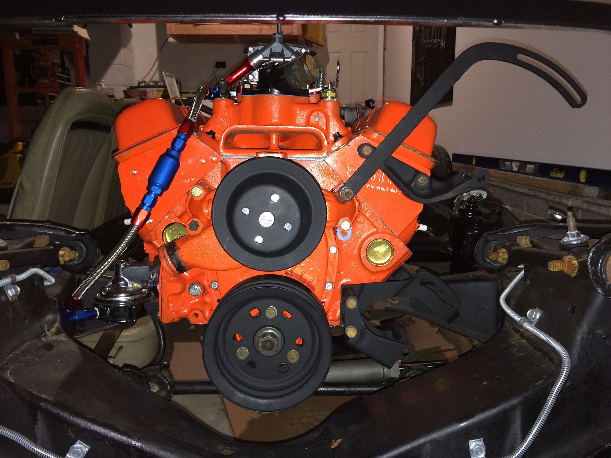

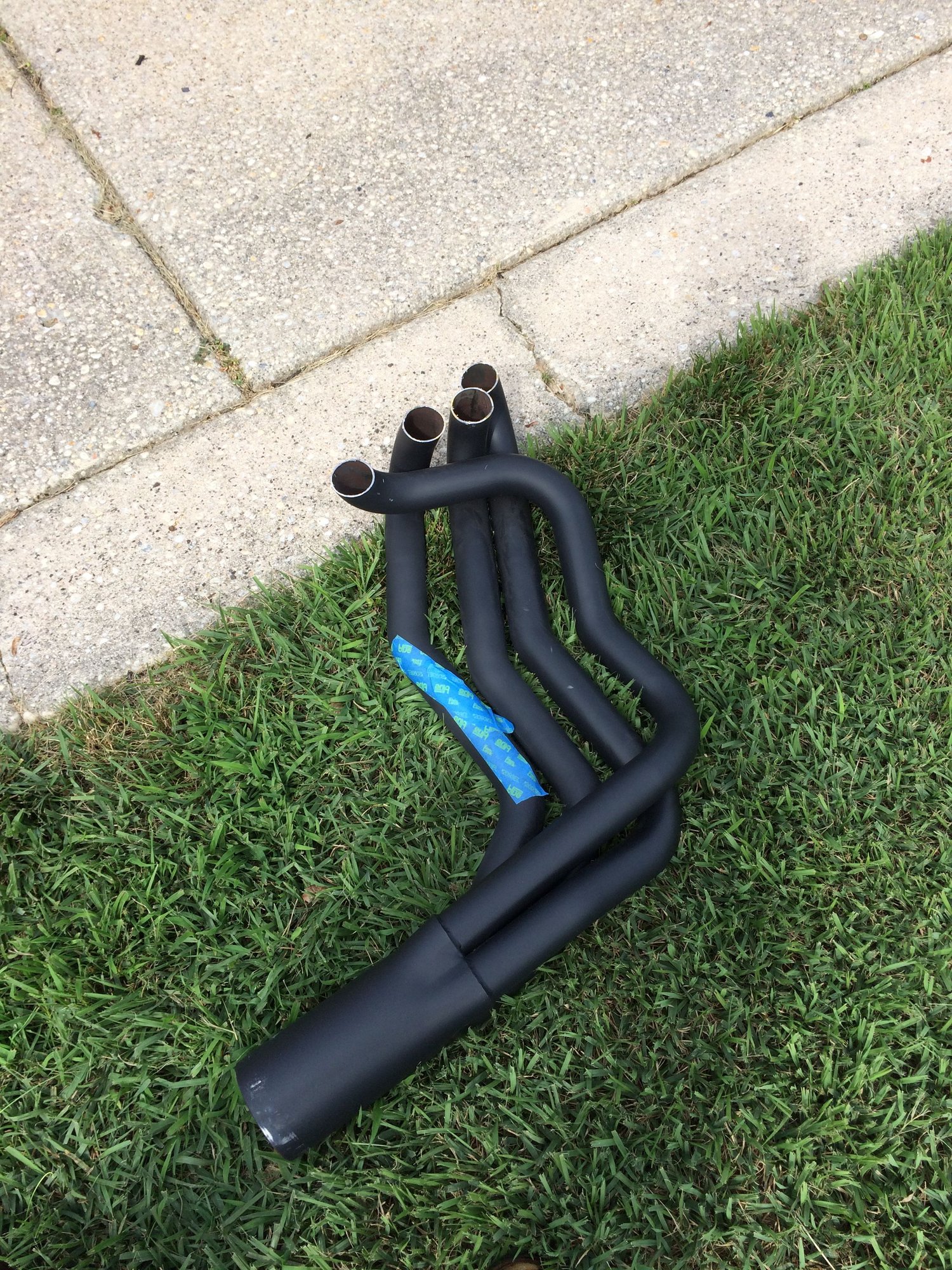

Dropped the motor into the chassis this past week. Started cleaning and painting brackets and pulleys. I also bolted up the exhaust, which not surprisingly didn't fit. The heads are a 1/4" taller then stock. I bought the exhaust when I was going more stock with the motor. Now I need to decide if I want to lower the motor in the frame or lengthen the headers, which i had ceramic coated?

Either lowering the motor or lengthening the headers, hmmm, maybe go the header route because of all the other parts that will be effected by the lower motor, a lot, plus if ever the motor should be switched, it would be at normal height and ground clearance.
Good hp numbers from the small block to.
Labhound, I've been leaning towards modifying the headers for the reasons you mentioned. I was just hoping to avoid cutting apart those headers. Just one more thing to change I was hoping I wouldn't have to.

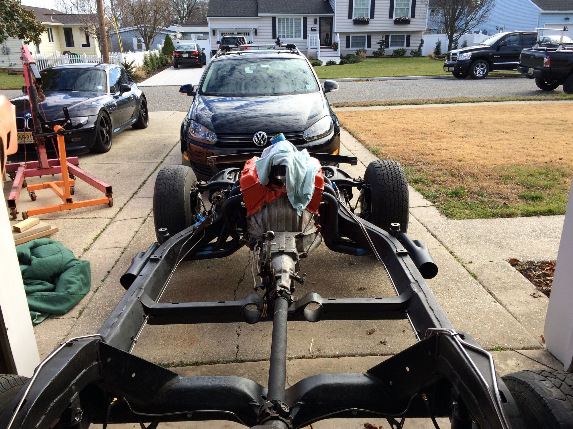

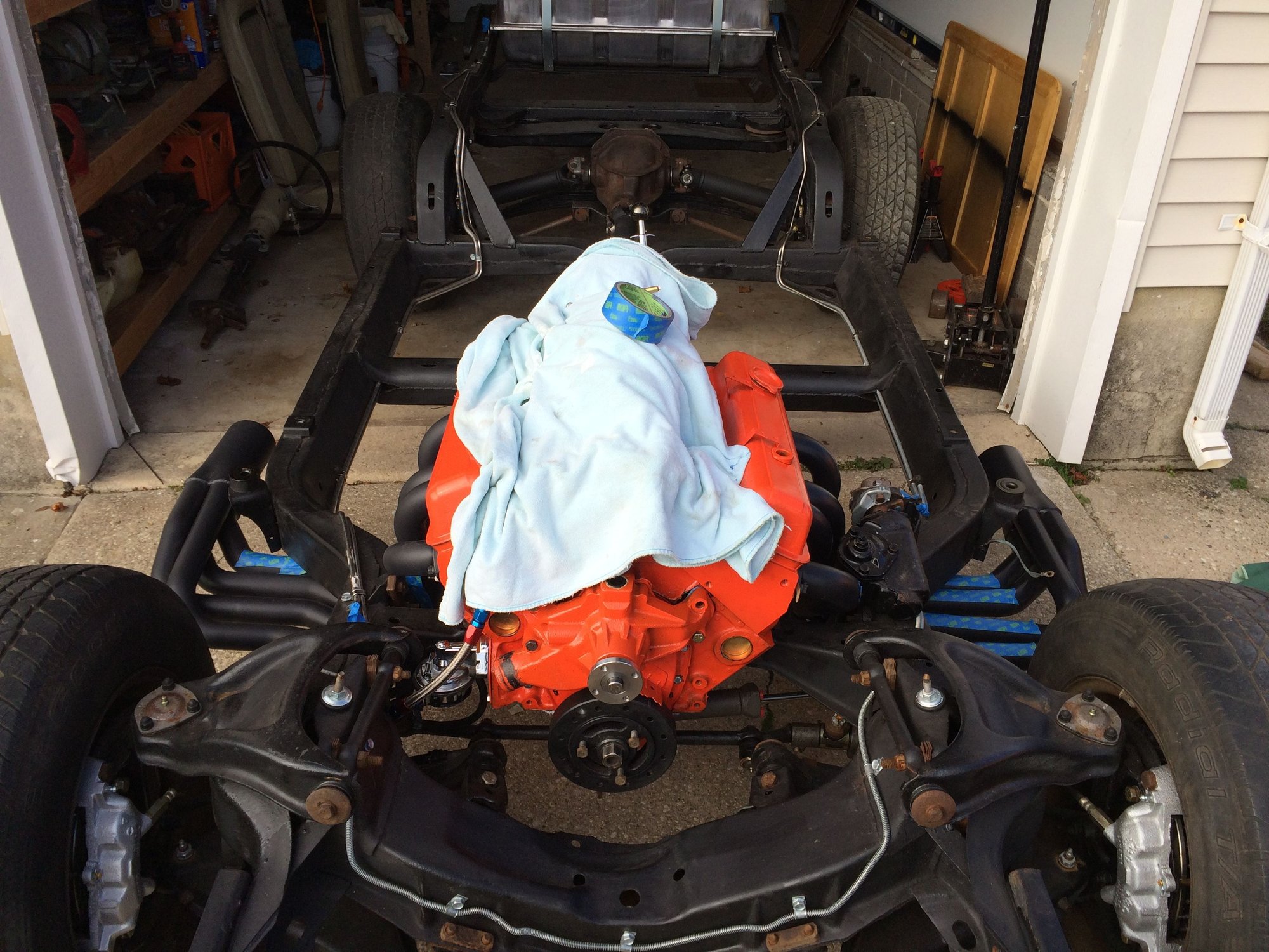

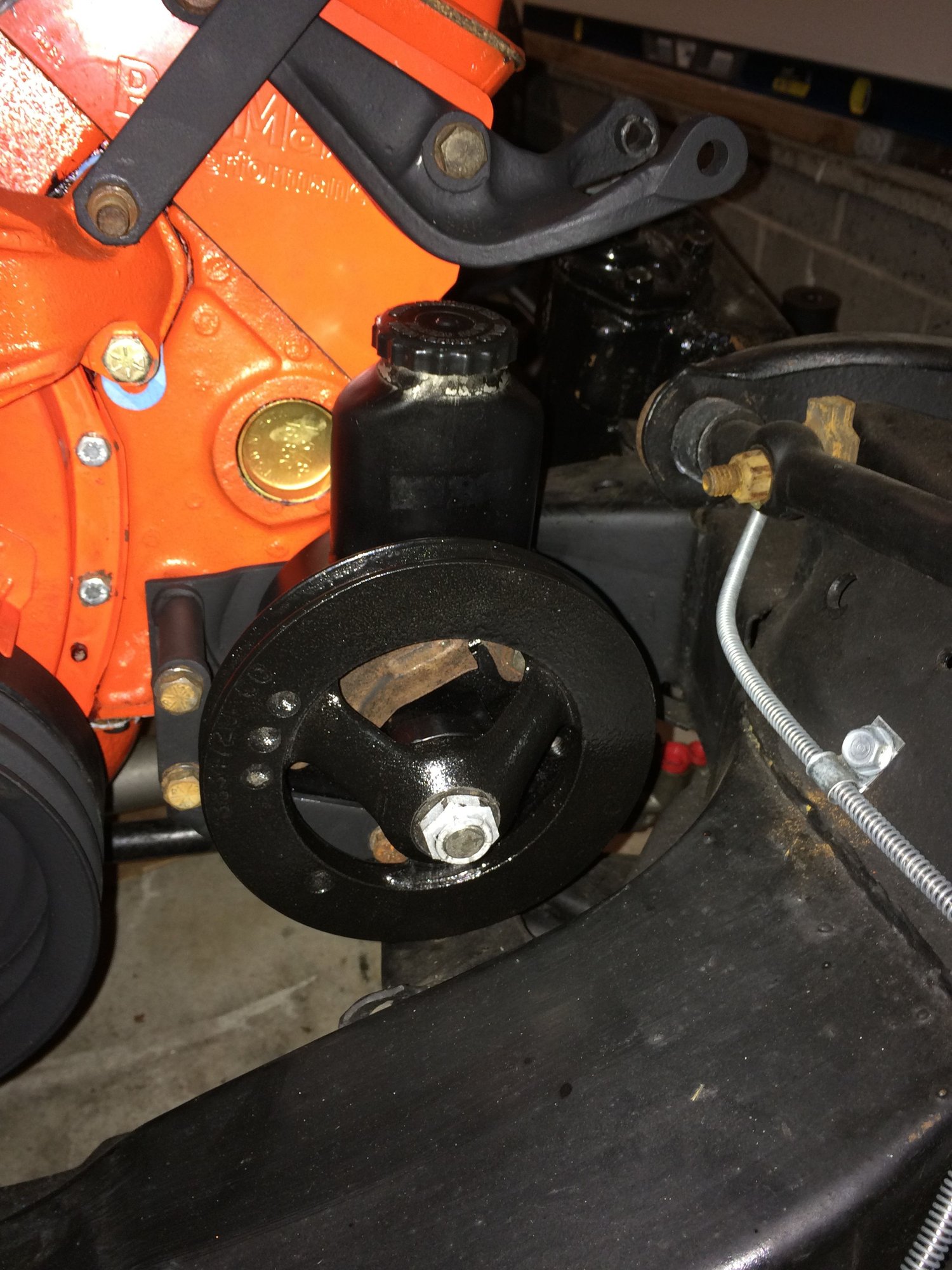

Cleaned, painted, and installed the pulleys, power steering pump brackets, and the alternator brackets.

Slow progress. Plumbed the gas tank, still working on engine accessories, and finishing up the chassis.

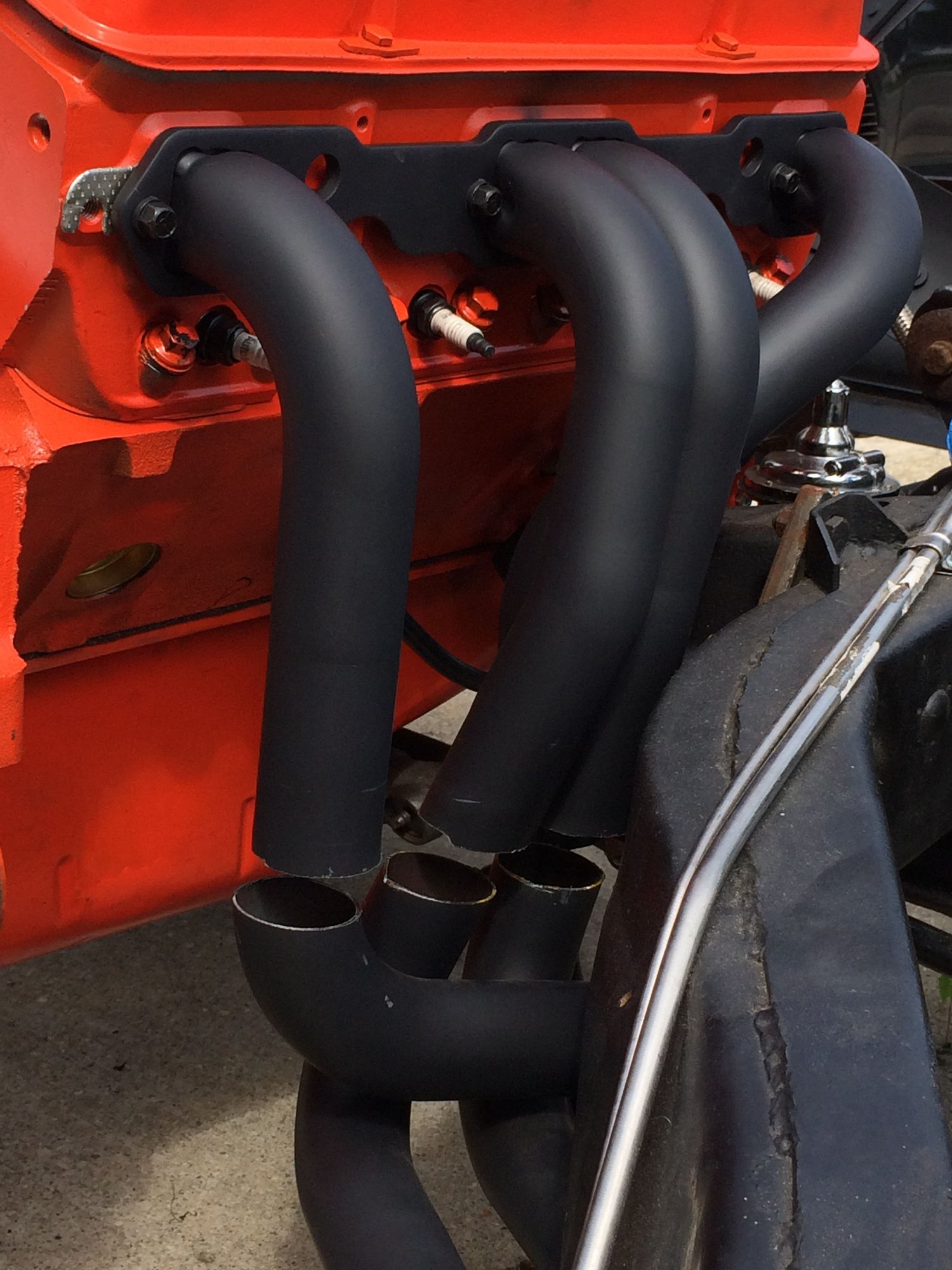

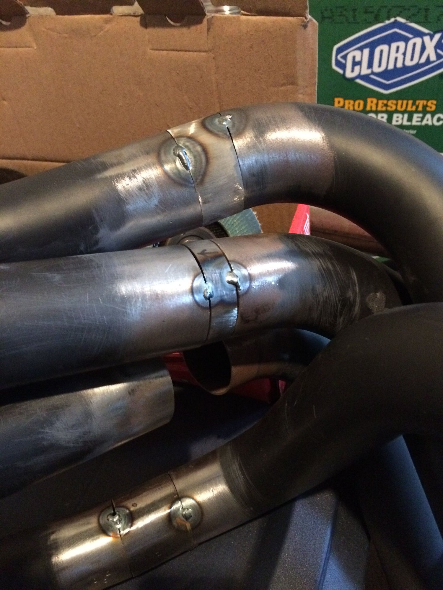

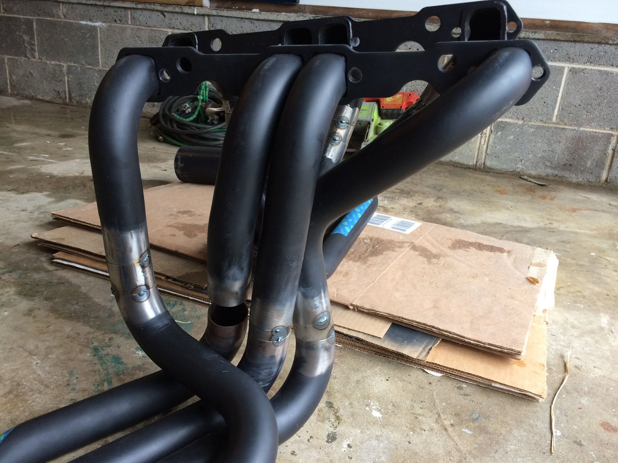

Back on it. Finally took the plunge and cut up my headers.

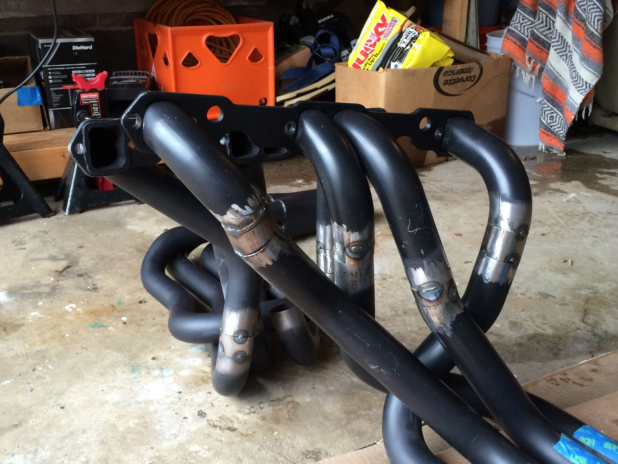

Prepped the headers last night. Planning to weld them up on Saturday.

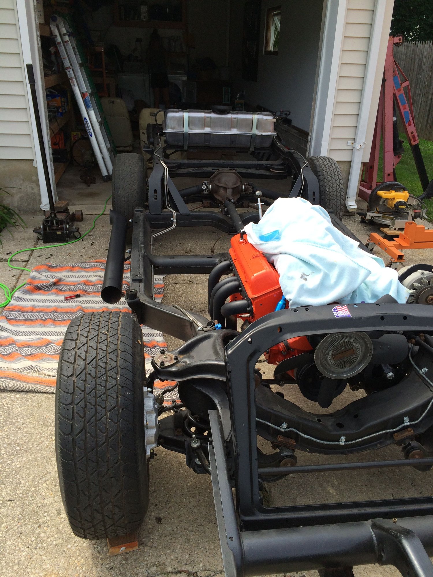

Spent Saturday sorting out the exhaust. It is fitted and tacked together. Just needs to be welded solid.

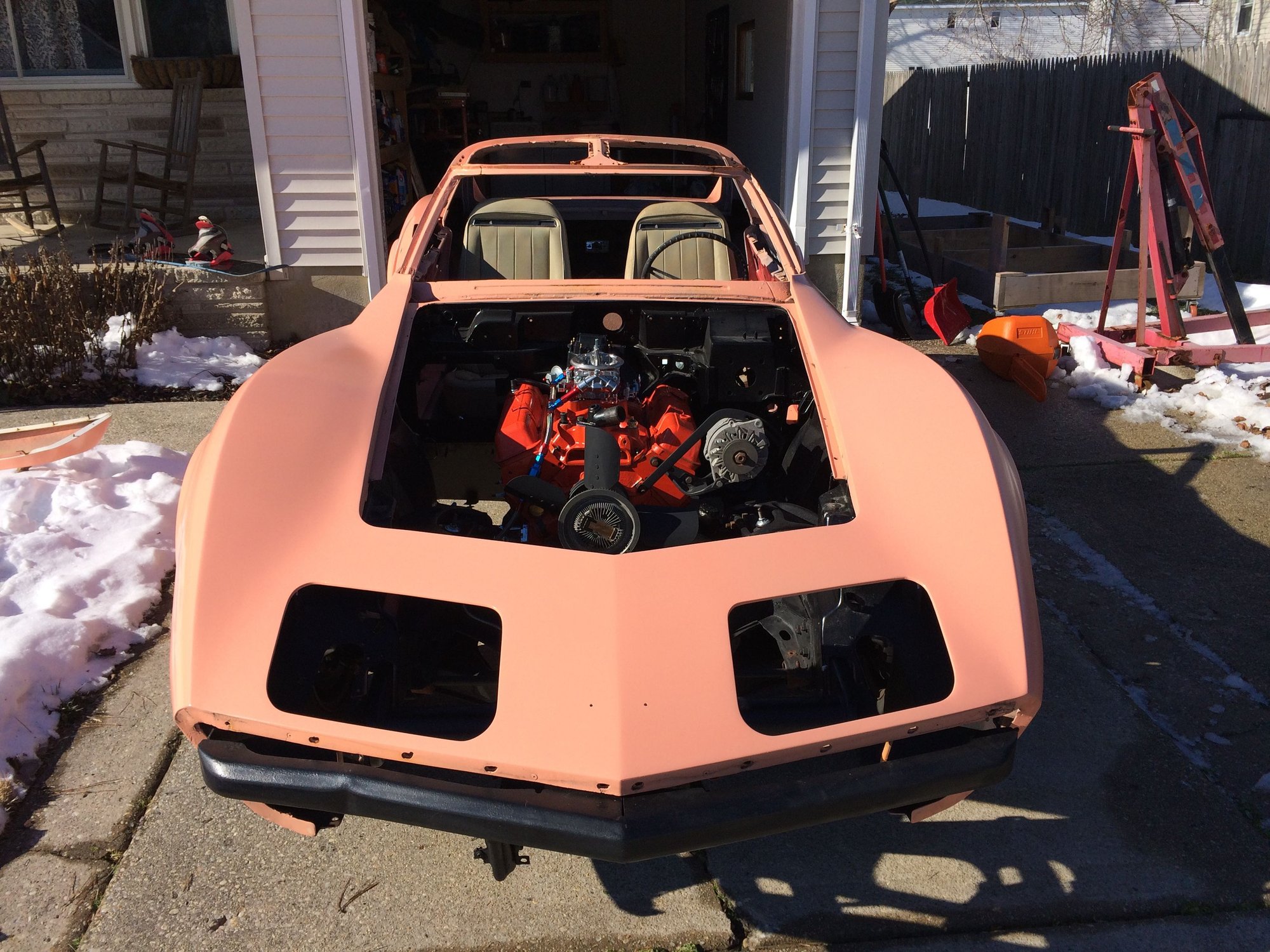

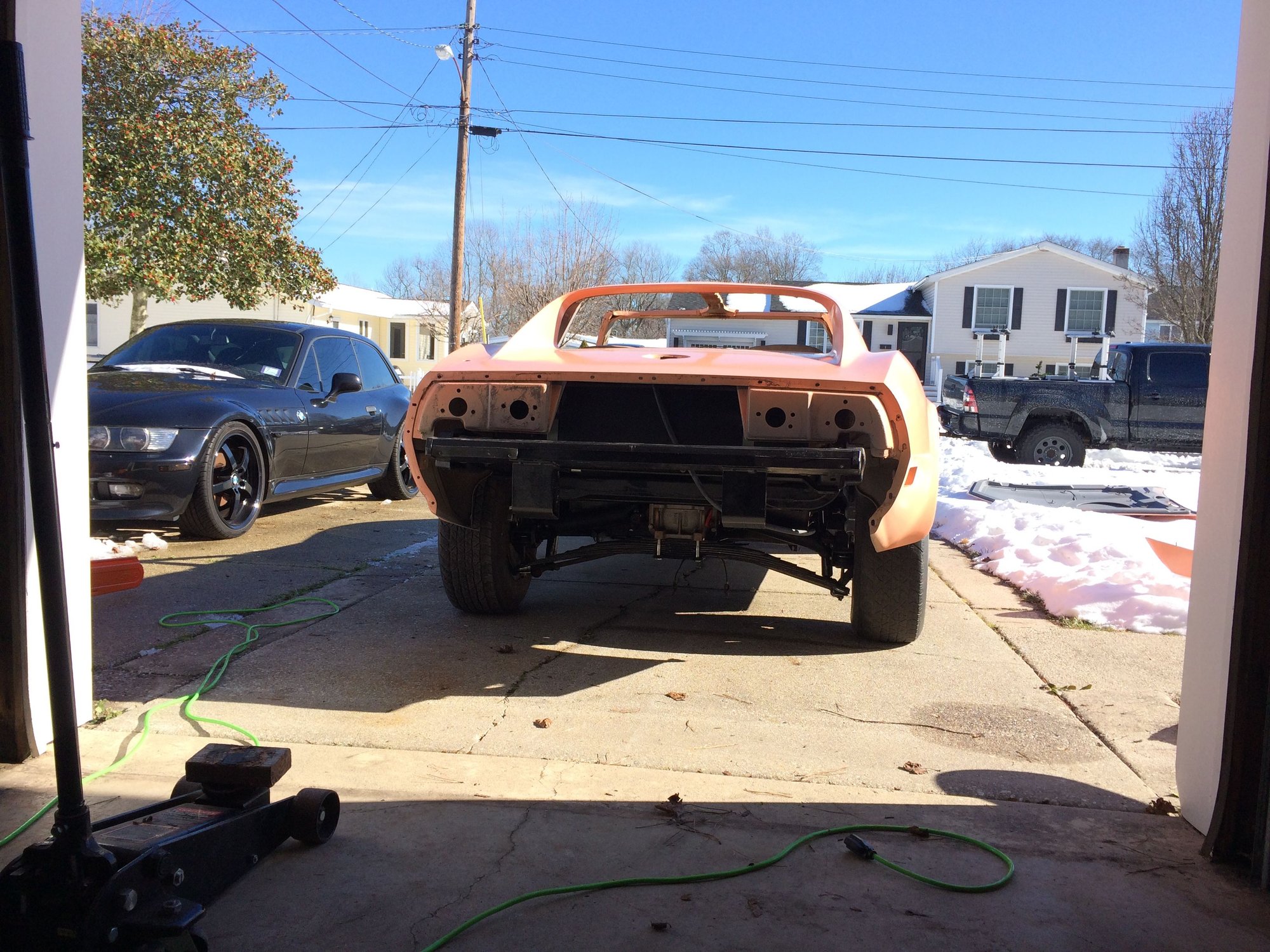

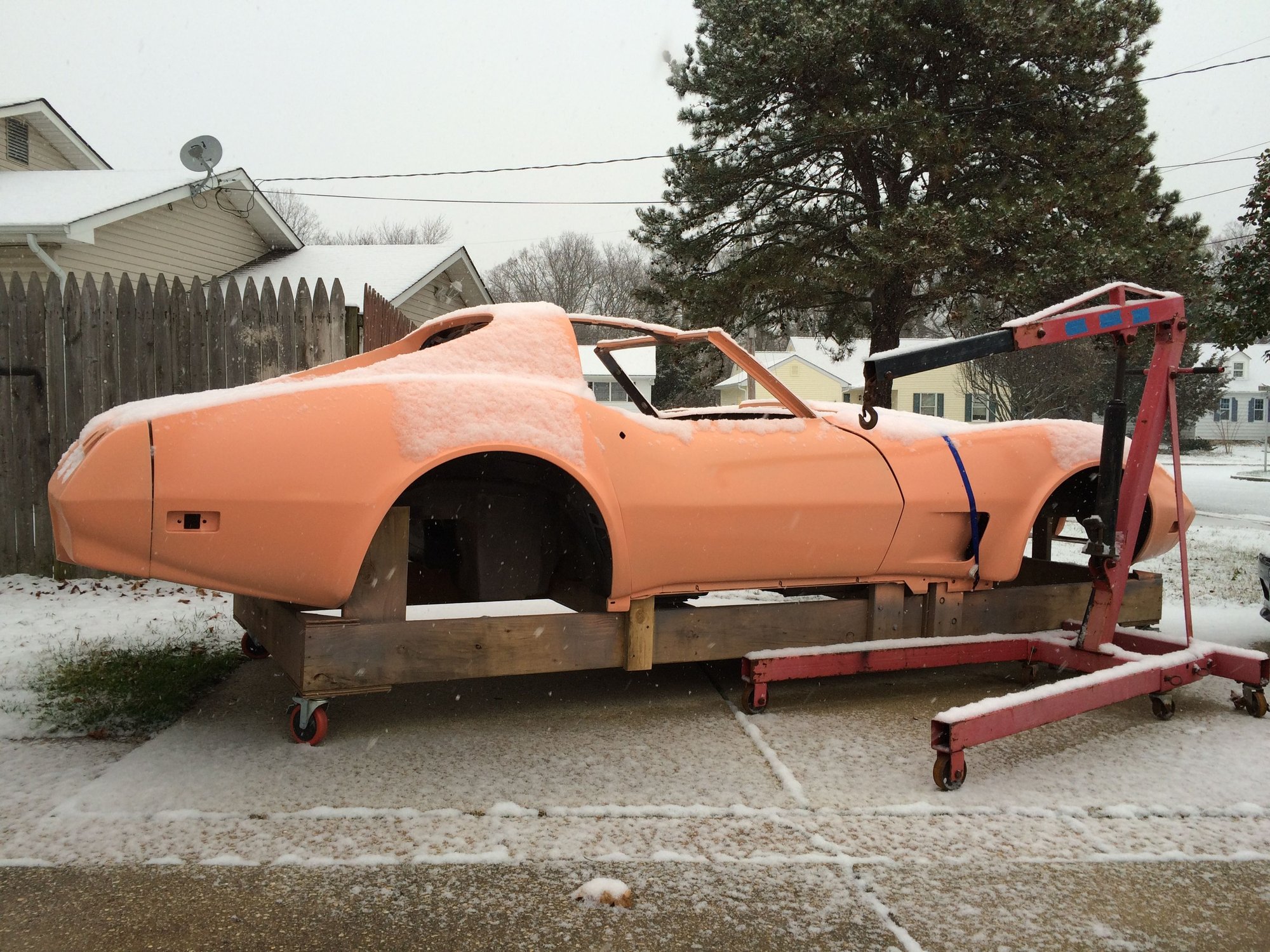

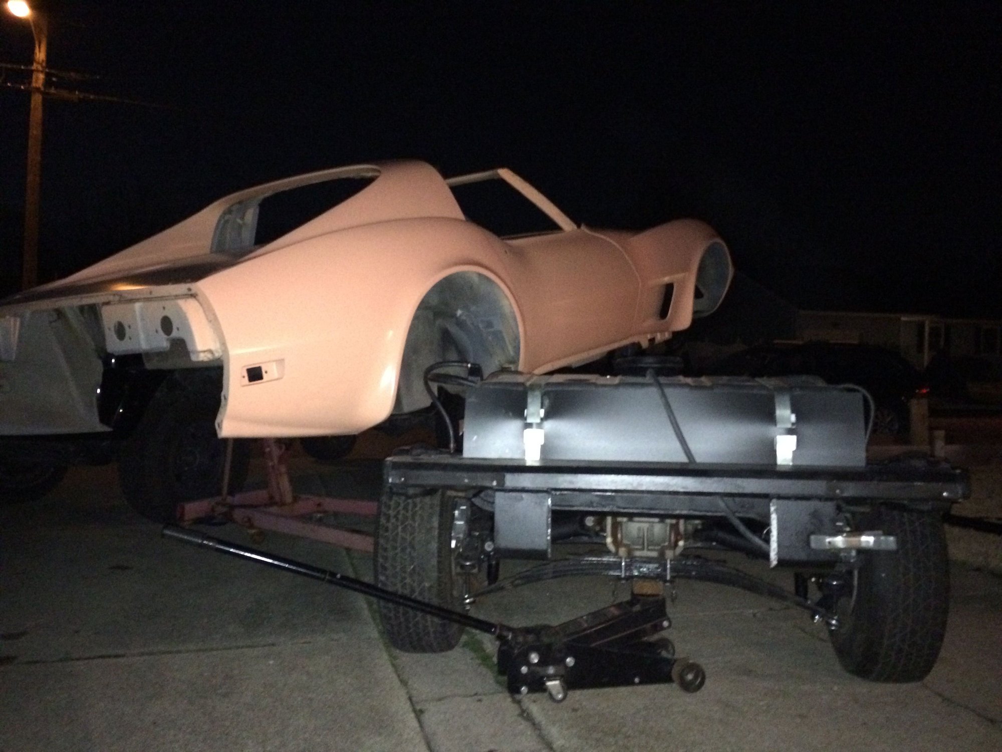

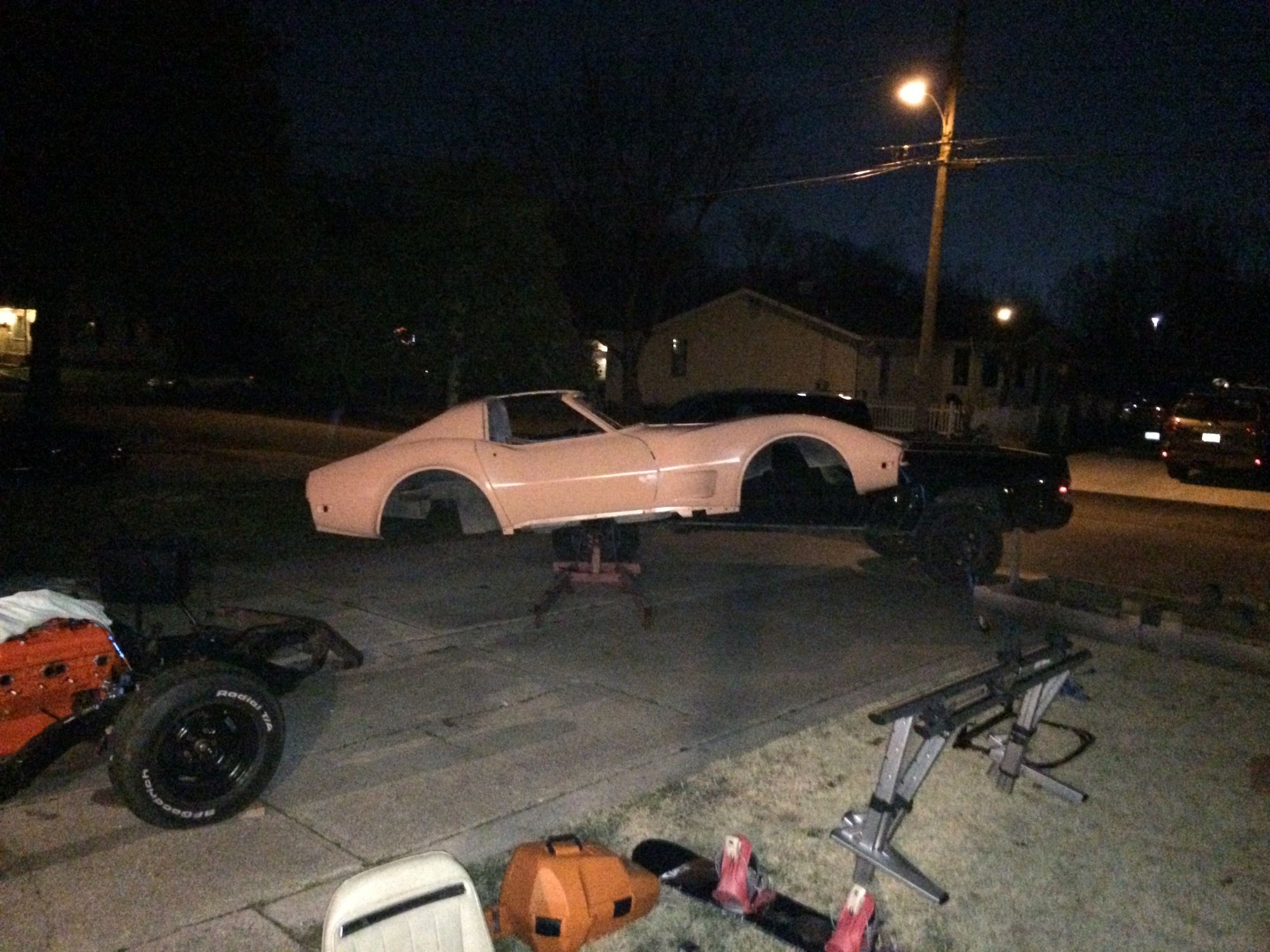

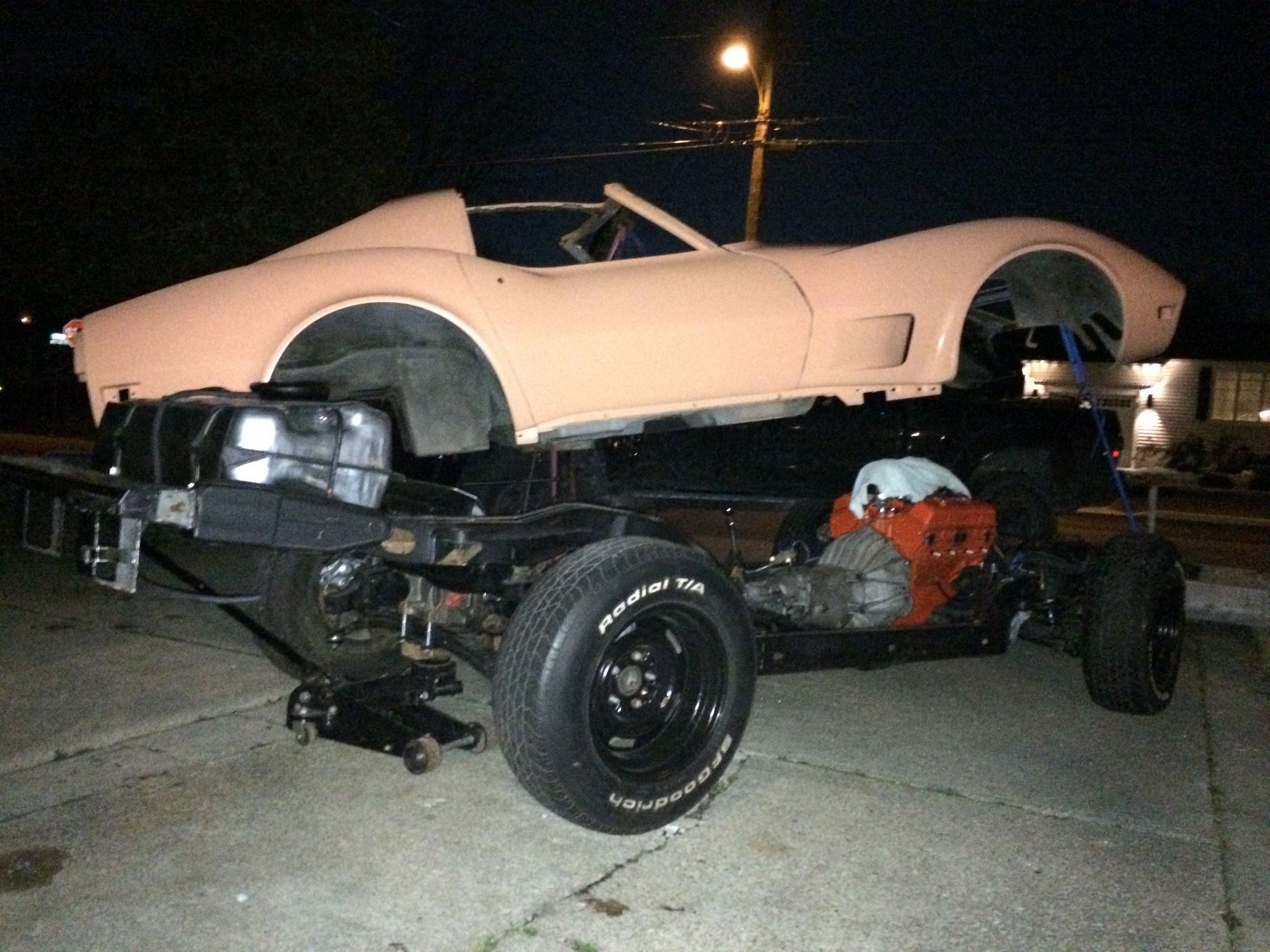

Finally had the time to put the body back on the chassis.

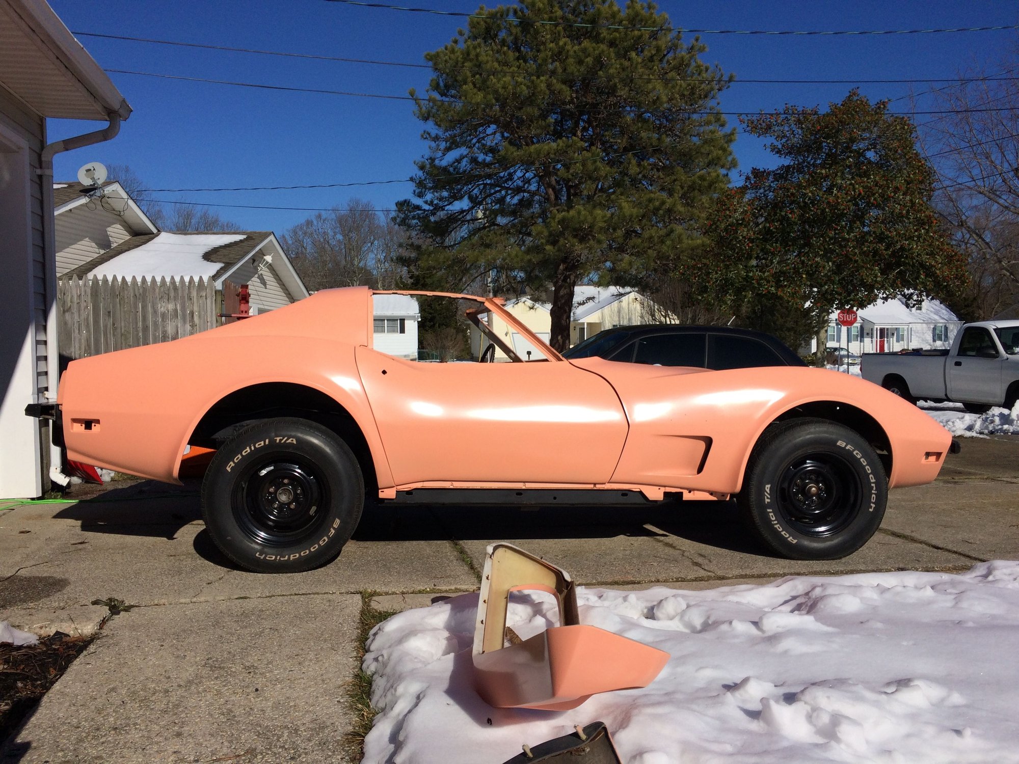

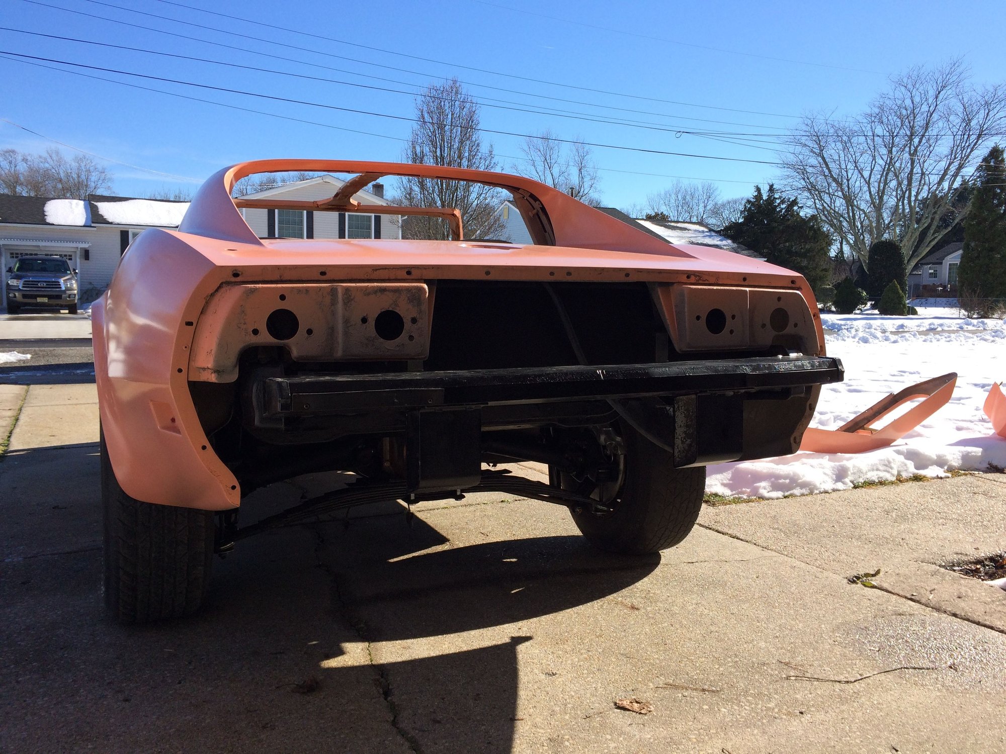

Torqued the rear spring. Put the steering column in to make it easier to move around and cleaned things up.
