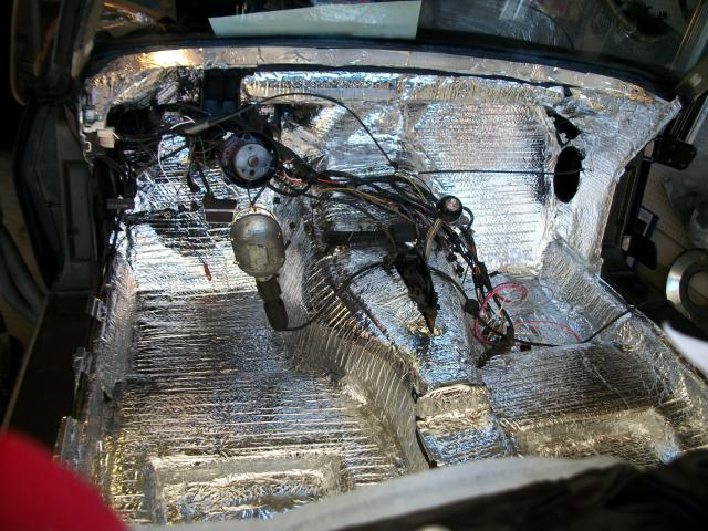

I used precut heat resistant sound deadener on floorboard "hotspots", and rolls of 1/4" thick by 36" wide HVAC double sided Foil bubble wrap.

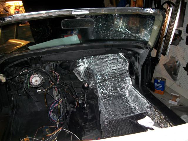

I precut the HVAC wrap to fit the passenger side of the interior first since the steering wheel was in the way.
*I used heavy duty aluminum foil HVAC Tape to hold the edges of the glued wrap in place. I also used the HVAC Tape to join any wrap-seams together*
*I glued small areas as I worked the wrap into place...full adhesive coverage isn't necessary.... I brushed on contact cement doing small areas to keep the glue tacky*
I did not fully coat the entire interior with the glue in case I needed to remove the wrap or carpet for any reason.
I applied only spots of glue on flat fiberglass floorboard to hold the wrap in place, and extra glue on vertical areas to make sure the wrap did not sag.
I even wrapped under the dash, the upper floorboard, and the sheetmetal around the kick vents.....Glad I did.

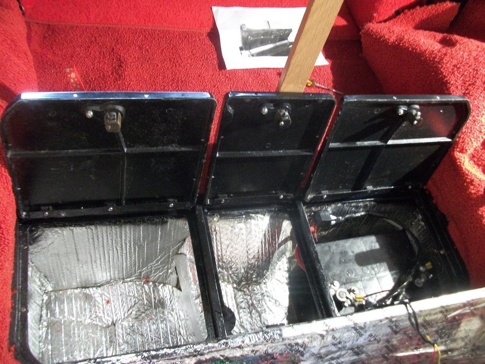

Then I covered the inside of the door fiberglass/door-skins because of the sidepipes and road noise

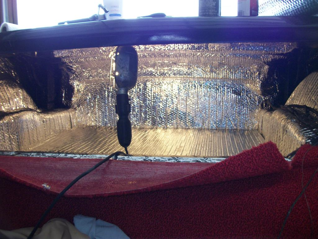

I also covered the rear interior of the car including the underside of the deck and the deck lid the same way.
The car was so much cooler and quieter in the interior afterwards.

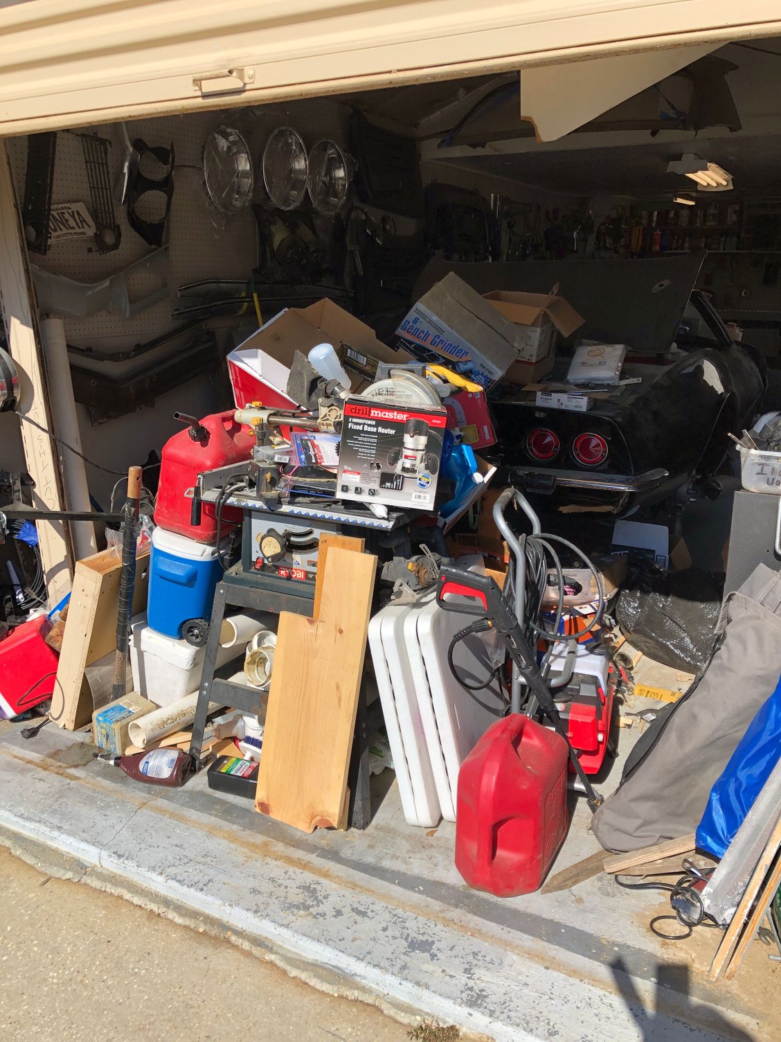

The only problem is...I can't see the Vette anymore. Since the weather is so bad I couldn't move all the collected boxes, bins. transmission case, etc outside to do the cleanup properly.
SO...the car with the top off is loaded down with everything until I rearrange/clean/paint the back half of the garage floor.
()no picture of the car....I'm too ashamed of the mess

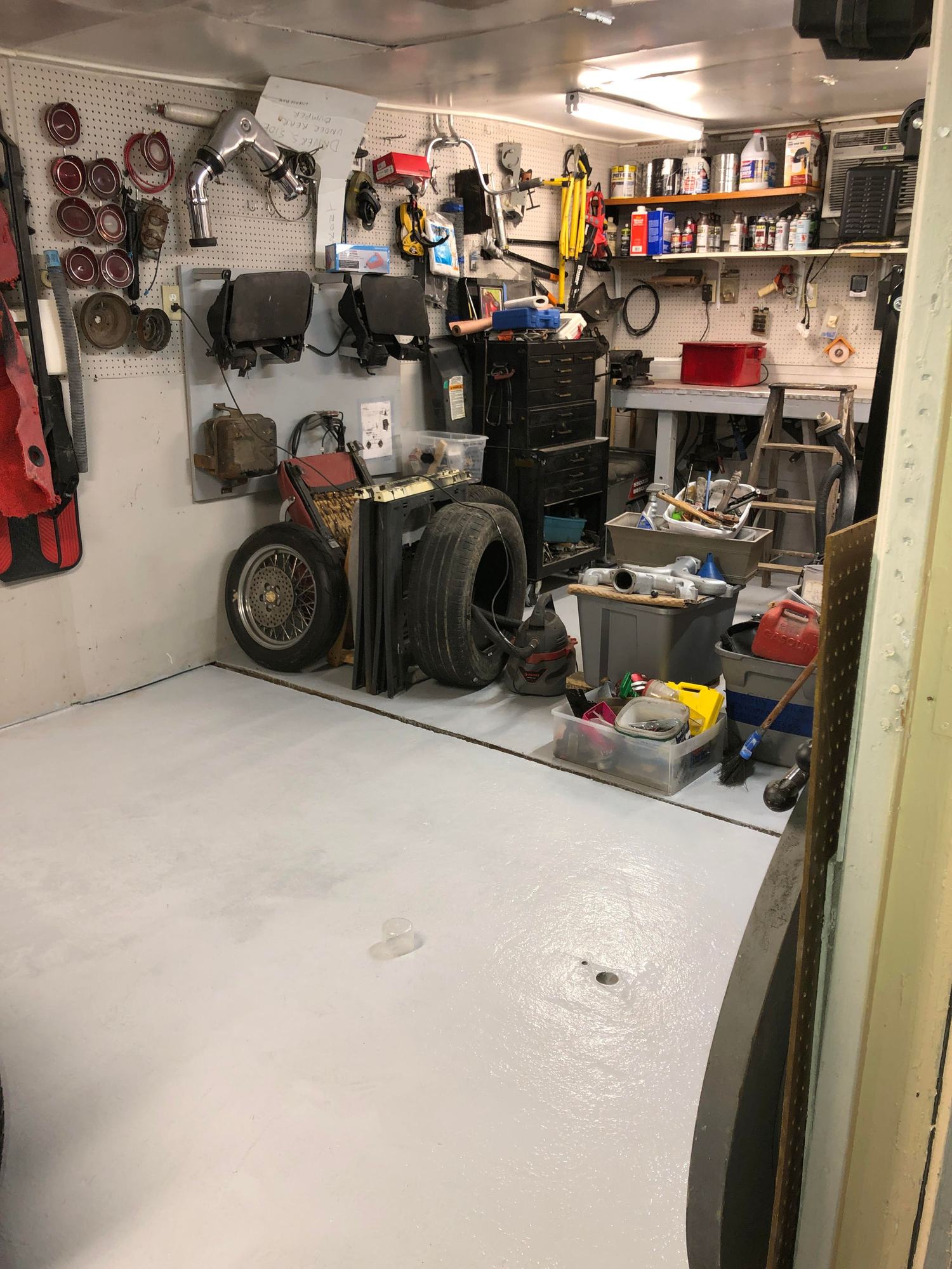

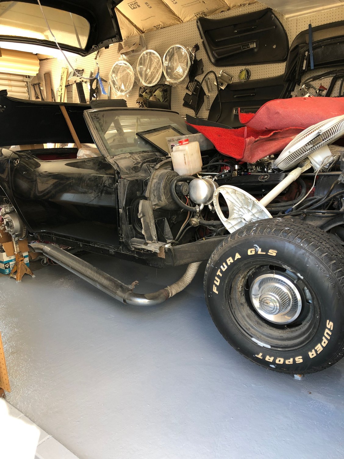

I dove back in to the garage this a.m. What hapeened was...because the car is still in jackstands...
I shoveled all the PTSD trash underneath the car toward the garage door.
Then I applied concrete paint......
Sufferin' succotash.......
Now I can actually see the floor and do some painting.........
That's a little better at the front half of the car

That’s a nice fan Tony.
How many amps will it pull and will you need to upgrade your alternator?
I'm more concerned about how close to the floor that side pipe is
I been telling you people PTSD makes one stupid !
Anyhow......the dirty deed is done ..............
