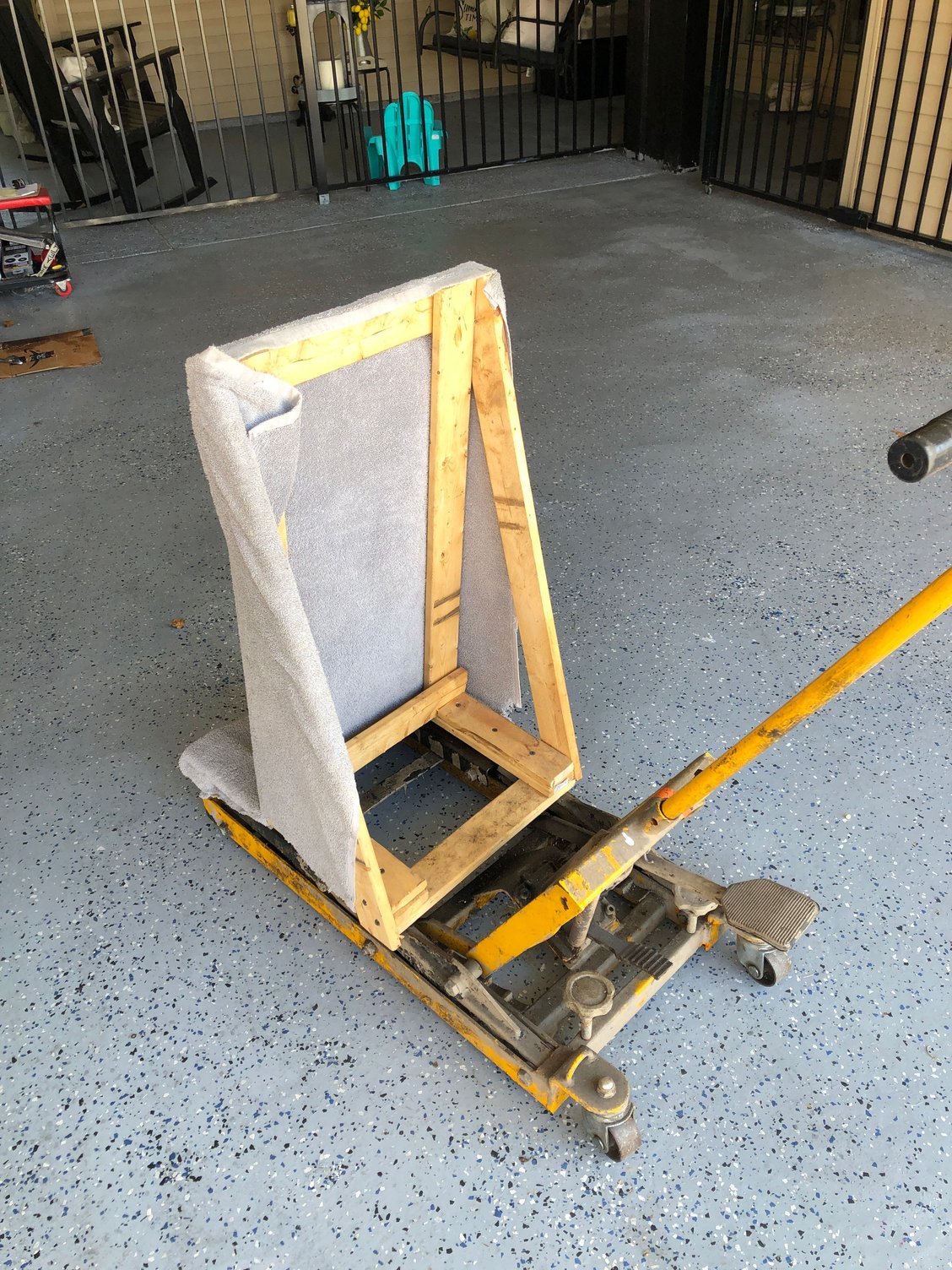

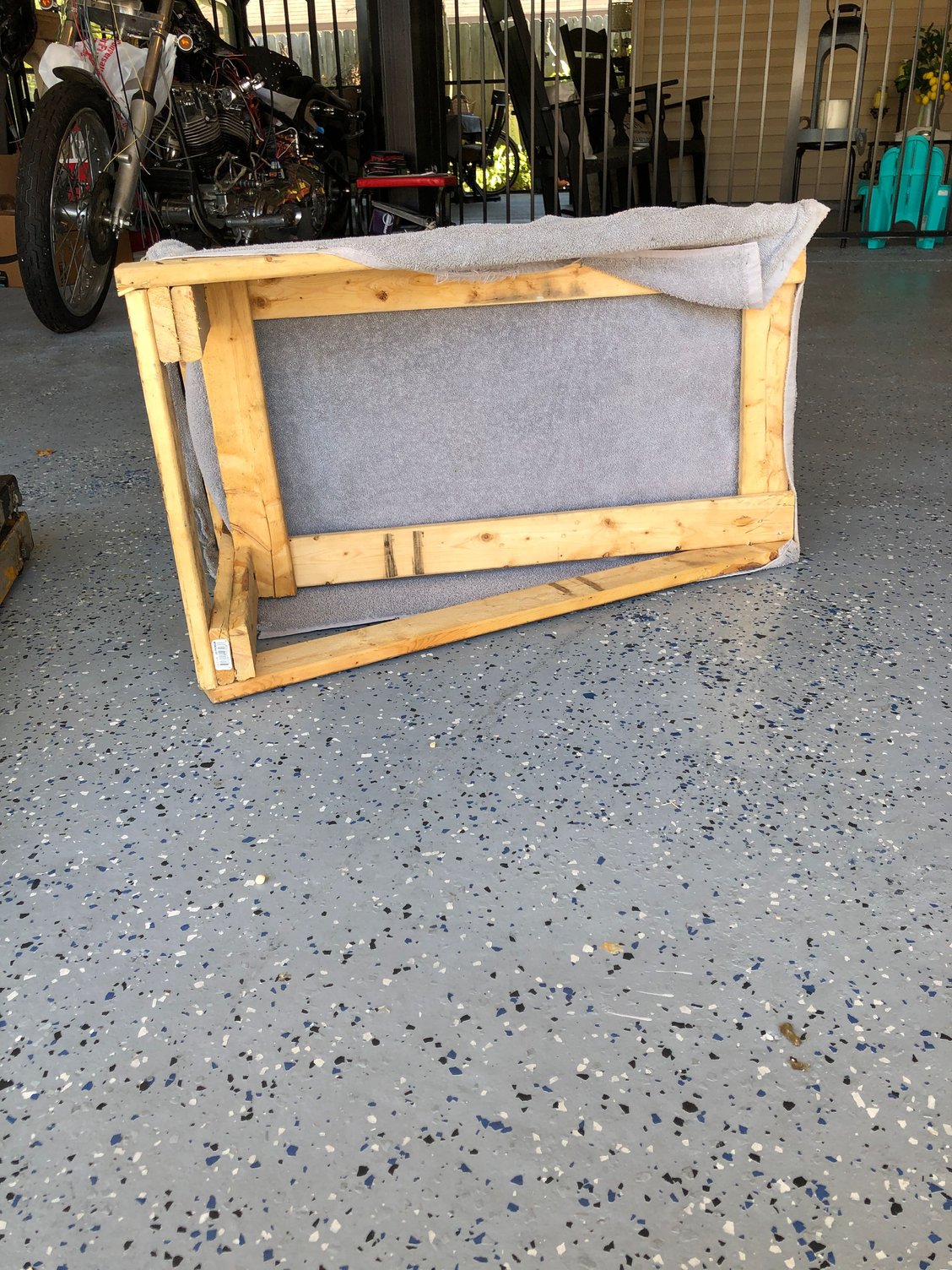

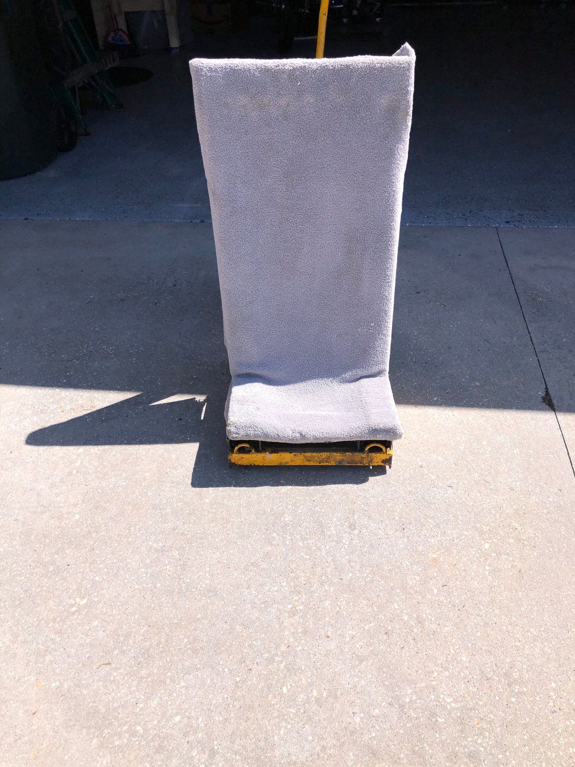

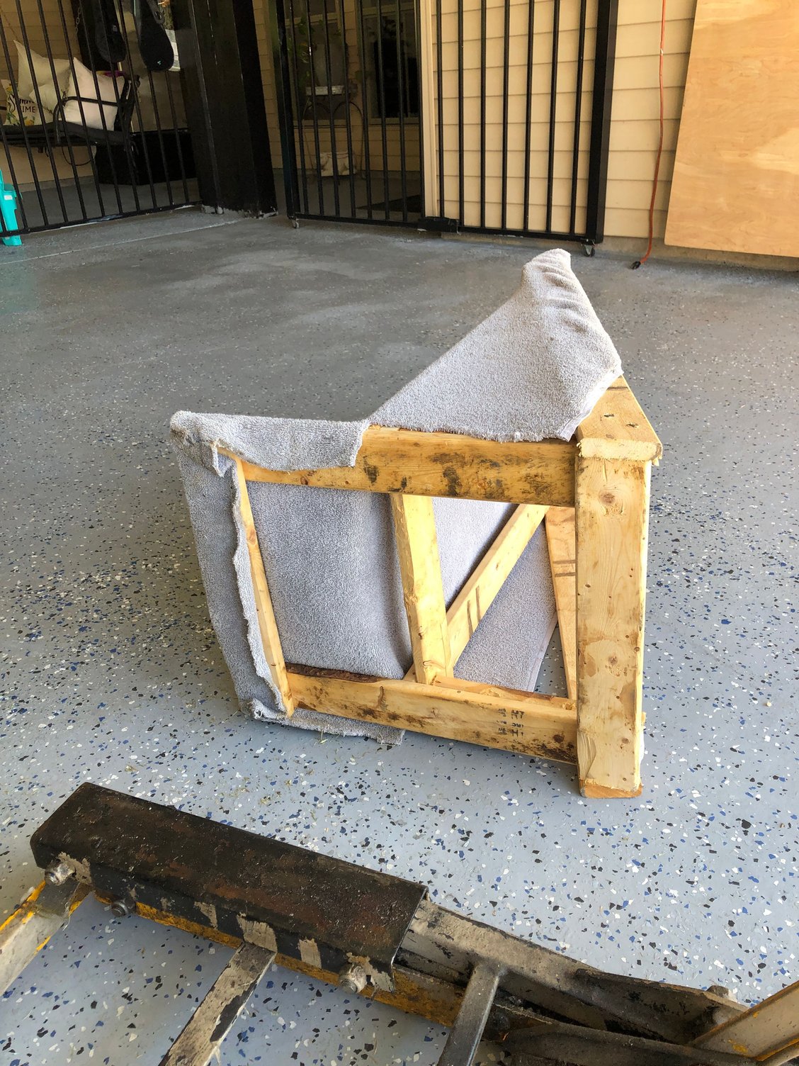

Priya was asking about an easy-to-use one-person door lift to make installing/adjusting a door easier.
I lost the original pics so here is the updated version...this motorcycle jack takes all the misery out of door installation/adjustment.......
Here ya go.....other members convinced me to build this frame a few years ago
It's wide enough to fit the width of the lifting platform.
It's about 2 feet tall.
The base of it is long enough to fit the lifting platform.
I stapled an old thick towel to protect the paint on the door...the staples are on the backside of the wooden frame.
I used simple straps to hold the door tight against the frame and used a wooden tapered shim under the door to make the hinge holes line up with the birdcage holes.
