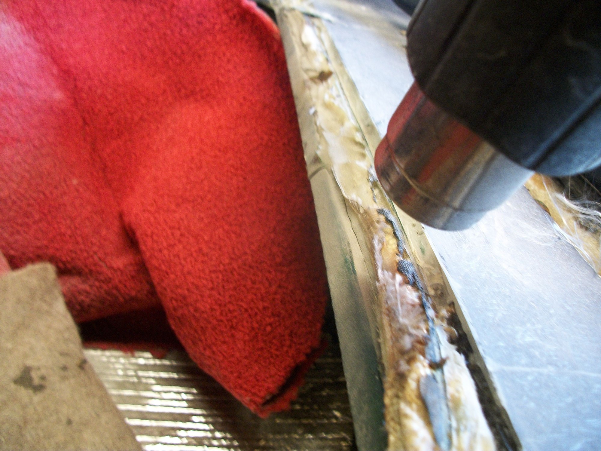

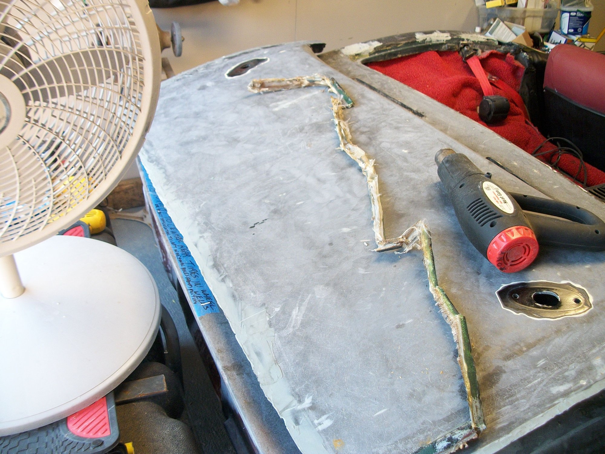

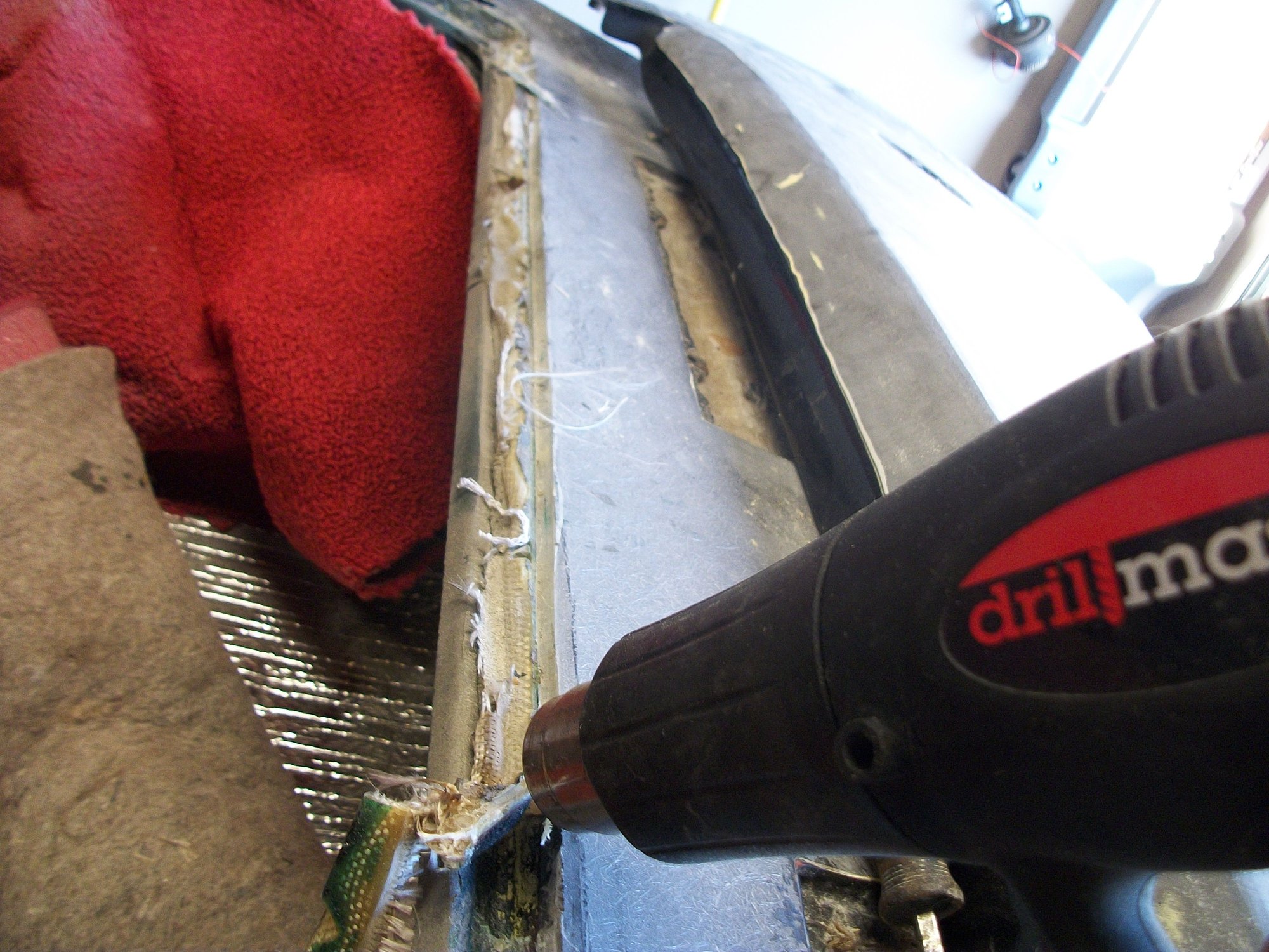

Now for the work it took to remove the fiberglass from the shoulder of the deck. It's a good thing the previous body man didn't remove the paint from the shoulder where the deck lid sits. I was able to heat the fiberglass enough to pry it off with a flat-tipped screwdriver....2 hours of heating/cooling the area----which is better than a day of grinding out bonded fiberglass!
Next......sand the area down to original fiberglass and build the underside up with fiberglass where any gouges are.

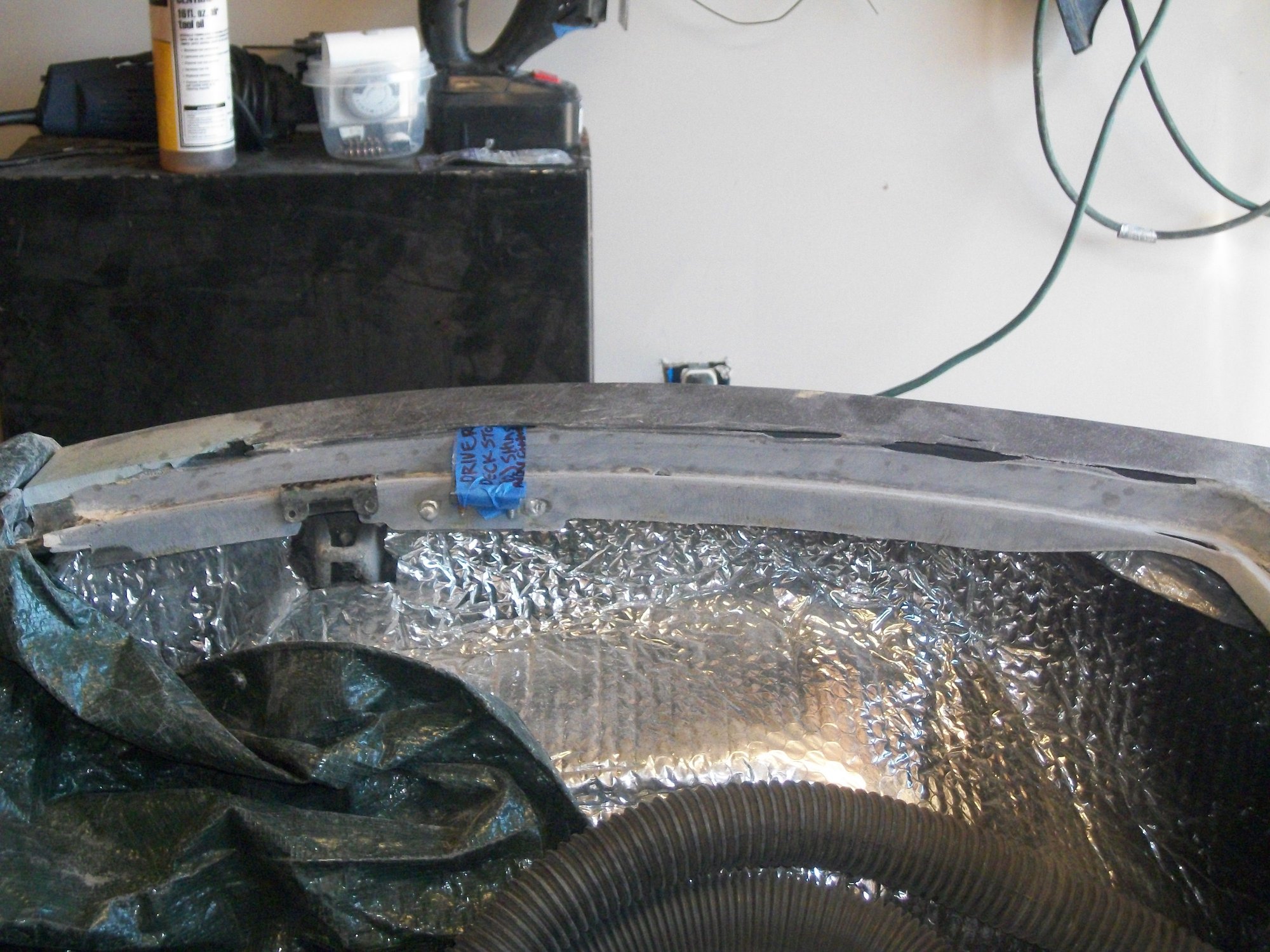

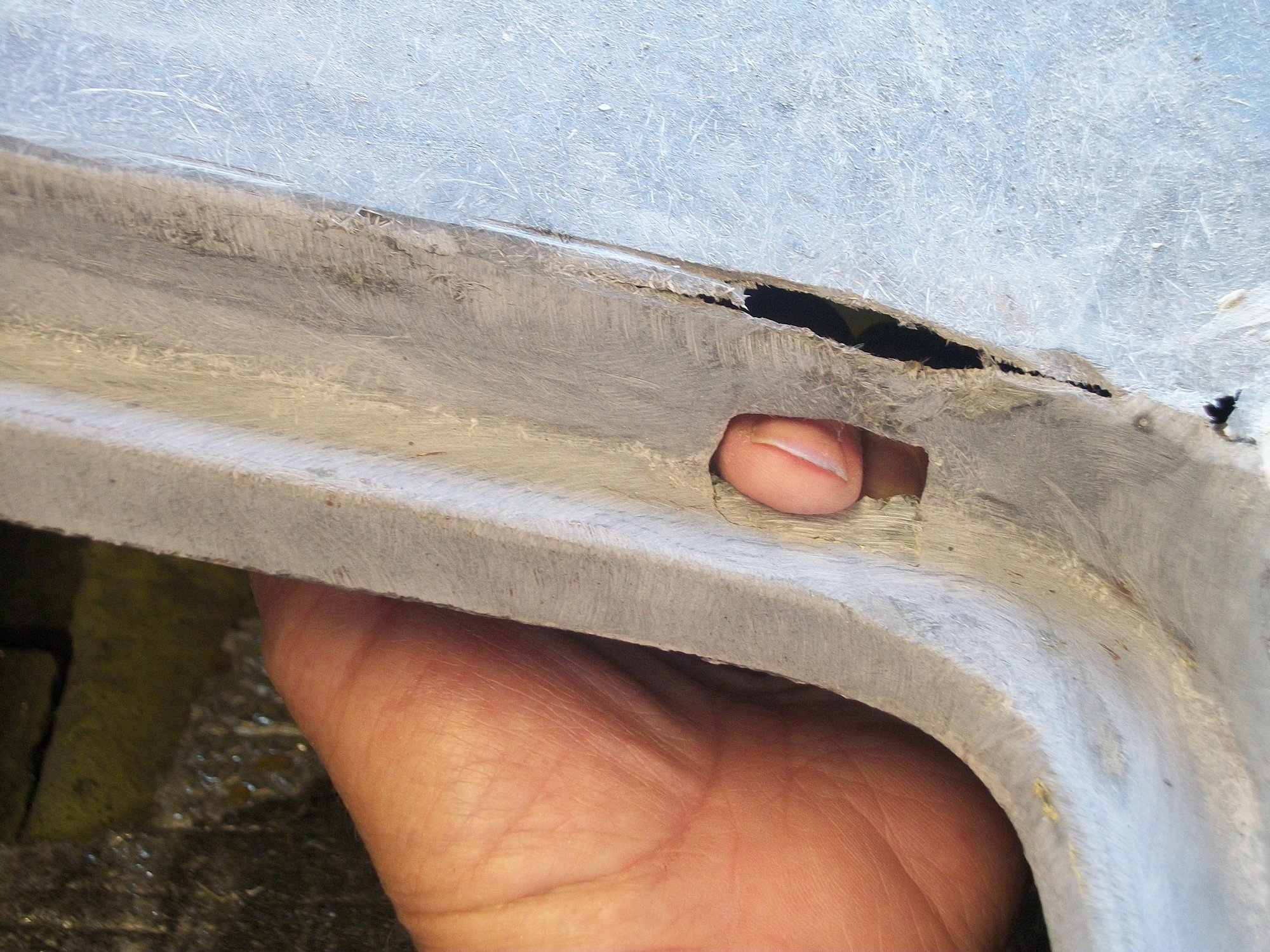

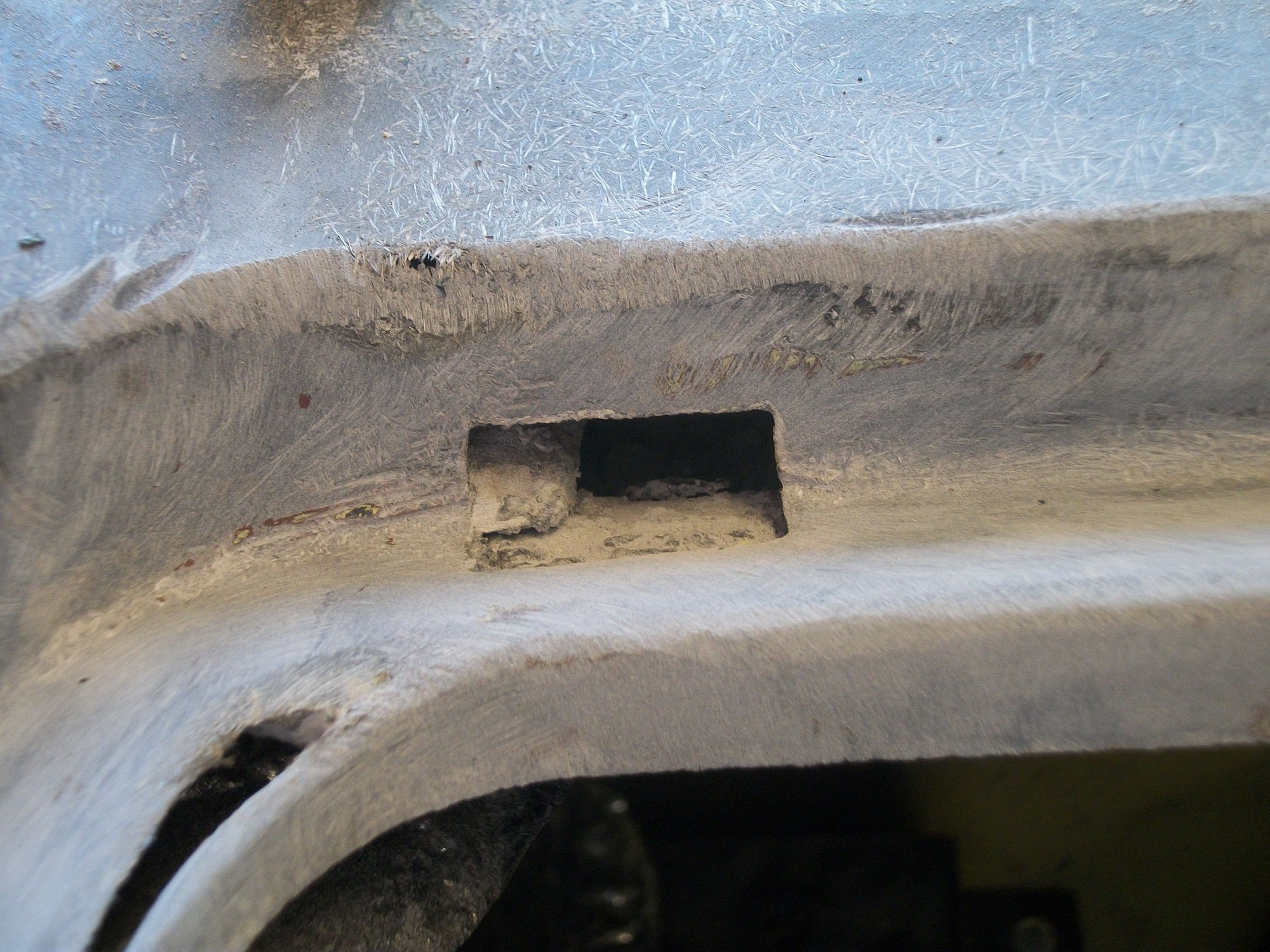

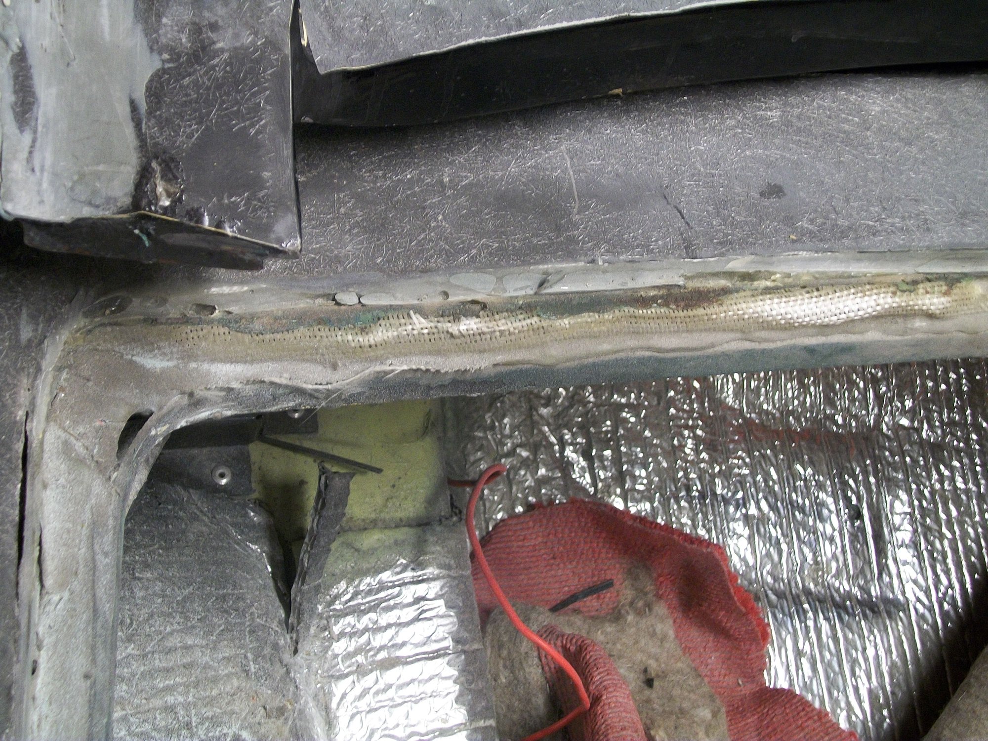

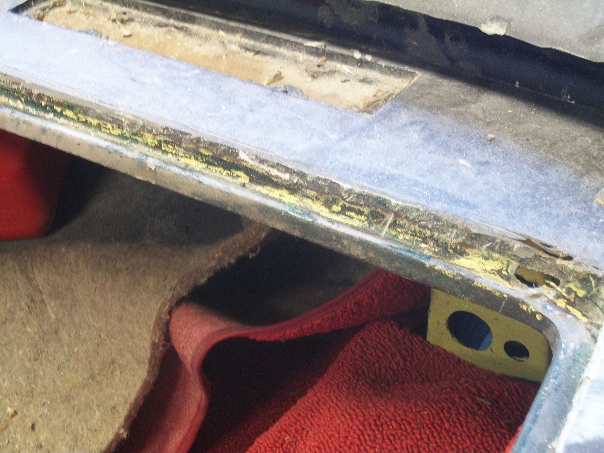

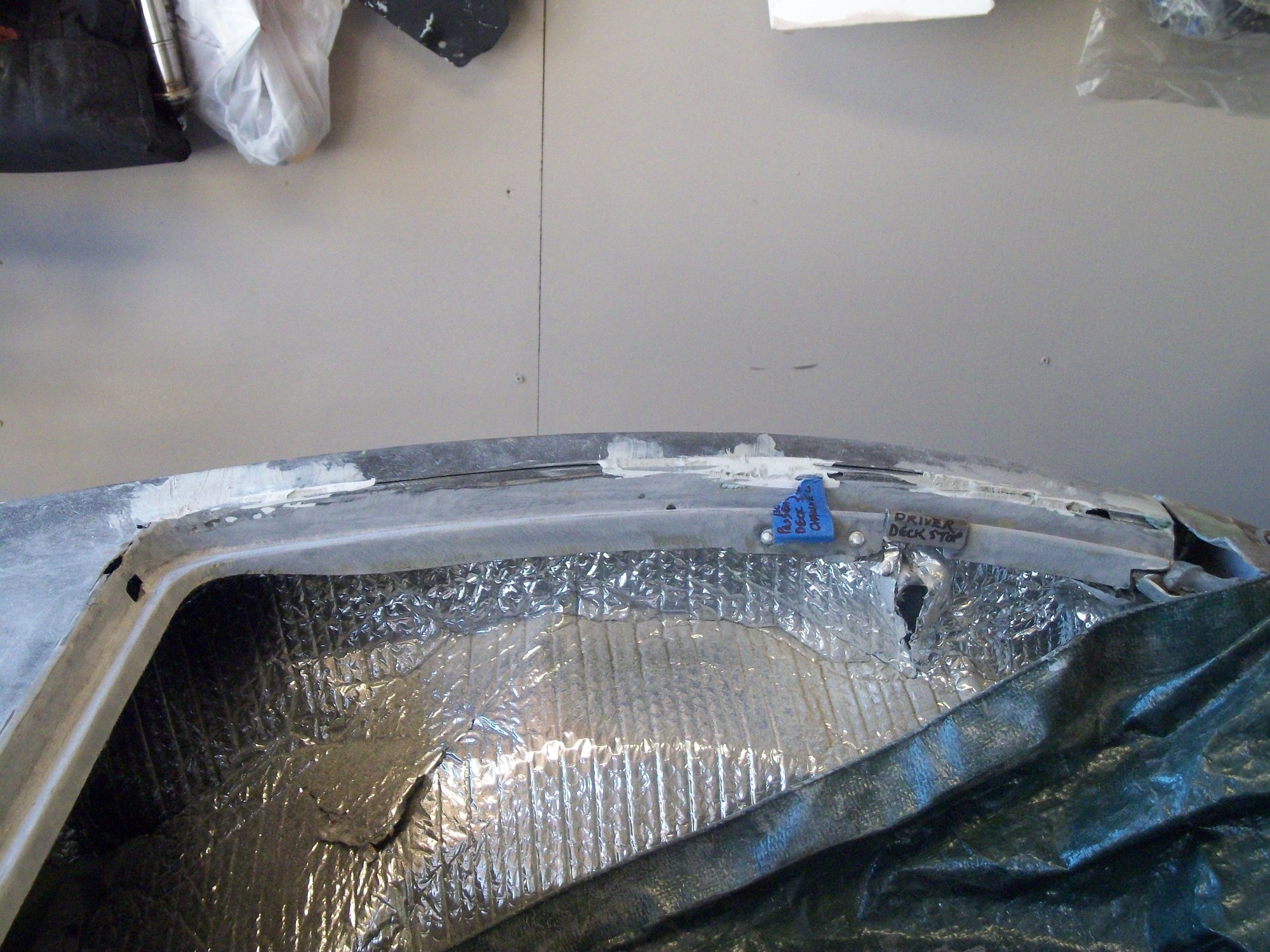

In other news................................I spent a couple hours cleaning the channel in the body that the deck lid sits in. There are some "nice" gouges, so I will clean the underside of the channels and reinforce the whole area............
Before.................................
Passenger-side channel.................................
Passenger-side drain?..................
Across rear of deck.................................... .......
Driver-side channel.........................
Driver-side drain?.................................. ..
Can anyone tell me if the two rectangular holes are drain holes/what are they for?

To Doorgunner's '68 Convertible Project
Old Mar 15, 2018 | 09:04 PM
  #4558
Rescue Rogers's Avatar
Rescue Rogers
Is my vette stock?? HAHA
Joined: Oct 2015
Posts: 20,235
Likes: 9,376
2016 C3 of Year Finalist

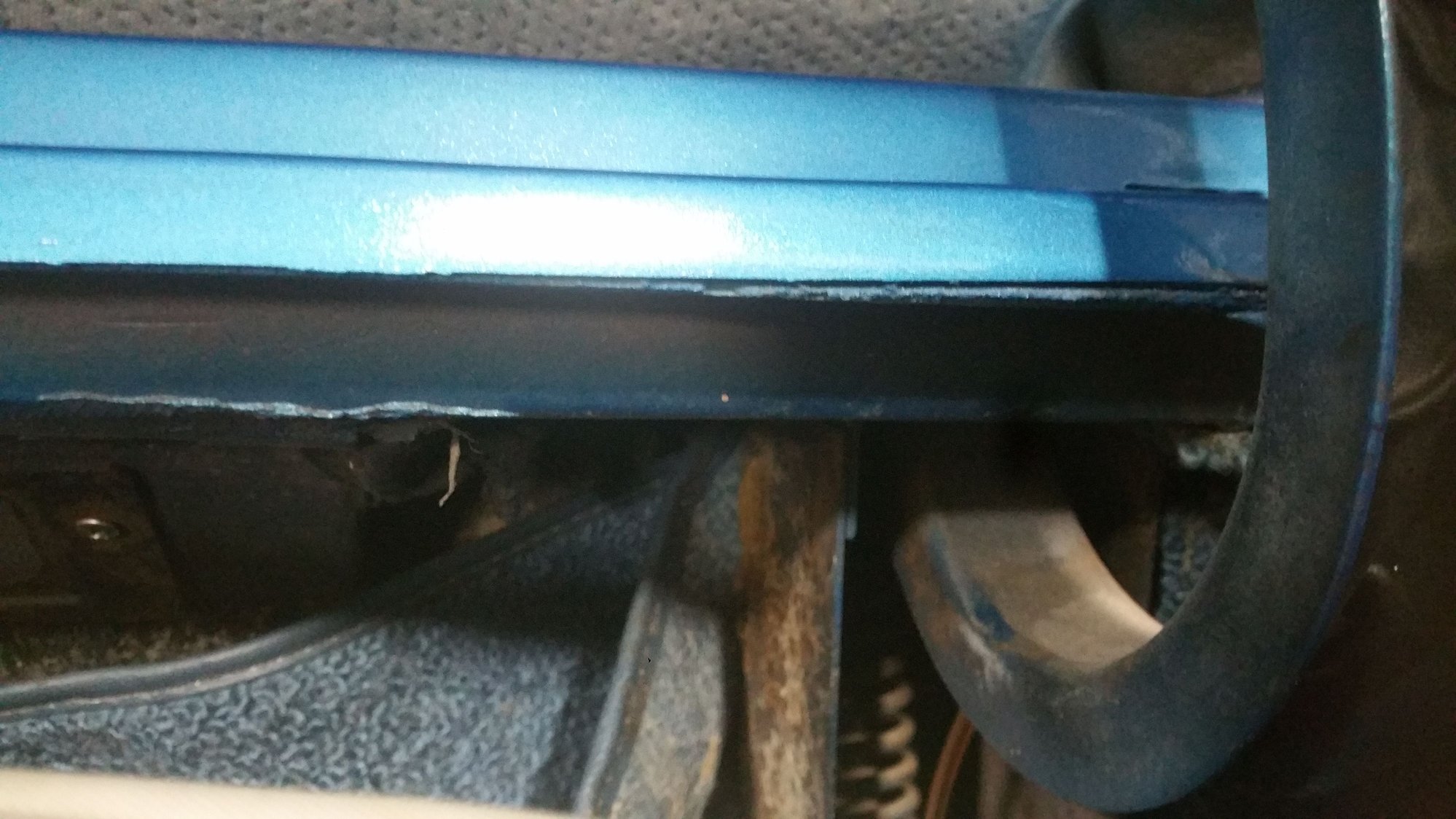

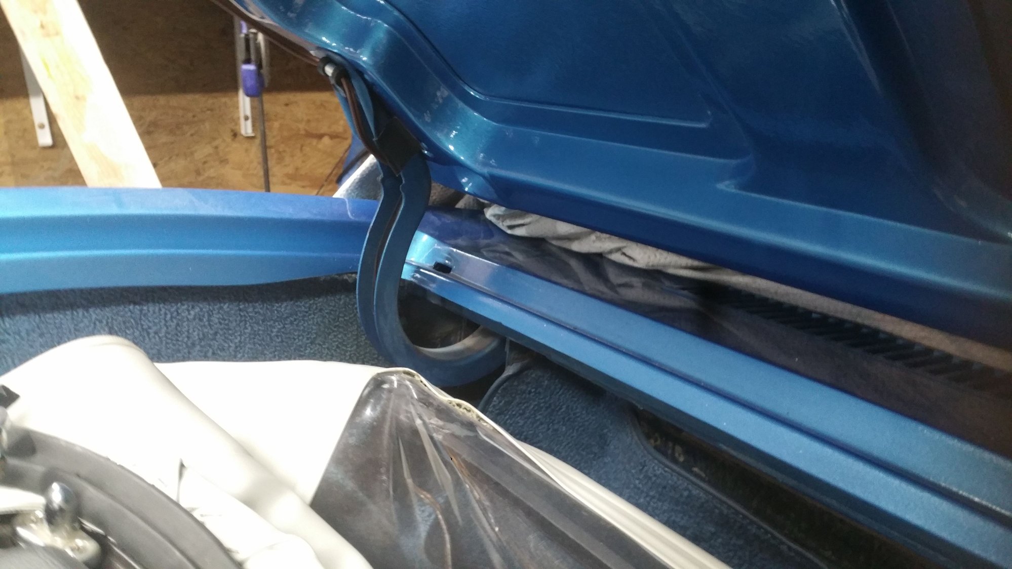

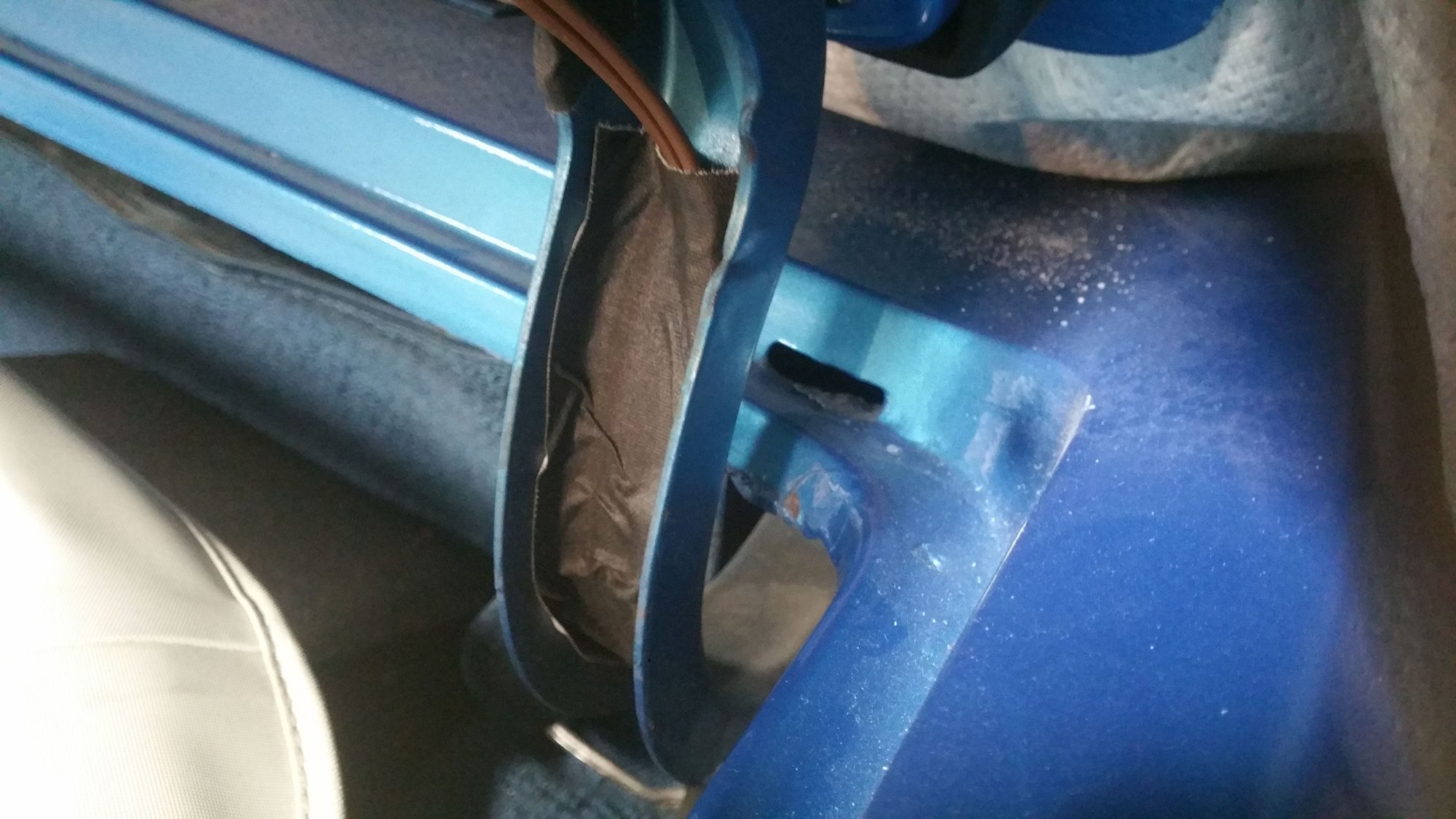

there are holes on both the drivers and passengers sides. They look like they must drain into the rear vents. when the pics show up on my computer I'll post them
Rescue Rogers
Joined: Oct 2015
Posts: 20,235
Likes: 9,376
Old Mar 16, 2018 | 09:41 AM

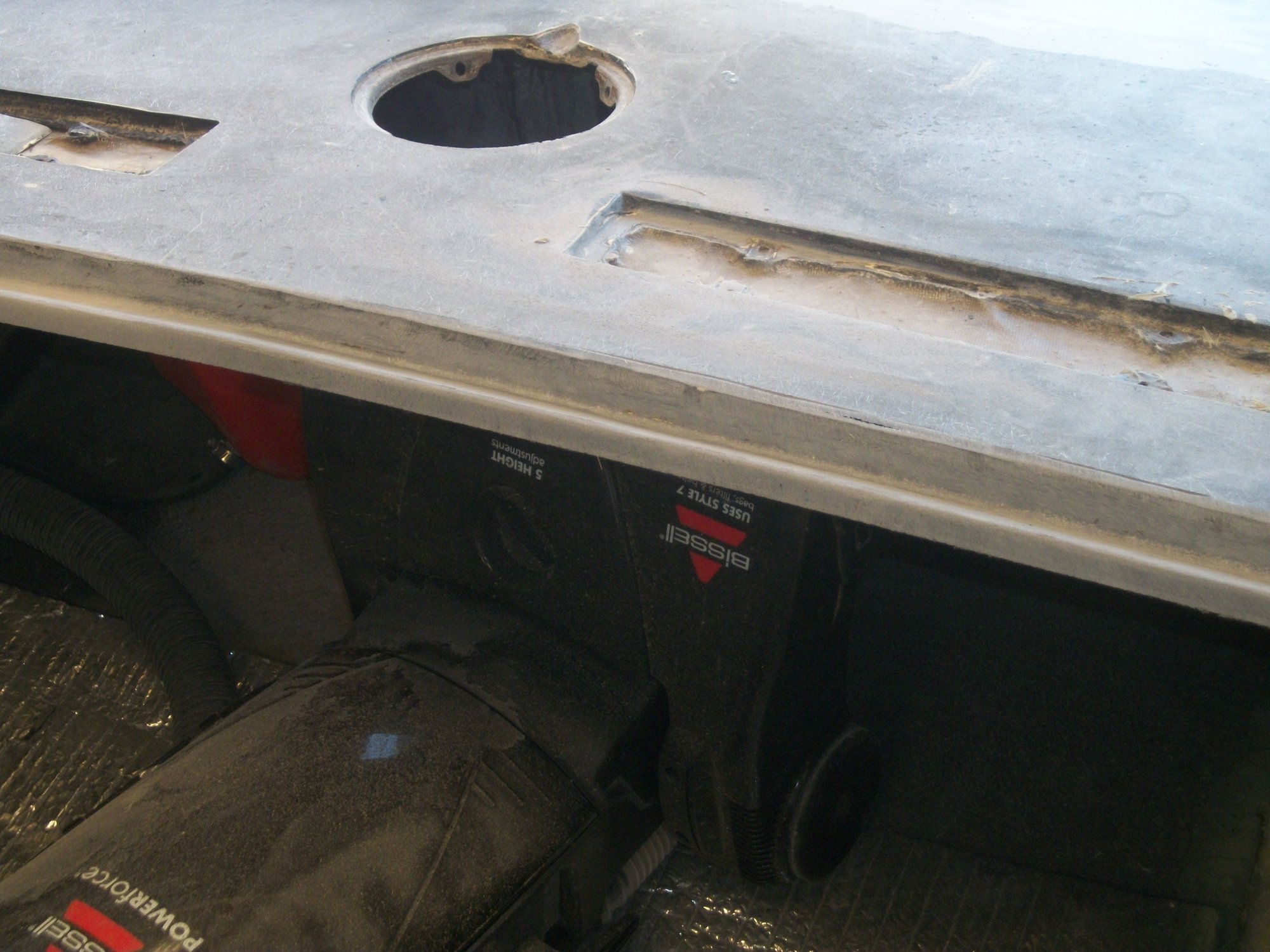

Thanks RR....since the previous ???? broke the driver-side vent off/I also sealed off the astro vents on the top of the deck for the same reason....
I think I will install 1/2" diameter aluminum drain tubes to bypass the original vent/drain design.
I can't remember which member did the tube-modification to all the drains on his car since he didn't want to deal with leaks/rotted rubber drain tubes.
The previous body man wacked off the top radius when he fiberglassed the deck lid in place. The radius on the top rim of the deck channel looks to be approx. a 1/8" radius? What do you think?
