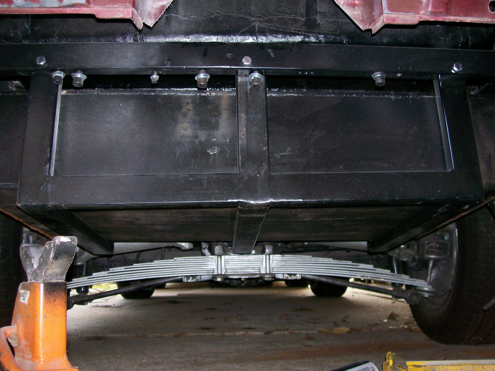

I managed to do a little more tonight.....but being a right-hander, I couldn't grind the welds smooth.....but I did finish the crossbar......
I also managed to drill and install the bolt that holds one of the rear uprights in place..............................

I did just enough today to finish the fitting/installation of the gas tank assembly.....The last bolt hole to support the rear of the cage is drilled....(the shiny bolt head).............
All three uprights are now bolted to the rear crossmember and hold the tank in place...........
Tomorrow I "get" to lower the body back onto the frame......remove the tank assembly so I can drill and fit the tank for fuel lines/etc.
UPDATE:
Filler neck is ready to install in top of tank......
Neck goes through back wall of cargo area / access panel in floor of cargo area.......
Neck is accessible through tail light opening............
Non-vented cap to prevent fuel from spilling on accelleration.......
Tai light "snapped" back into opening.............

Practice/practice/practice..........it took only 5 minutes to drop the tank (add another 5 minutes once all the fuel lines are installed on the tank)........
Grinding dust on everything.......I'll drill/tap holes for the fuel fittings...then clean/repaint the tank.
