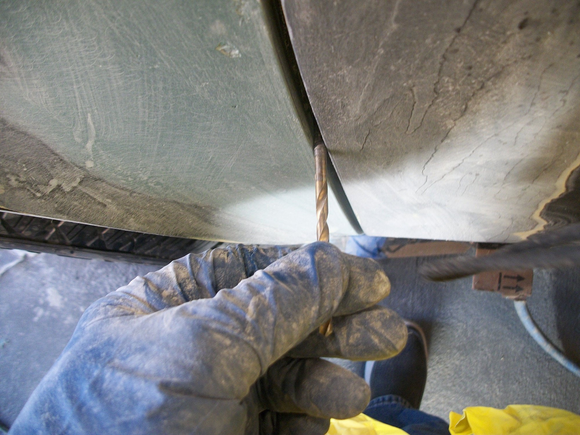

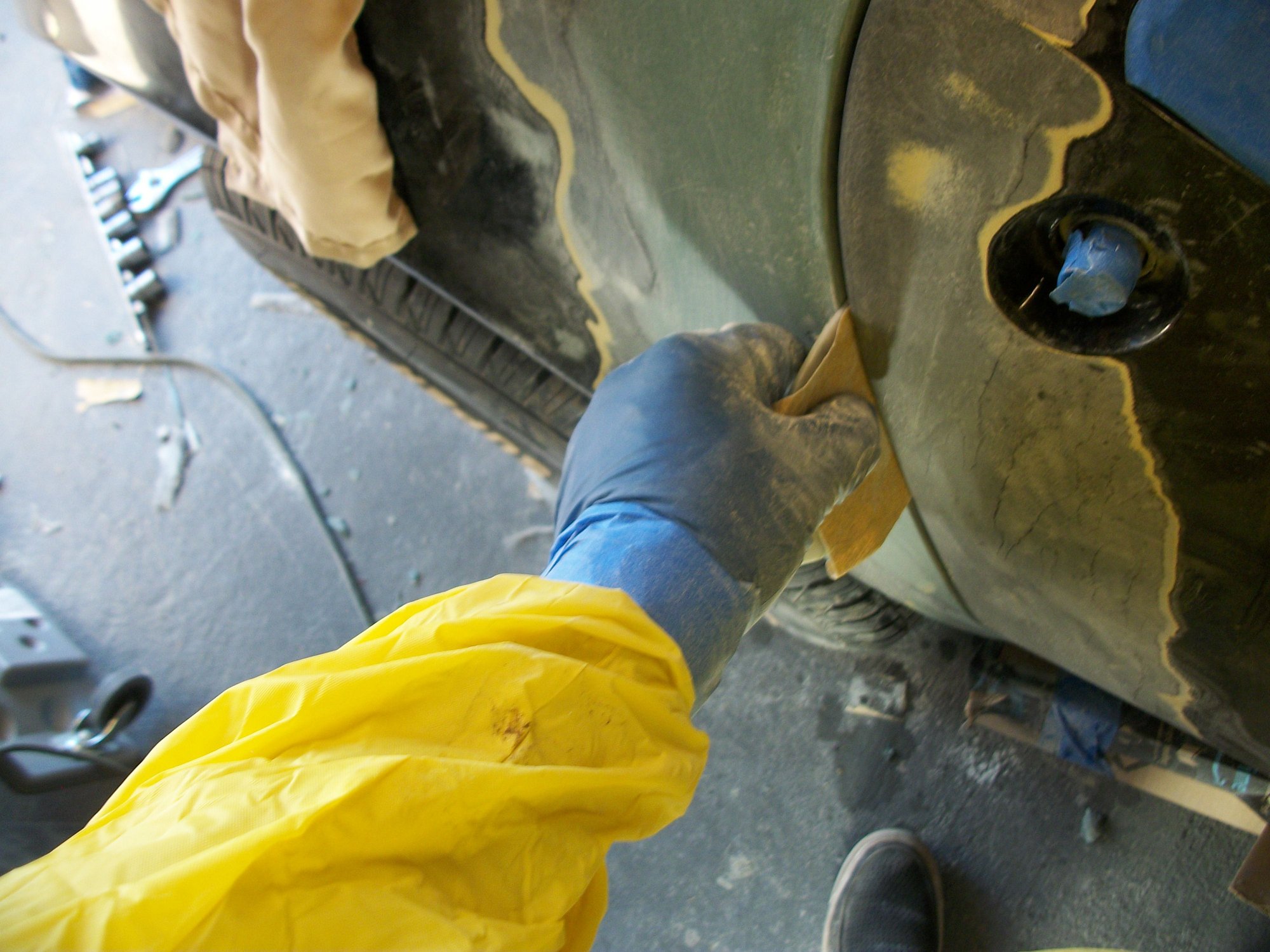

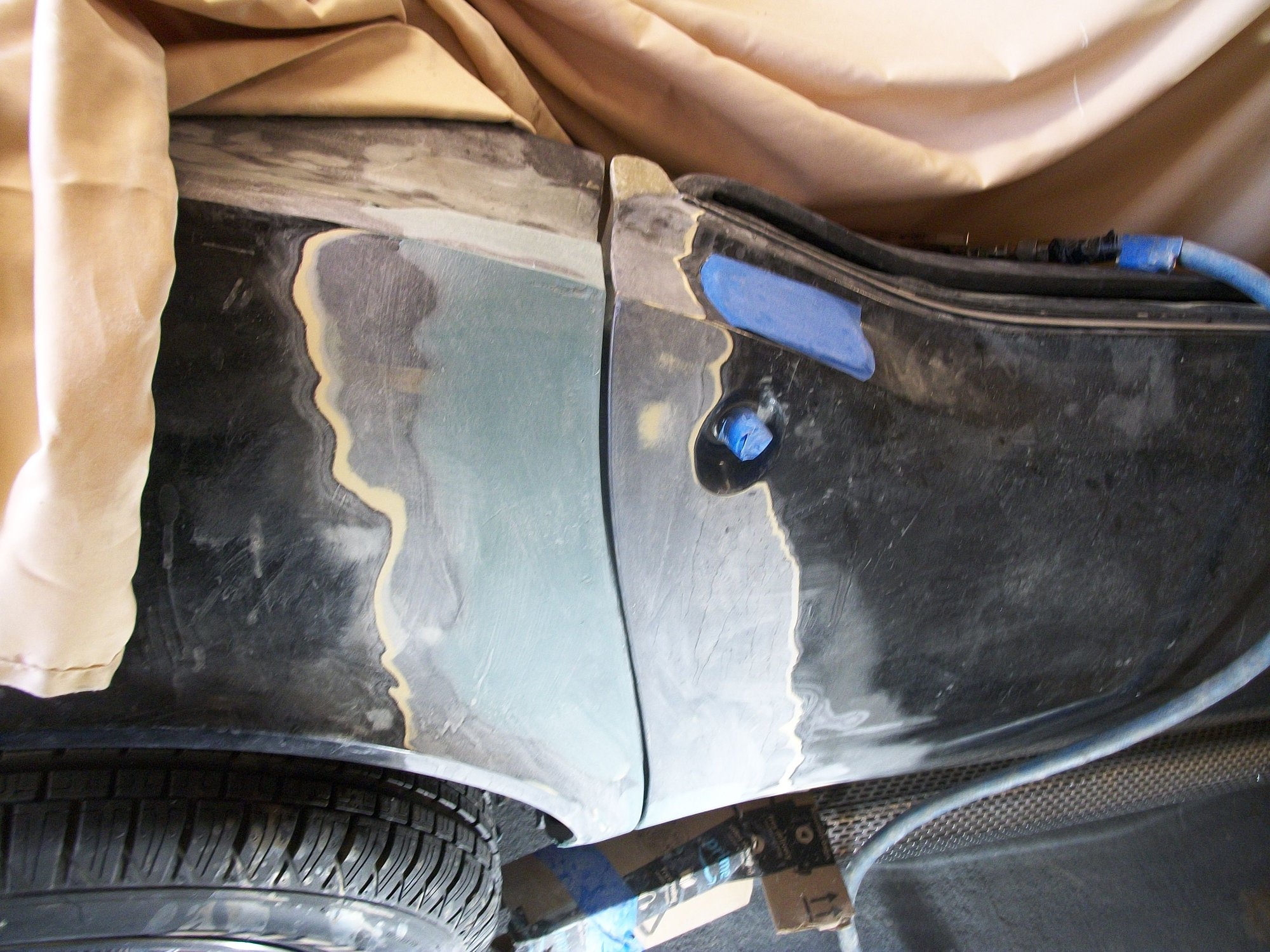

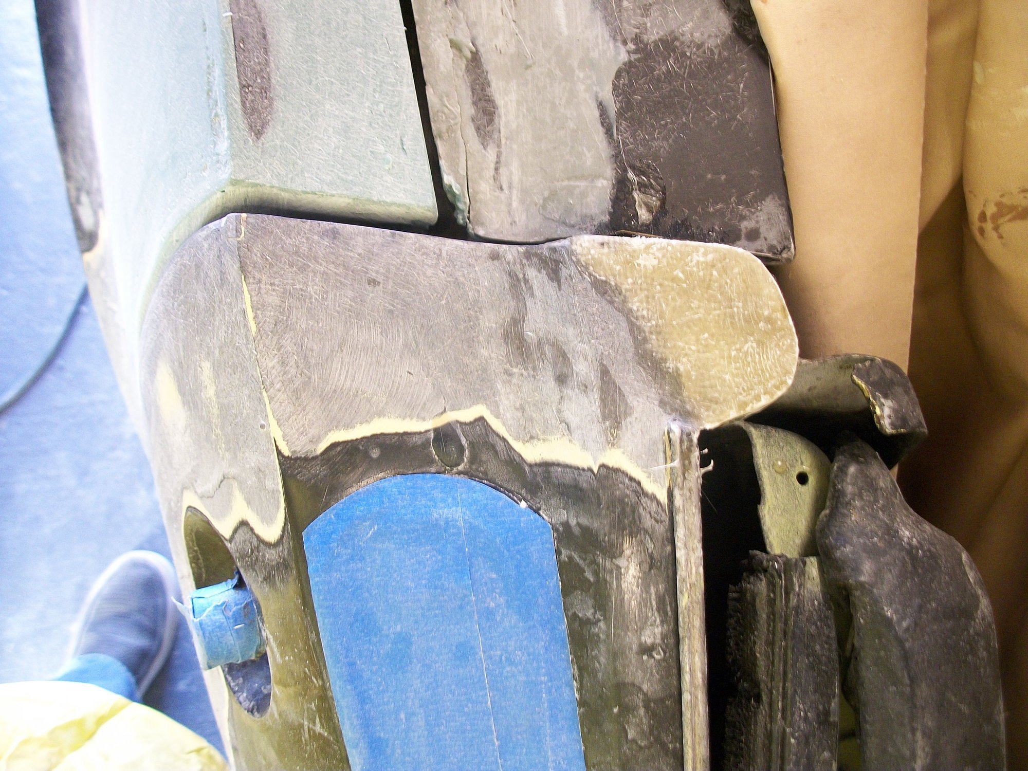

I covered the door tabs with fiberglass mat....it took 5 layers to keep the cloth from showing through. I also used a 3/16" drill (bit) to size the gap and allow for body work/paint.......................
I will shape the tab once the deck lid is repaired.............
Finishing the gap......................
The camera distorts the gap in contours......................
The drill (bit) does not lie.............................
I did the same to the driver door.

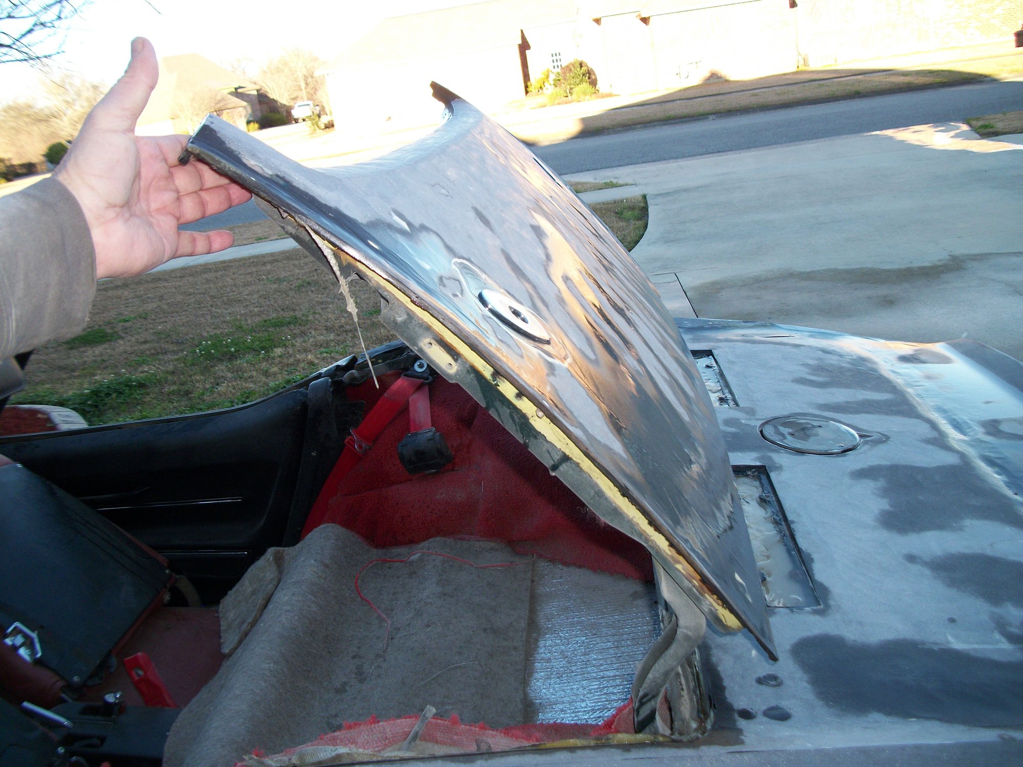

I will be starting on the deck opening and the deck lid Monday where the previous owner fiberglassed it permanently closed (I had to cut it out with a 4" cut-off wheel/didn't go well ................................

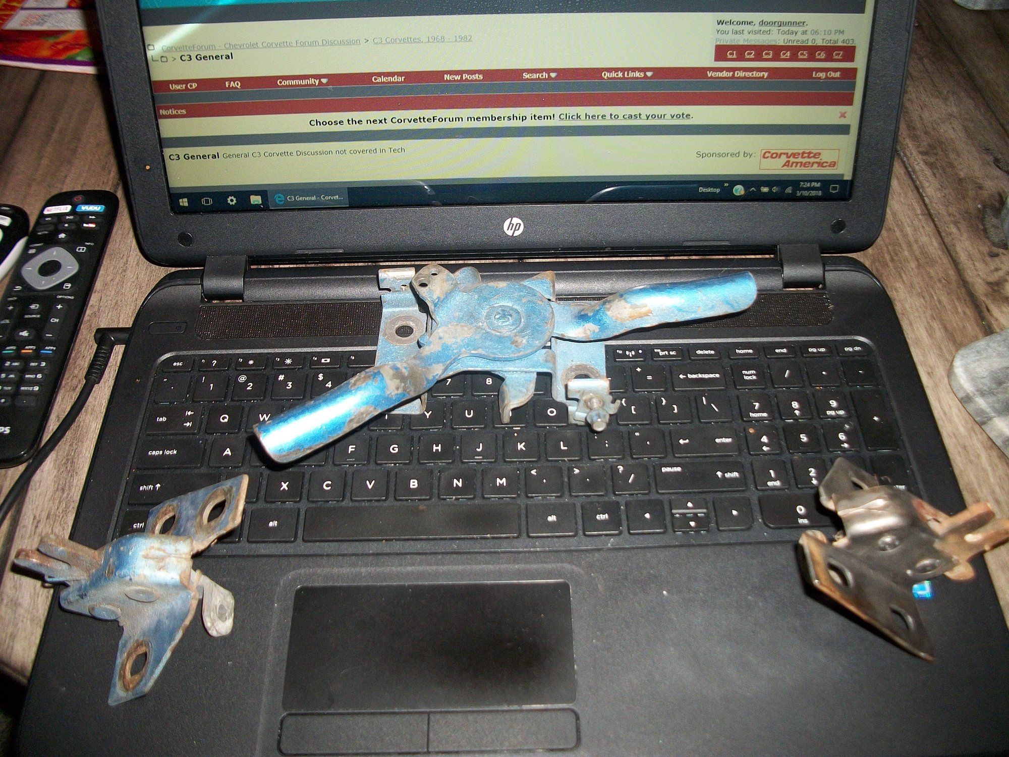

Anyhow, my parts came in 5 days early/just in time for the repair.........

do you have the rods? or are you fabbing them?
They arrived with one cable in very good shape, but I was thinking about fabbing rods and add some anti-rattle bumpers to them.
Which way is better....rods or cables?

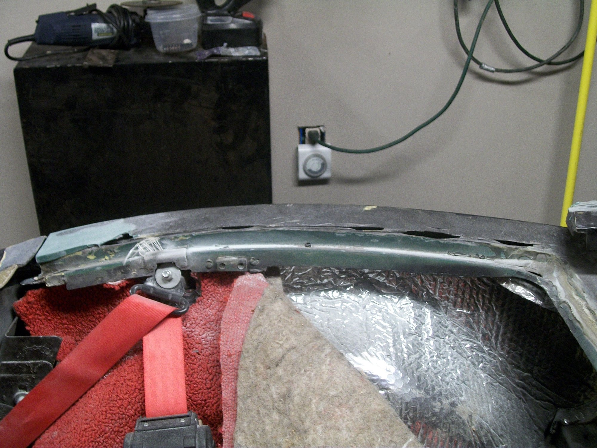

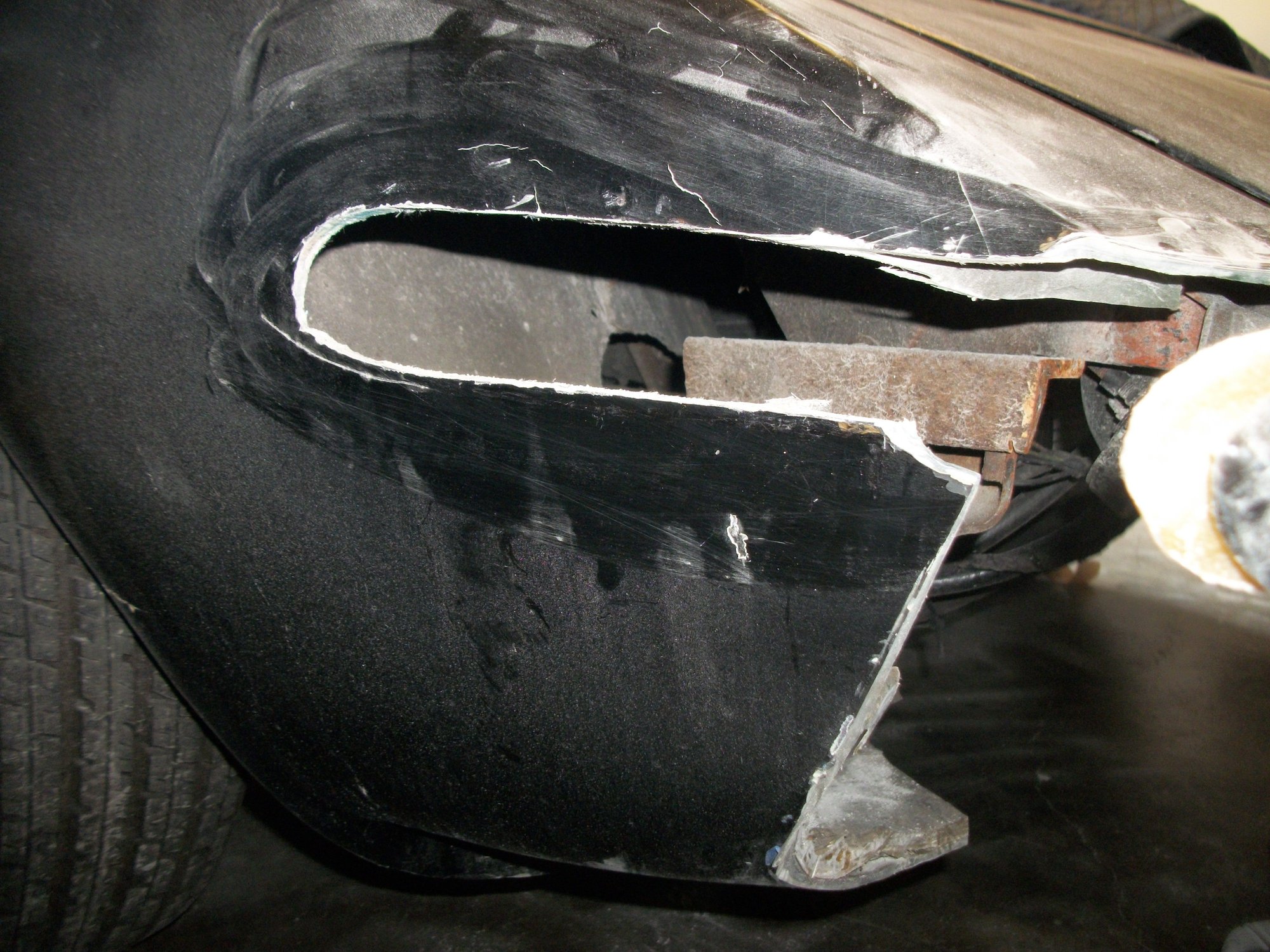

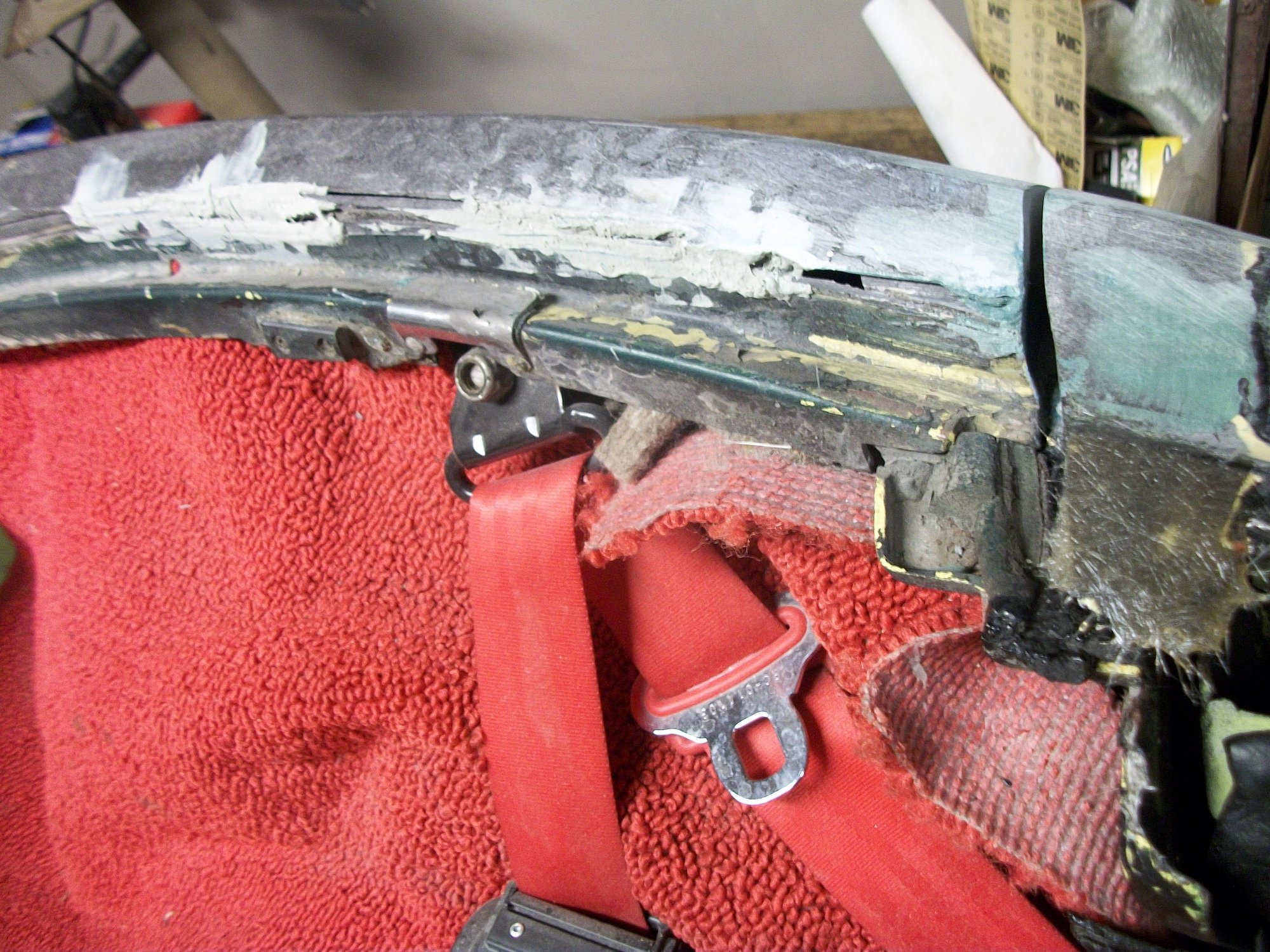

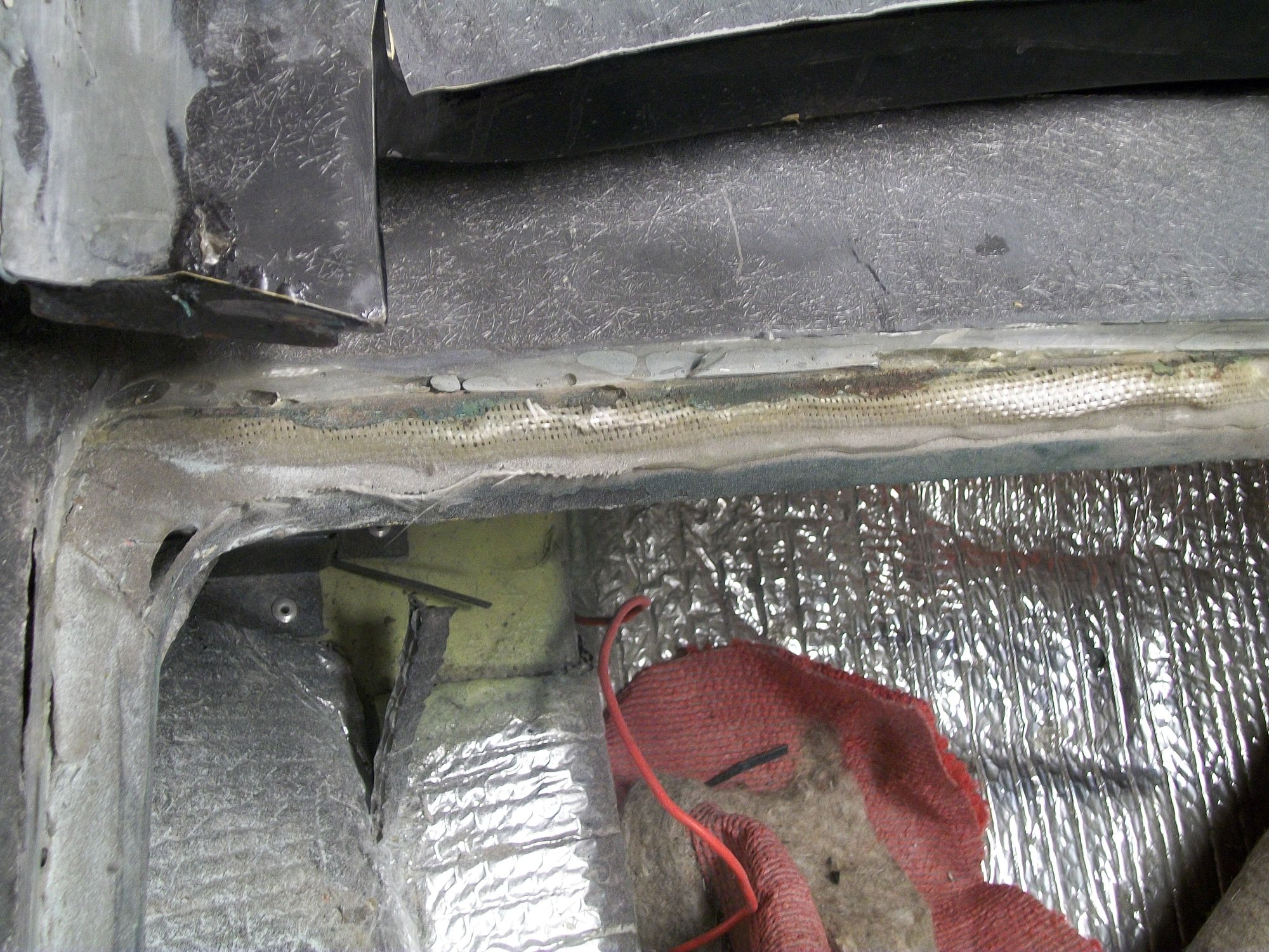

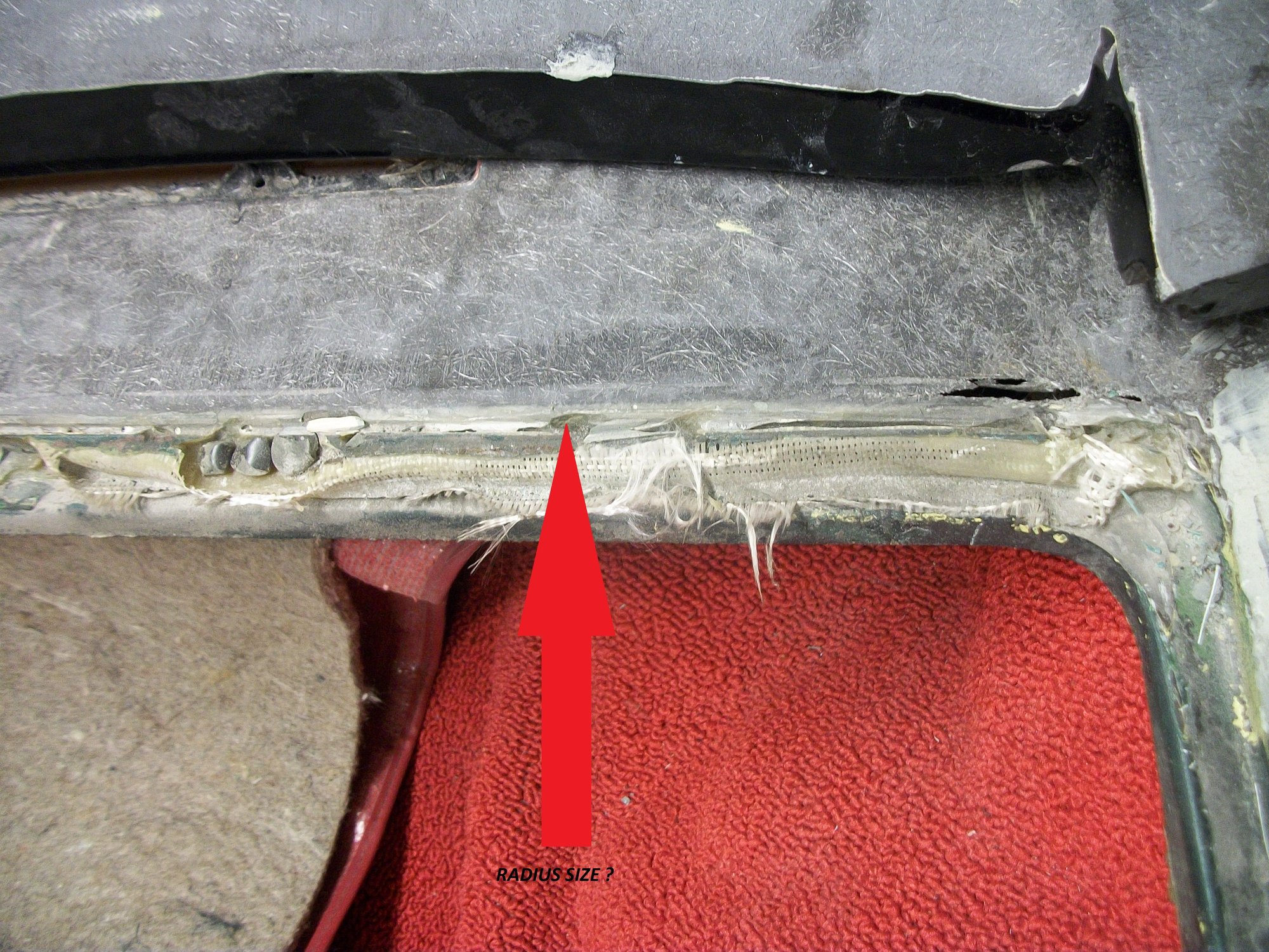

I spent the day in the garage clearing a path around the car. Later I took these pics of my next repair project................
BRACE YOURSELF....this is the area of the deck where the previous owner fiberglassed the deck lid to the body....as you can see I did NOT trace a pattern of the lid onto the deck which would have prevented me from going into the body lip around the opening .........
Driver-side along quarter panel................................... .....
Driver-side rear corner..................................
Passenger-side rear corner..................................
Passenger-side along quarter panel................................... ....
This should be fun.............................
EDIT: Can someone post a few pics of the recessed area where the rubber gasket seats into the deck? Also....can you tell me the radius size (example: 1/4"...5/16"...3/8"...etc.)where the recess meets the top pf the deck?

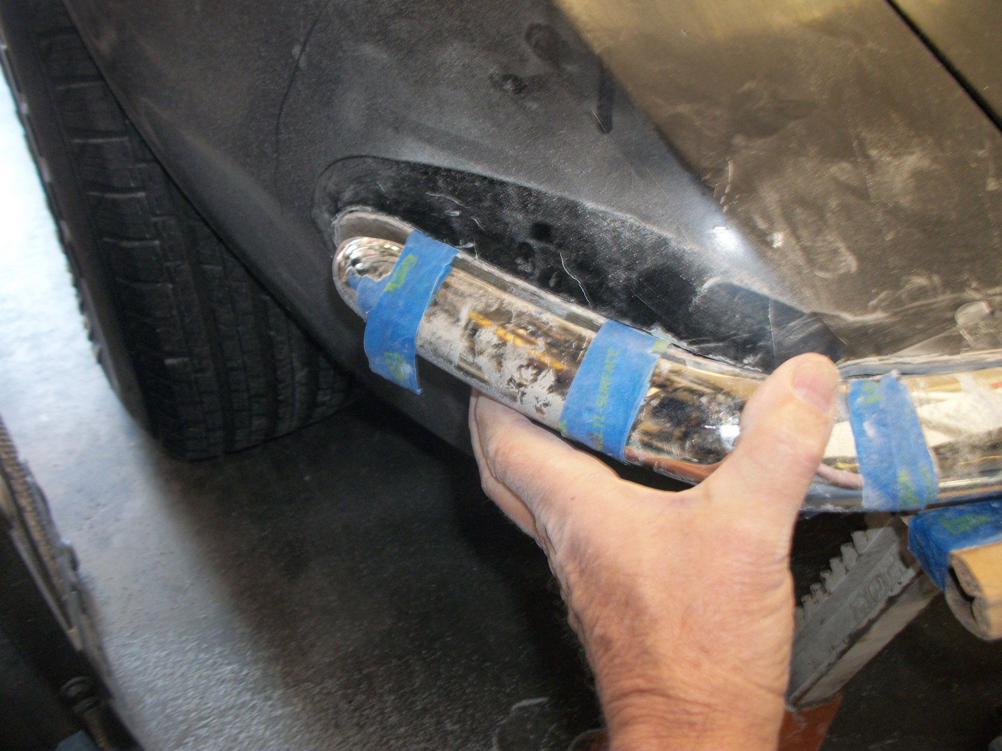

And speaking of assembling things before paint. In one thread a guy put a nose on his car. Then he put the bumper on and the bumper was about a half-inch out in front of the nose. And he had to cut and adapt every single one of his bumper brackets. Might be an idea when doing the nose alterations on yours, to hang the bumper ahead of time and see where everything goes. Maybe even scare up a straight used bumper so that you're not mounting and dismounting your new one constantly and putting it at risk.
Good idea. Hopefully the bumper will be 1/2" too close to the body which would make up for the 3/4" gap at the doors/fenders.....LOL
Of course I DO have plenty of adjustment.........(notice the nice P.O. angle iron bracket and the 1/2" thick fiberglass at the bottom of the fender).......
Those fiberglass reinforcements you sent me that fit behind the bumper practically snap into place.....a little more sanding and they will be flush.........
Well....out to the garage to add some siding to the addition........and grind some doo-doo out of the deck lid recess.
