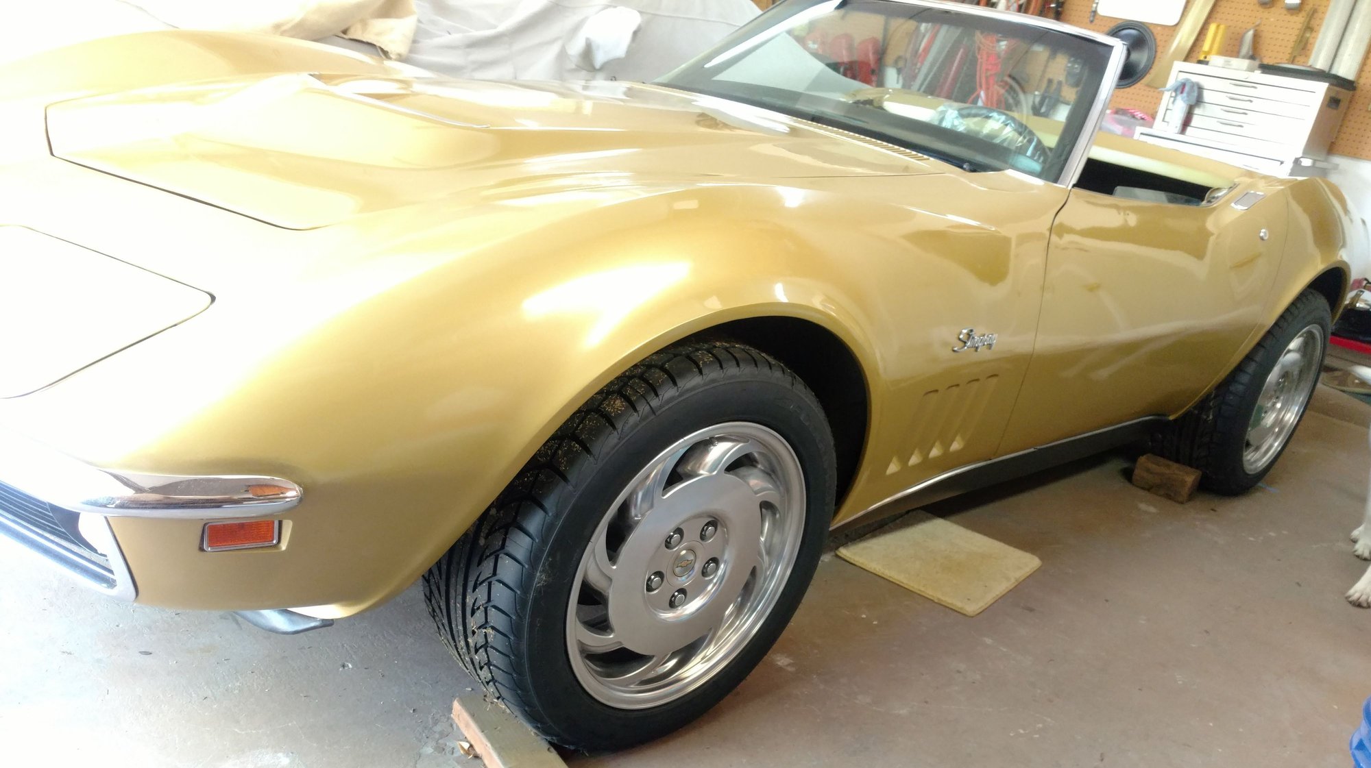

these are C4 - 17" Dia. 9.5" width rims, 10.5" wide tires, they will fit.
minor grinding on brake bracket, not relocated.
