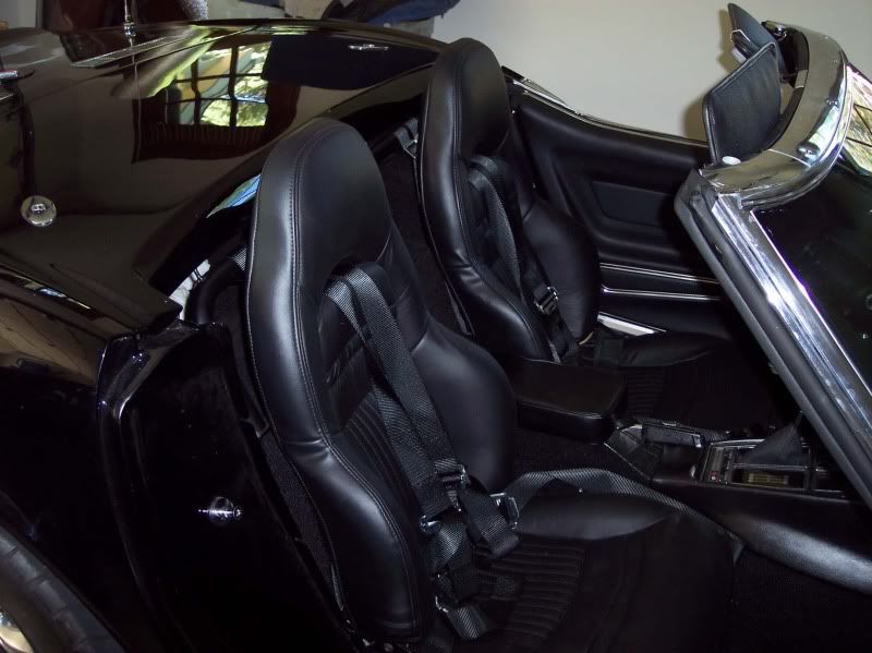

1979-82 seats in my '77. At 6'4" I too cut the drivers side floorboard as far as it would go (touches the frame).
Old Mar 5, 2014 | 11:45 AM
jetmech's Avatar
jetmech
Joined: Oct 2001
Posts: 420
Likes: 11
From: tuttle ok
They look great! Sometimes you just gotta do what ya gotta do!!! I am glad to see someone other than myself had the same idea!
What did you do about the lap belt retractor pocket though?
Old Mar 5, 2014 | 07:29 PM
  #35
parkerracing's Avatar
parkerracing
Joined: Sep 2003
Posts: 4,206
Likes: 8
From: Belmar NJ
The floor was cut about 2" up the sides and a patch panel was welded all the way around.
