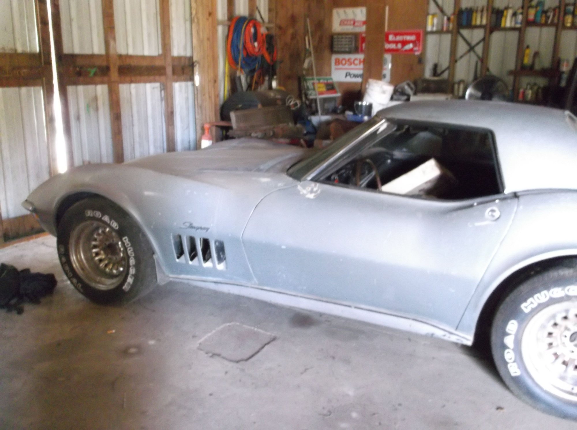

What's wrong with it: What is it? I've been kicked to the ground for calling it a Stingray by several posters on this site.
It's not in awful shape, but it needs work, everywhere. It sat out in the weather for a few years, but has been under cover for the last 15 years. No body damage, just looks like old fiberglass, or old paint. Seats look decent, but other interior needs replaced.
What's my goal: To eventually restore it. I'm not on any timeline.
What's my budget: At this moment, I need to start small. My roof needs replaced, so that's my first priority. I have a new rag-top, other new parts. My question...can I start doing "something". Pull out the seats, pull the motor, what???

Does this work?

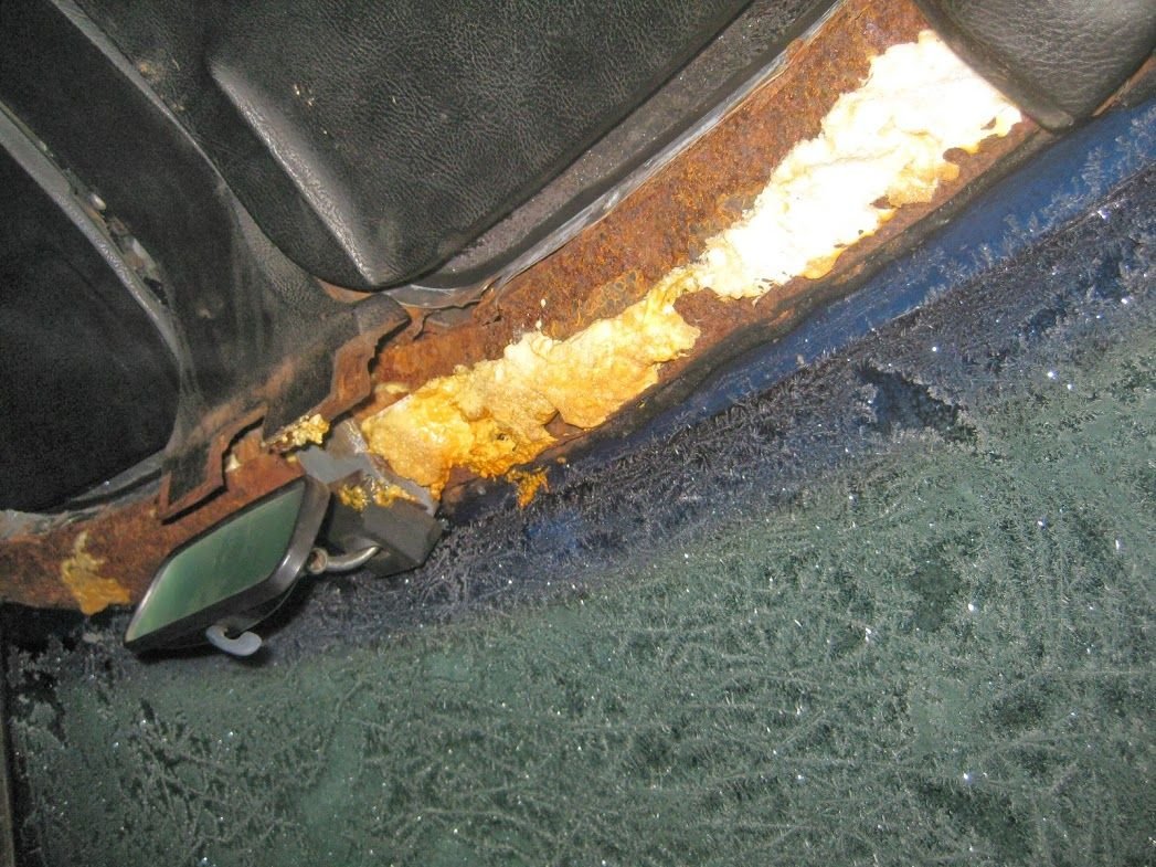

It sat outside for a few years? How wet are the carpets? Does it have any water leaks?
The C3s were assembled with typical american tolerances. Ie, give or take a foot. So they're known to leak. The problem with that is that they DO RUST. There's a metal frame hiding under the fiberglass around the passenger compartment. So before you sink any money into it- even before you start getting the motor, brakes and all that others stuff I said in my last post, please remove the interior windshield trim, and the kick panels. You're looking for rust. Post pics if you want an opinion on it.
Replacing the birdcage - that's the nickname for the sheetmetal structure under the fiberglass in the cockpit - is NOT a cheap or easy thing to do.
I know this because I'm doing it now on my '73.
This is what I found under the windshield header on mine:
And, if the birdcage is rusty... check the frame too. Thoroughly. This was hiding underneath years of undercoating. I put my HAND through it with little effort. I was actually rolling under the car on my creeper when it happened, I was pushing myself from one side to the other and grabbed the frame to pull myself out.
Your car looks a lot nicer than mine, and I'm really not trying to scare you away - but it 's best to check these things before spending the first dollar.

No.
We need more.
I do see the reason you have this issue. Someone wanted it more like a '69 and put the '69-up Stingray emblem on it and the '69 rocker panels under the door. It could be they put the panels one because they were cheap and easy to find or to update the look.
No big deal unless you are after the restored original look.

The silver often gets a dull look, or at least has the 1/8 inch deep look to it, instead of the 10 foot deep look with colors like black and dark blue. It is just the nature of silver, so wax it, buff it maybe, and don't worry right now, since paint will run you $5000 to $10,000 and you can use the money for better things right now with it.
