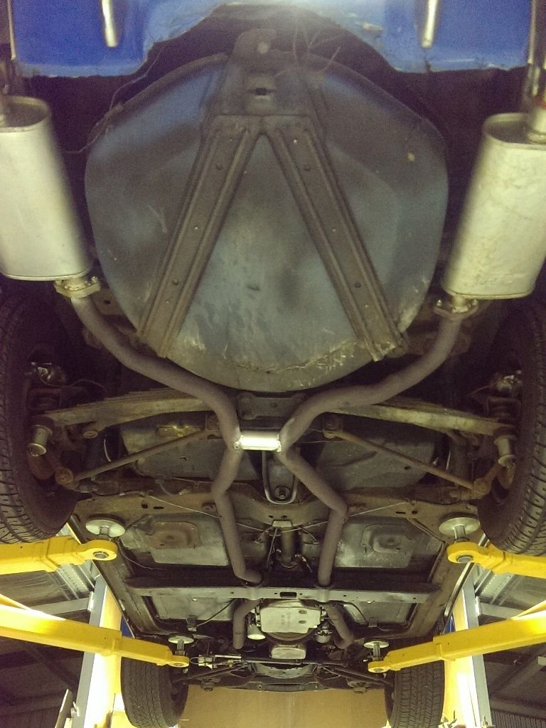

The chassis seems to be fairly rust free. It looks to have been a California car. Also all the oil leaks from the 400 motor, power steering and Turbo 400 trans have rust proofed the underside.

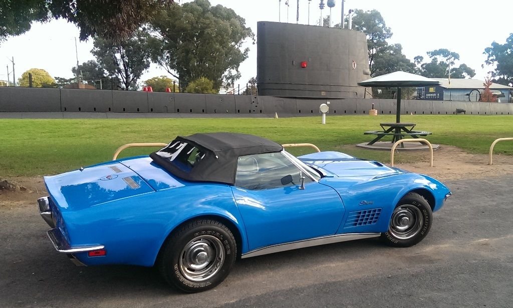

Here it is on the trip home

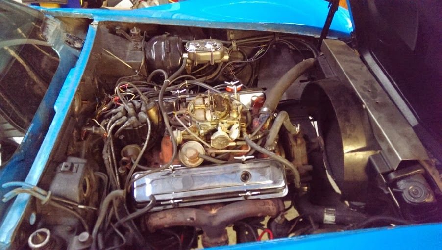

The engine bay. Oh dear...
The Underside

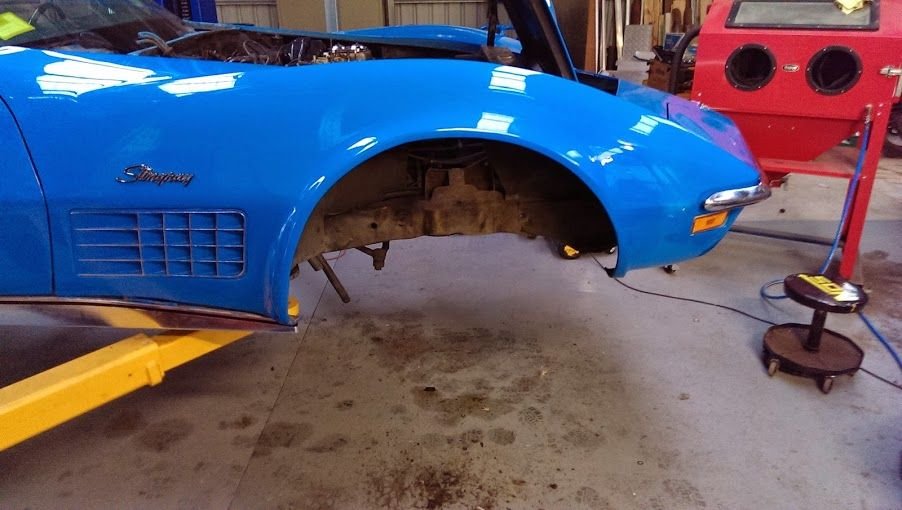

The Front suspension is out while I clean up the engine bay. The front cross member needs some work.
The engine bay needs a fair bit of work.
The trans is out now and Most of the wiring. There were so many cut and joined wires and taped up connections. It's a real mess. I reckon I'll start from scratch in the engine bay and modernize the wiring a bit.

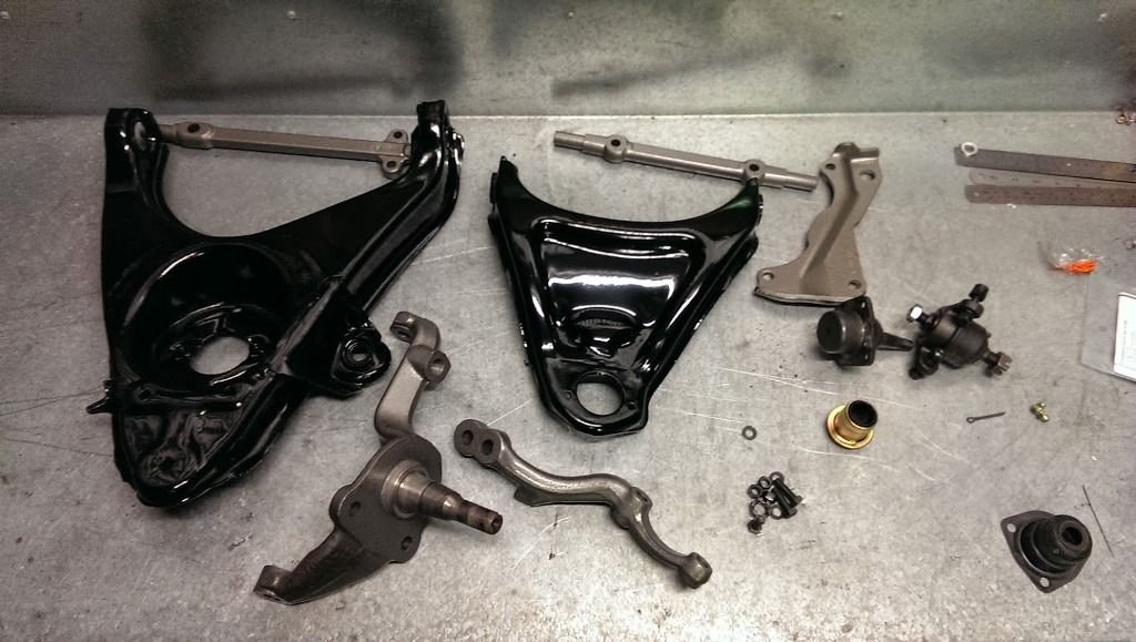

I've sand blasted and repainted a lot of the front end parts ready to go back in.

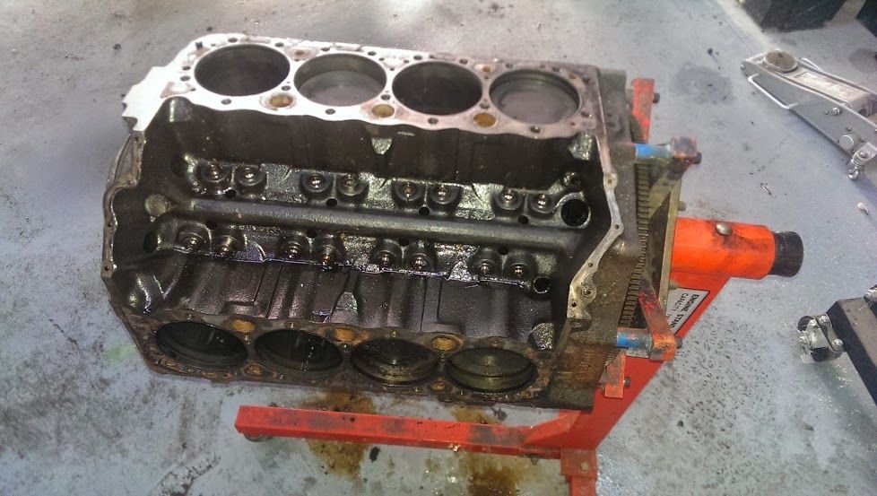

I've been tearing down the motor to get it ready to go to the machinist.
It looks like it's still on the standard bore size. It's a 4 bolt mains motor. The plan is to get the block hot tanked and crack tested. Then we'll see if the mains need align honing. Bore the block for new pistons, Deck the block to the top of the pistons. Thrown in a set of hyperutectic or forged pistons and some 6" rods. Still not sure whether I'll reuse the crank, it'll depend on whether it needs grinding or just a polish.
