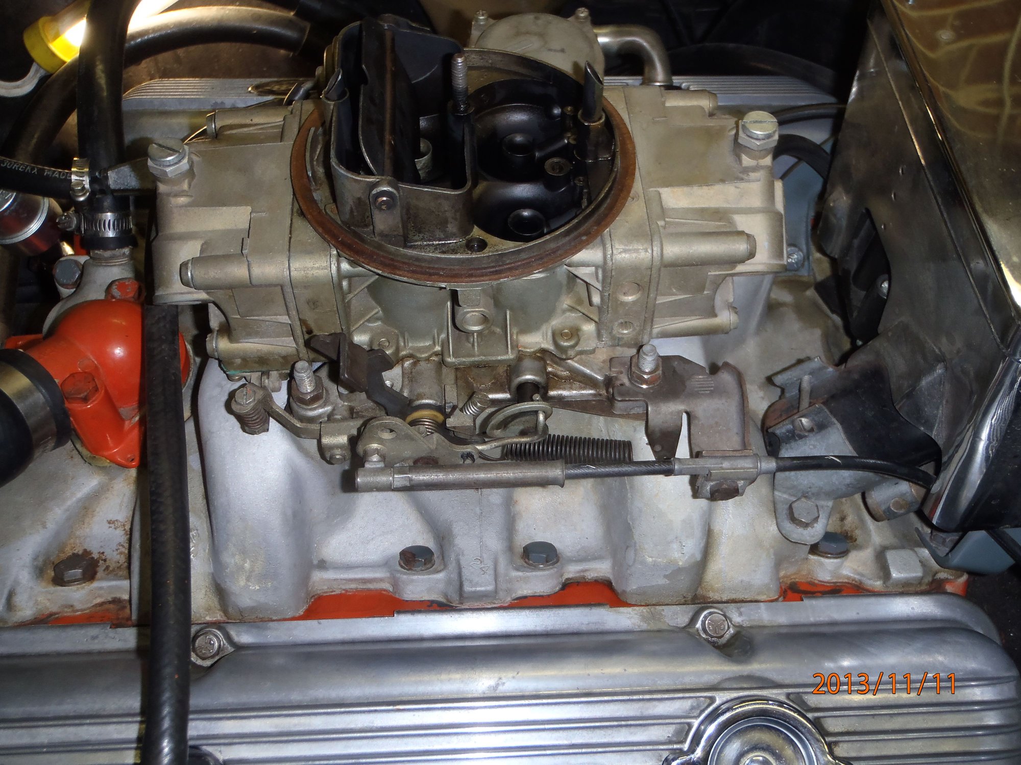

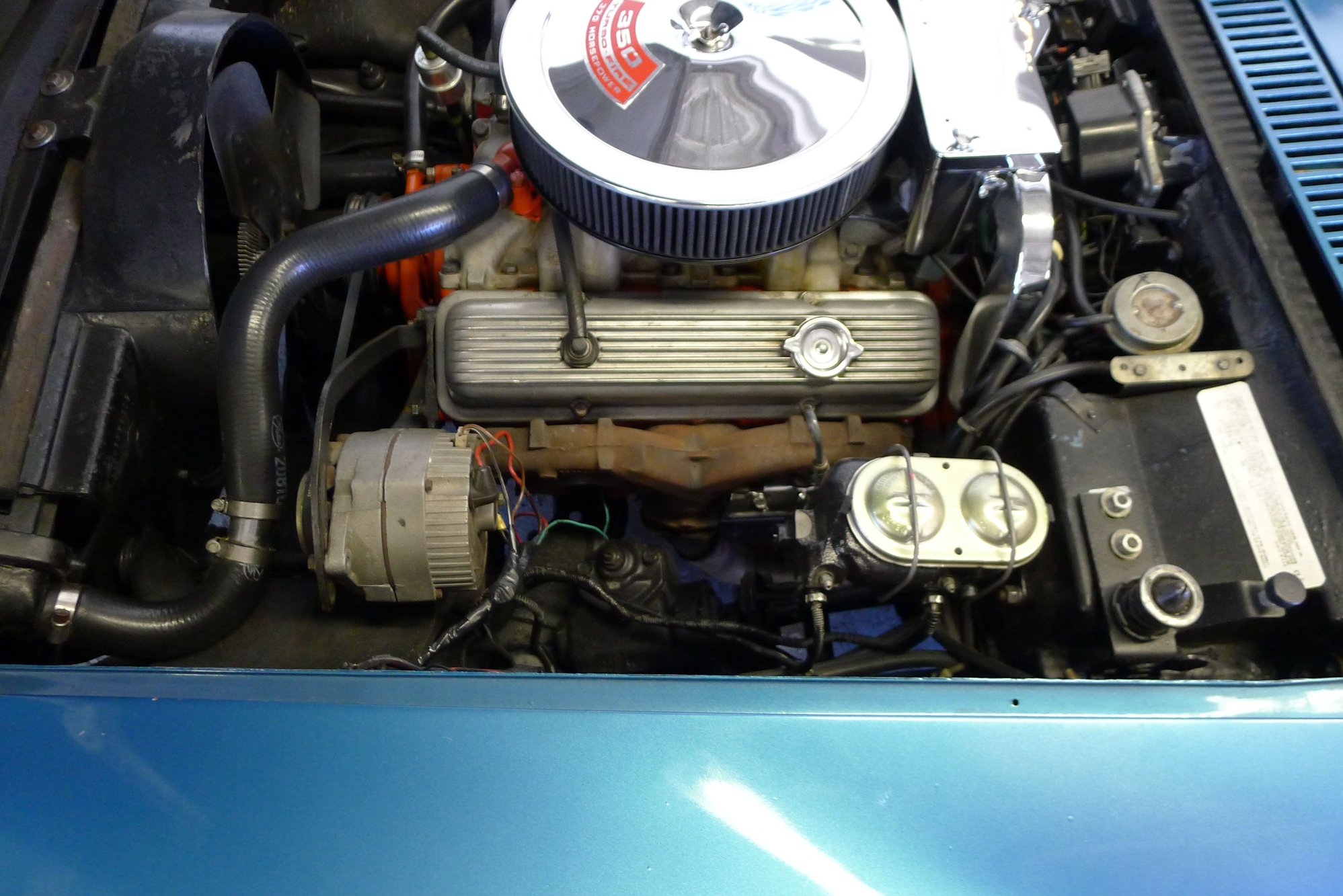

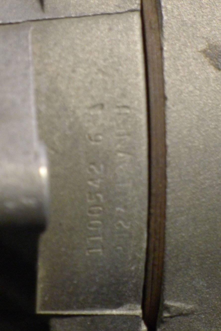

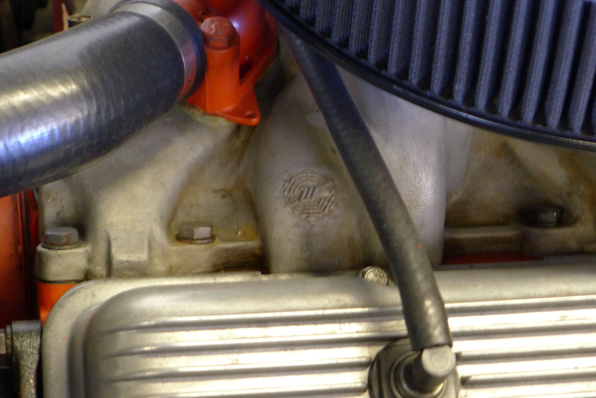

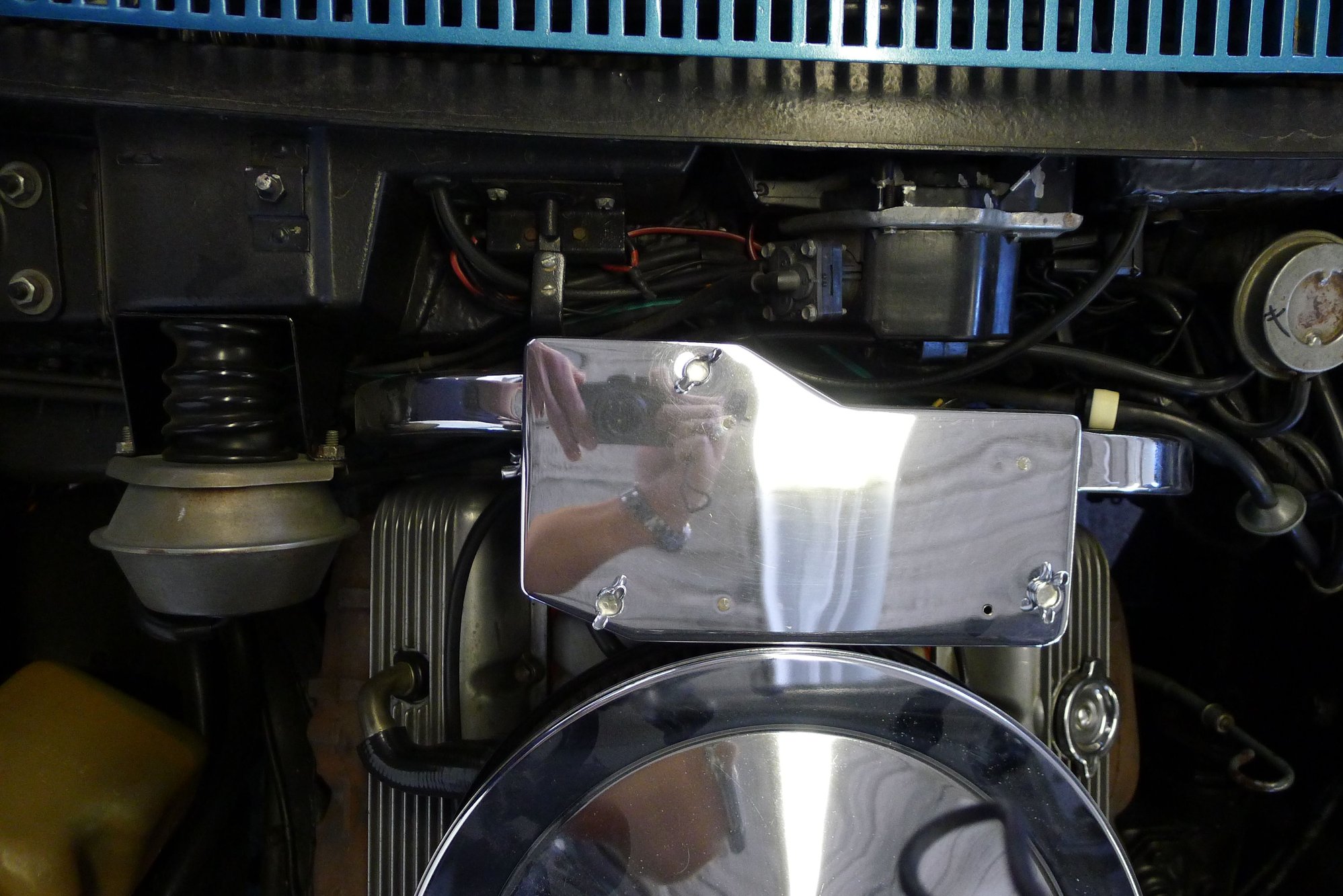

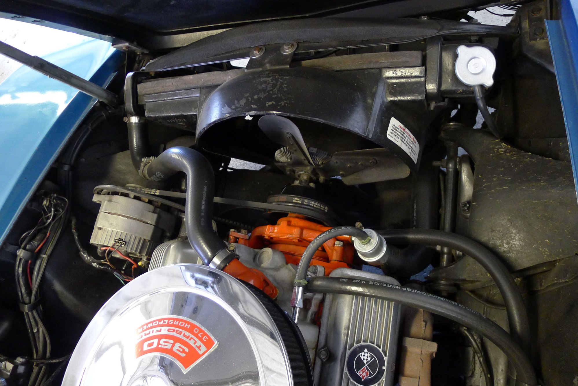

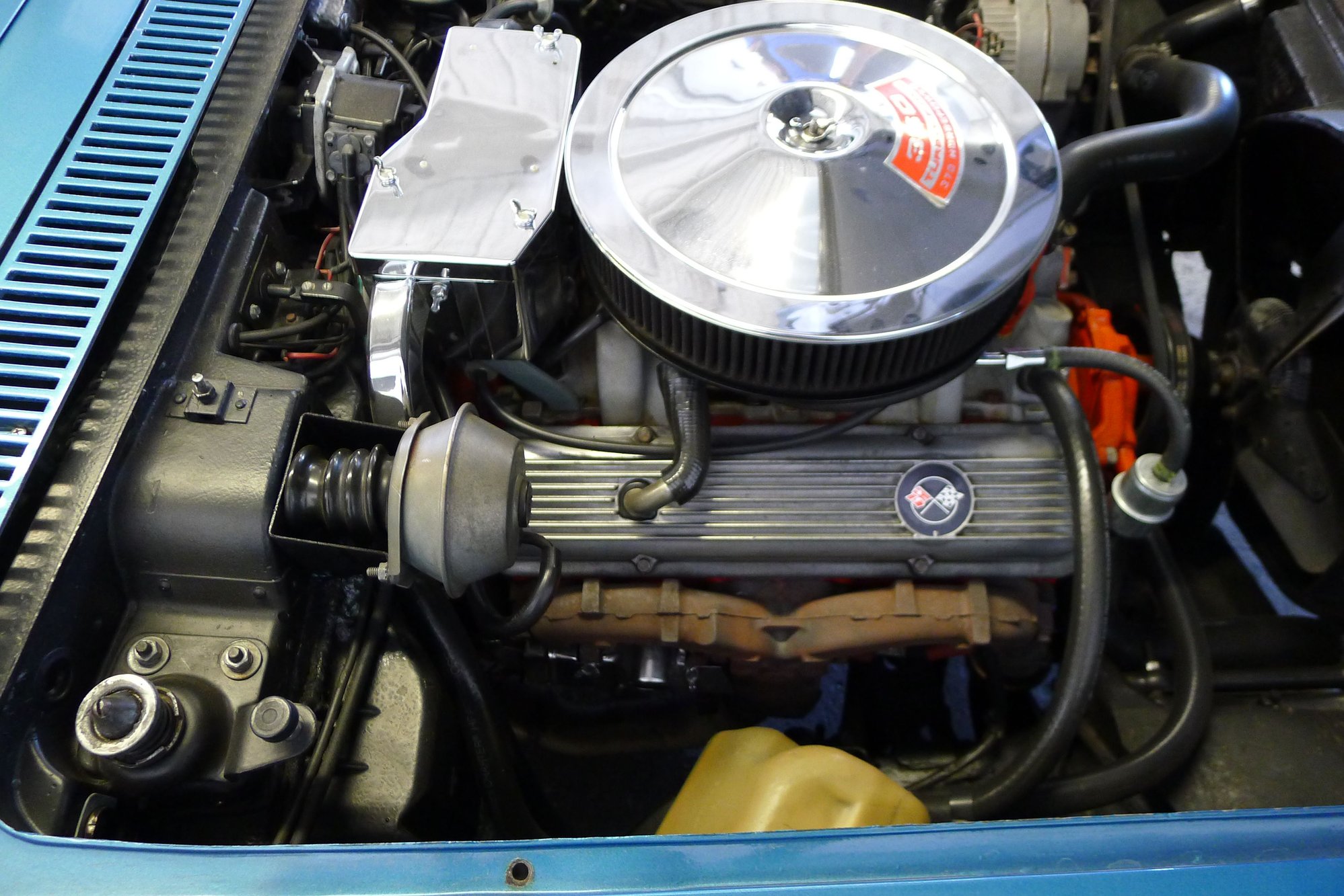

Hey Mike,
Yes, the car has the original engine with proper stampings. Also has the original carb, intake manifolds, radiator and transmission. The non-original items are:
1. Alternator. If anyone has one, I'd love to purchase it (6 Amp 1100884 from Sept 69 - March 70)
2. Starter - no visible stampings
3. AIRS (smog device removed). Again, would be happy to purchase one if anyone has
Here are pics I took of the bay:

Bruno,
You are going to need the correct metal fuel line from fuel pump to carburetor also.

Wonder why the LT-1 would require the 884 Alternator?? It does not have Air. Would think it would take the 1100 900
Hmmm

Good question. I went by the NCRS judging book. That was was listed. "All A/C cars, LS5's and LT1's"

Thanks!
I'm becoming obsessed with these details. For now I'm going to drive and enjoy the car. Eventually get all the bits together.

I believe the more powerful alternator was required for the TI (transistor ignition)
Originally Posted by Bruno Vendittelli
Thanks!
The rubber fuel line is a serious fire hazard. I wouldn't drive it as-is.

Wow! OK, I'll fix that. Where can I locate the proper metal fuel line. It's at the mechanics right now so I'll have them repair it.

any corvette vendor will have a fuel line
Corvette Central in michigan,Corvette depot in Windsor just to name a few

Thanks for the tip. Ordered a steel fuel line (pump to carb) and will install. What does WGAF numbers mean?
