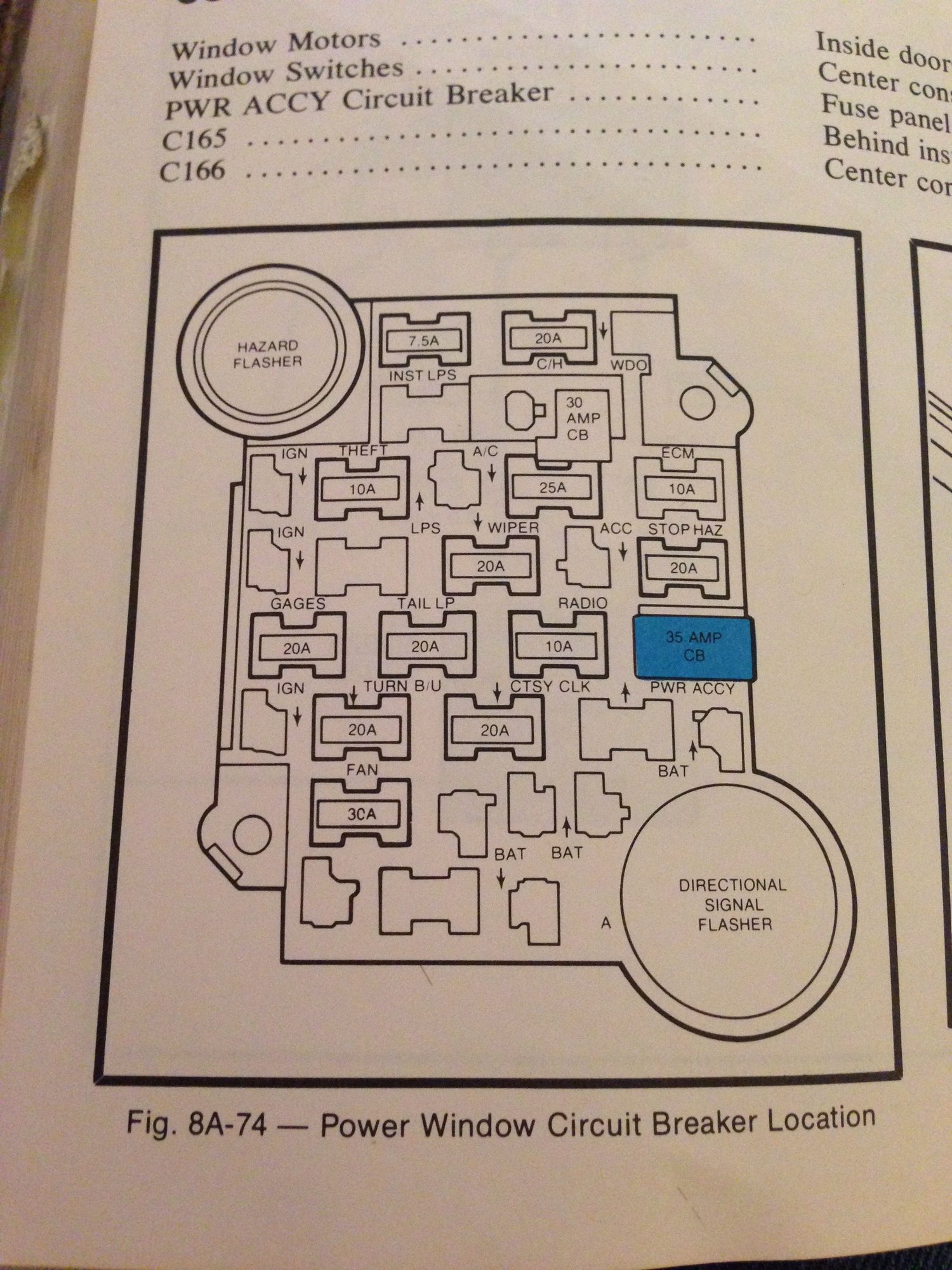

larryg3's Avatar
larryg3
Joined: Apr 2008
Posts: 1,992
Likes: 56
From: Antioch IL
for the power windows it is a 35 Amp circuit see below
for the Power door lock switches it is
