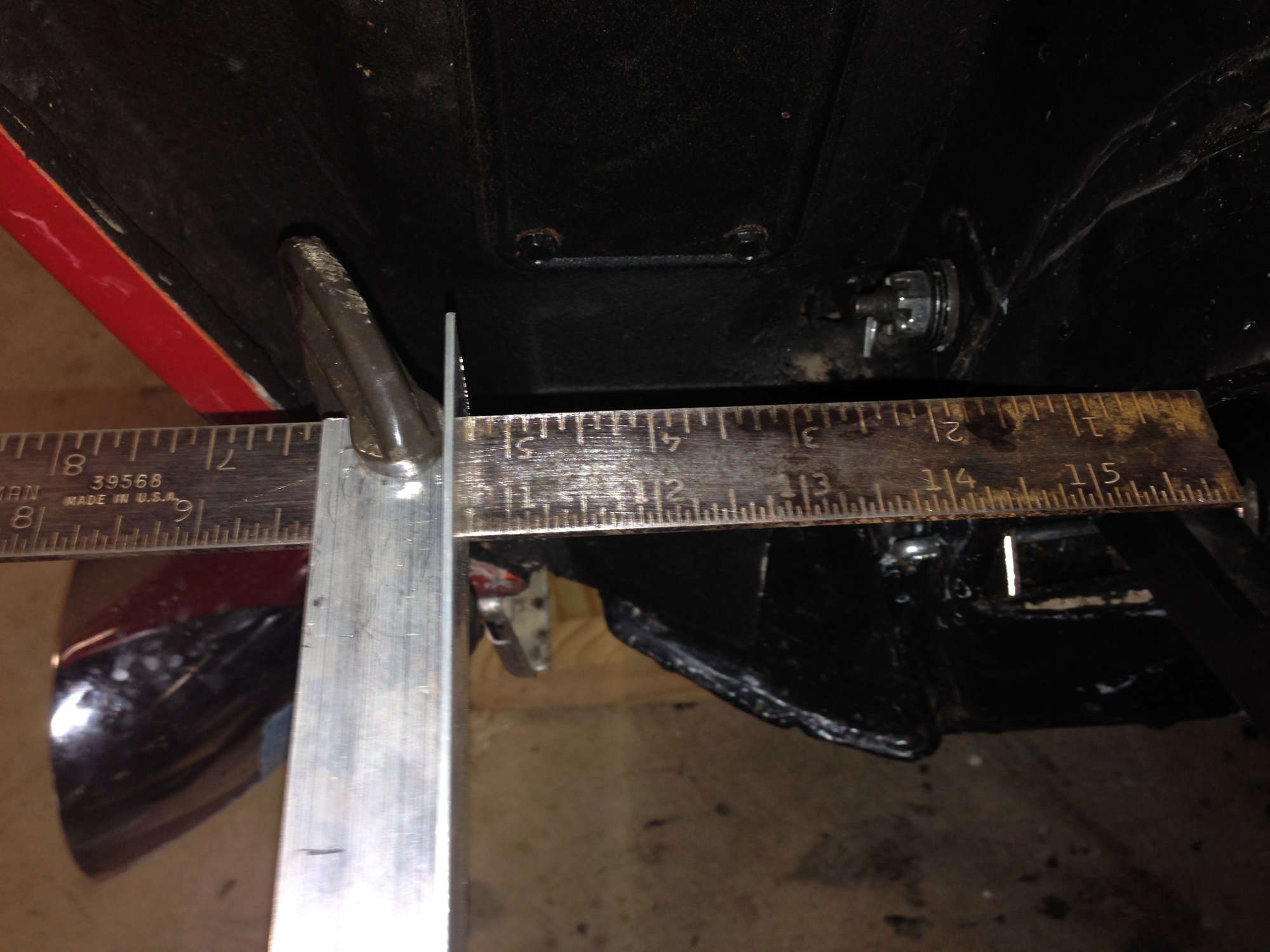

The one piece 17 x 8 are 0 offset so you will have 4.5" backspace, which is .5" more than stock and could give you some rubbing issues up front.
I couldn't find a 17 x 10 in the 1-piece, only 9.5" and they all have positive offset, meaning the minimum BS would be ~5.5" (with +8mm OS). That will require an e-brake cable move and possibly the need for a shorter spring. On my car, I maxed out the BS at 5.25. Installed with the car on the ground, I have about .25" of clearance on the frame (27" tall tire) on the left and about 3/8" on the right. A lot of guys are running 5.5" BS but there was no way for that to work on mine. YMMV.
This is what I rigged up to measure (with the suspension supported floor jacks under each trailing arm.
The angle aluminum is mounted on the hub and the ruler is at the closest part of the frame.
You also need to look at the tread width and section width of the tire you are planning on using.
