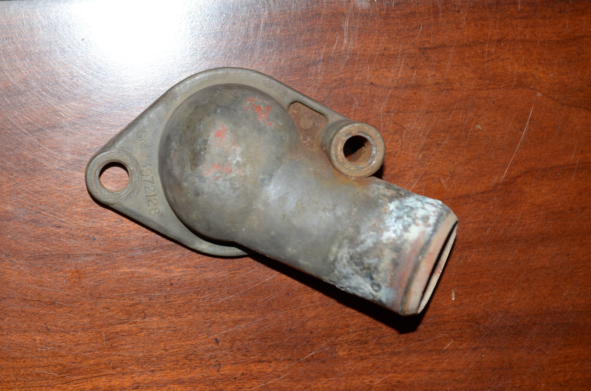

From the reading I've done it seems the 128 was used interchangeably with the 660. (Except of course on applications that require that little tab that the 660 has.
There was talk that the 128 was an ultra valuable production line LT-! neck which doesn't seem to be the case at all.
I just put a 660 back on my engine because the 128 seemed to raise a question.

(I wrote 228 in my first post, but it's 128.) I don't know which is failing faster… my sight or my brain.
The 128 has a cute little logo too… a diamond with a tiny P in it, and also maybe a mold number.
You can see the logo at about 12:30 in the picture.

I'm digging this thread up because as I get parts put away in my new garage, I rounded up the housing that came on my CE block. Just so happens that it is a 3972128. This old motor's parts has always seem to confuse me.
It is a 1969 L46 with a CE motor from 1971. The block has a casting of August 2nd, 1971. Many of the parts were transferred over to the short block, including the intake manifold. So why in the world would the thermostat housing have been replaced?
Looking at your picture, I see that the casting number is on the narrow face of the flange between the diamond w/ the "P" and the step up to the stud location. You'll notice on this housing that the part number is right above the stud location. Seems that, like the 660, there were also multiple locations for the casting/part number for the 128.
