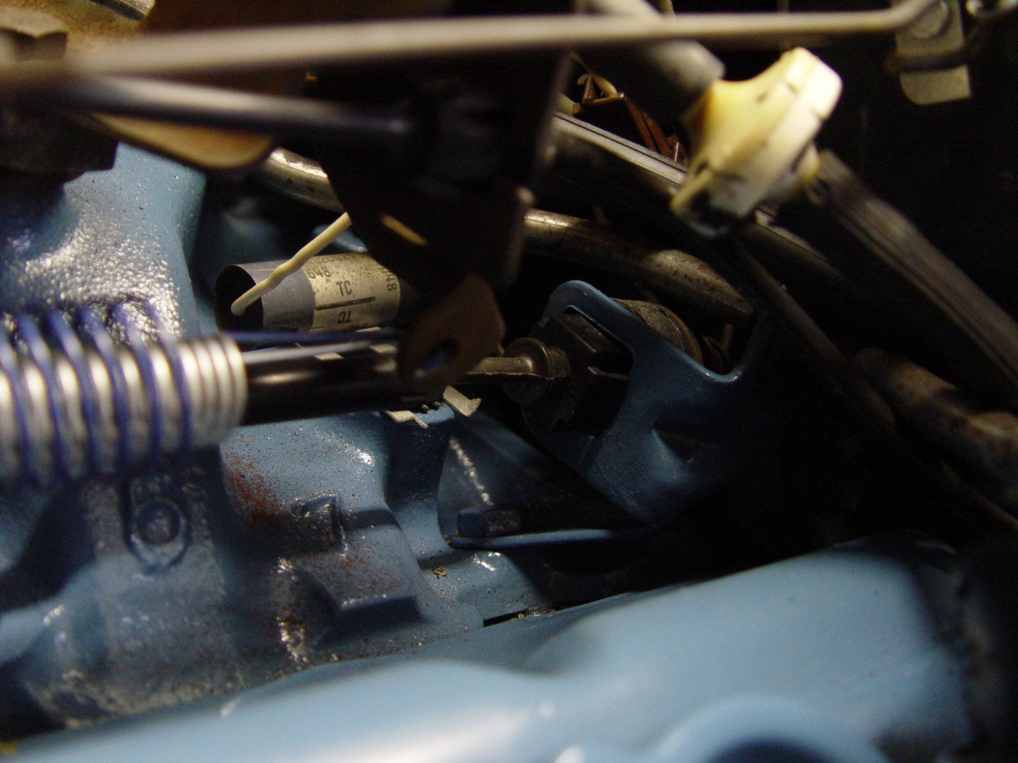

I can check this...may have a photo but will have to look around. Ok, a couple of years ago, I refreshed my engine compartment and posted some photos of the completed assembly work. This photo (link) shows the driver's side...see if this gives you what you need. There are other photos but this may be the best for your needs.
engine assembly top driver's side

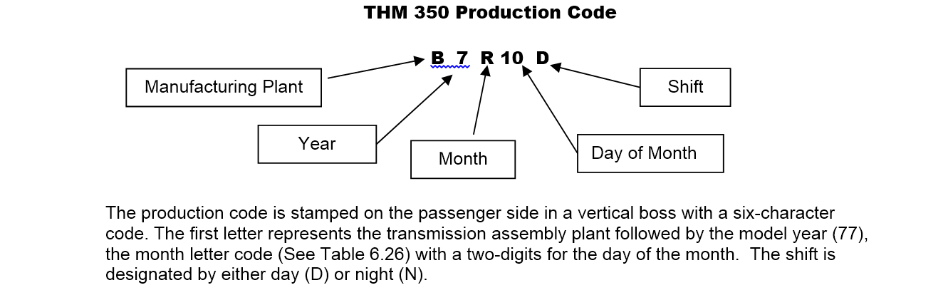

I have an L48 auto as you described above. Couple of things to check and confirm the tranny is original or same as that was equipped. Look for both the VIN derivative and the production or date code.
The eight-digit VIN derivative is stamped on the driver’s side, toward the front, bottom edge of the transmission just behind the rubber boot that protects the shift linkage. Often, the broadcast code 5TL, stamped in black ink can be seen on the passenger side. The last five digits of the VIN derivative will match the VIN on the driver's side windshield post.
The production code is stamped on the passenger side in a vertical boss with a six-character code. The image shows how to interpret the numbers.

hunt4cleanair, the picture did not really show the details for the cable set-up, but it clearly showed that the alternator plug is at the 12 oclock position. Another problem under the hood of this Corvette is that the alternator bearings are fried. Seems that sometime prior to the mtr swap the original alternator was replaced, so there is no sense rebuilding the one that's presently there

Thanks for your help hunt4cleanair. The pic actually shows that the bracket for the trans cable is correct compared to what I'm working on. I'll be by the car again this weekend, as I have to pull the alternator and I'll have another look at that cable about whether it's adjustable. Just don't recall them being that way, at least not the factory installed kickdown cables.
