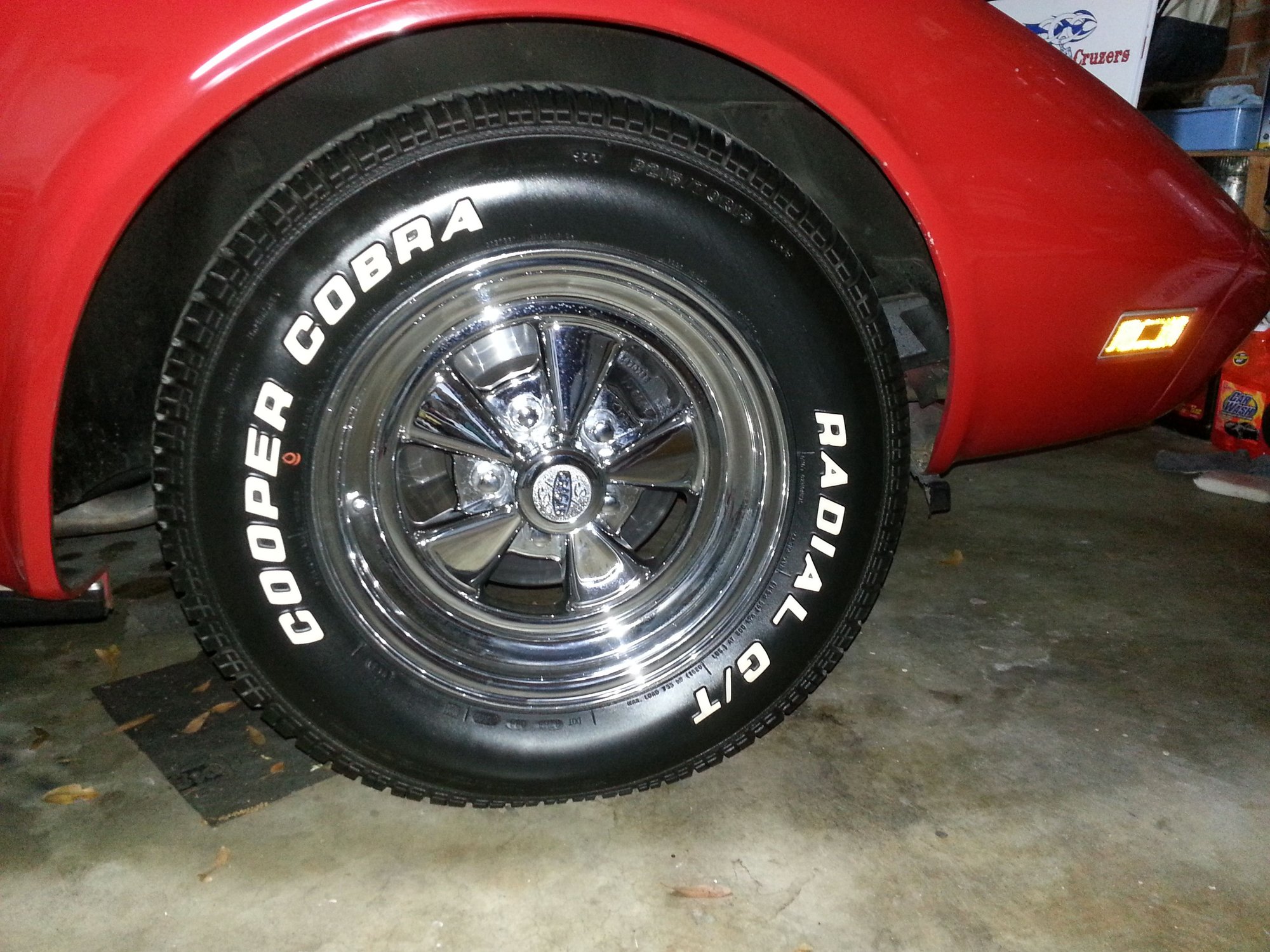

I have Cragar S/S on mine 15x7 4.25" backspace on my '79
