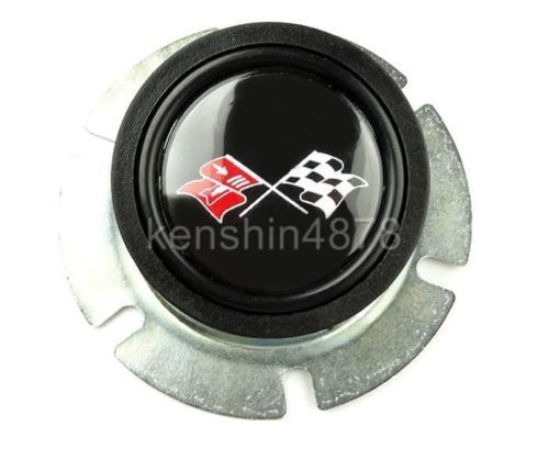

you can always just stick a breather from auto zone in the hole on the valve cover until you get to the motor upgrade... and you will upgrade. You know that is down the road, so don't spend a lot of money in that area yet. Get her driving well and then make it fast. Get a new steering wheel fast. That is nasty! You can buy a nice one for not much money at the parts store. You will be surprised how many parts for an 80 you can get at the local parts place. I was... Nice car and have fun with it. I have had a blast with mine!
1. Breather valve something like this
121376101964
For valve covers with 1-1/4" filler holes
CHROME TOP IS 75MM DIAMETER
2. Steering wheel - what is this thing here, is it to take it off ?
Any suggestions for replacements, get both new wheel and the C3 emblem ?
181480539682
and either 320mm or 350mm ??
Keep in mind it will have the emblem replaced with ^
261722992785
OR
201254617167
