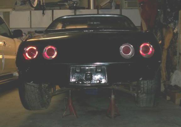

It's too late now 20mercury.......fat tires are fun to talk about.....LOL
2 9er 5s...................................
(Ignore the A.D.D. mess on the floor).................................. ......
As you can see, the camber needs a LARGE adjustment when wider tires are installed........

In this picture, are those jackstands under the spring? That is asking for trouble.
Being a rookie I corrected the mistake before I worked around the car/I did a search on jacking-points....
thanks for the heads-up!
