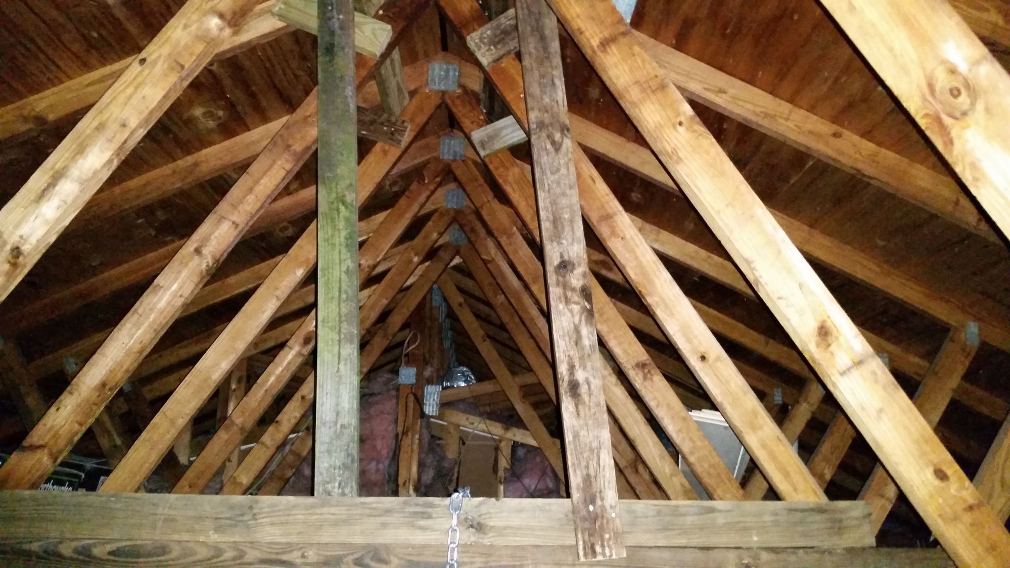

Here is a picture of how I supported the body lift crane in my attic. If I had it to do over again I wouldn't go this route. I was constantly afraid the roof was going to collapse in on me.

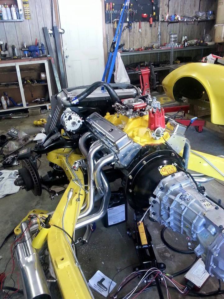

Just some more pictures for any interested:
Rubber gloves as padding are temporary. Don't judge
