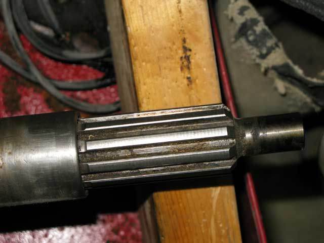

Can I use the spline off an old Muncie to tap the bushing in???
R
You talking about the input shaft? I believe there's a big radius on the shaft that will destroy the bushing.
To Seating a pilot bearing
Old Jan 27, 2015 | 01:22 PM
LT-1 kid's Avatar
LT-1 kid
Joined: Sep 2007
Posts: 2,149
Likes: 284
From: cary Il
the radius on the shaft fits the bushing radius perfect, so anwser is yes,
I do it all the time
