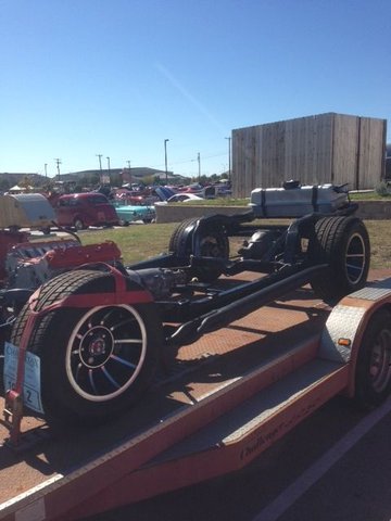

I always tie a vehicle down on my trailer with over tire straps.... but then my trailer is setup for them.. I have a few different size straps.

I must have had my blinders on more then once , lost the body on the vette this day....
