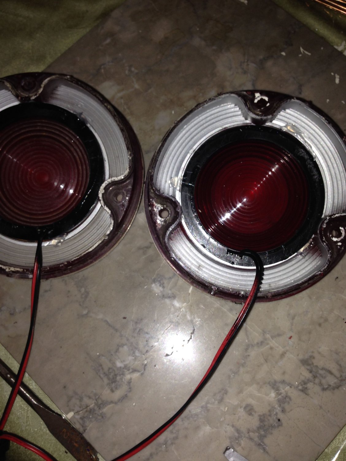

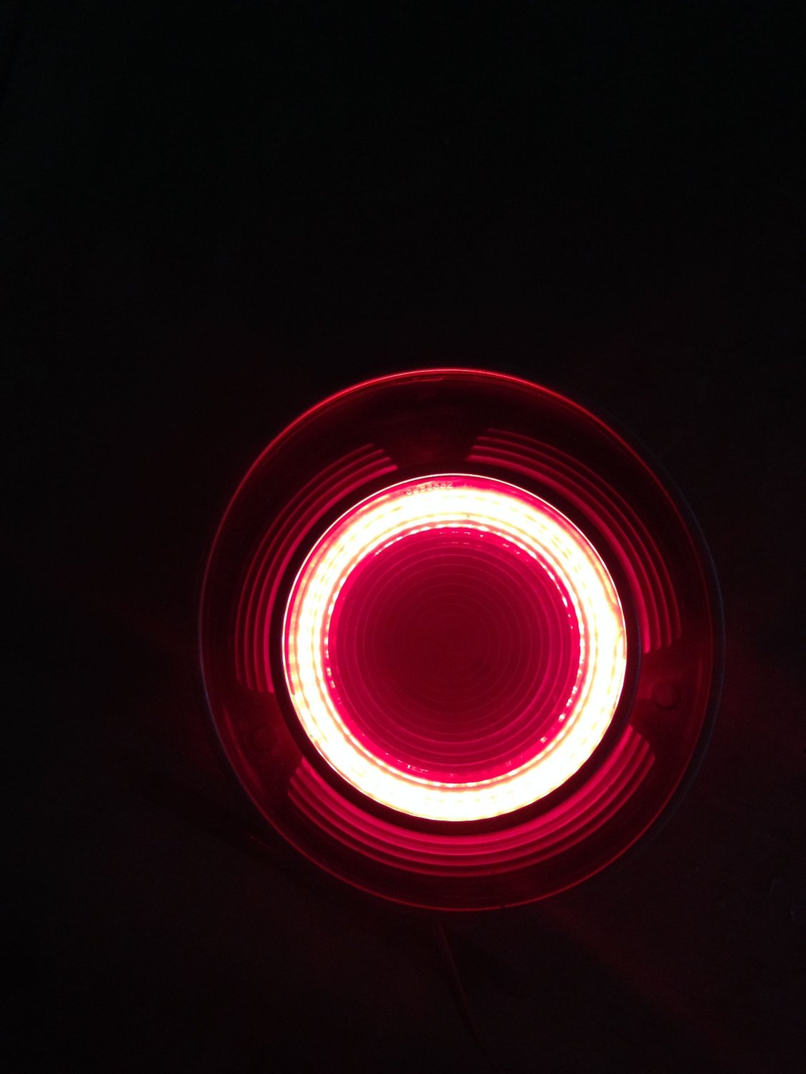

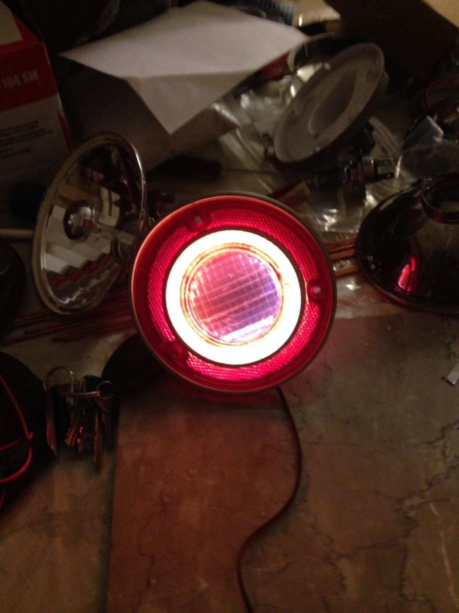

here is another option that I did, there is a thread on it..
