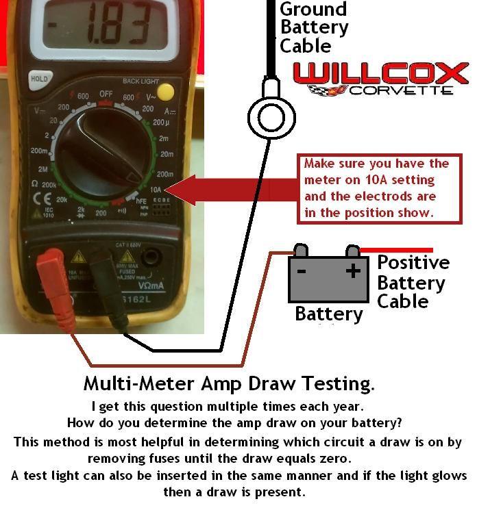

taylor34,
Can you share your procedure for measuring the current draw on a C3? It would certainly help those of us that are electrically challenged.
Thanks,
Rick

Originally Posted by AkrHack
taylor34,
Thanks,
Rick
taylor34,
Thanks,
Rick
http://willcoxcorvette.com/product_i...ducts_id=27355
