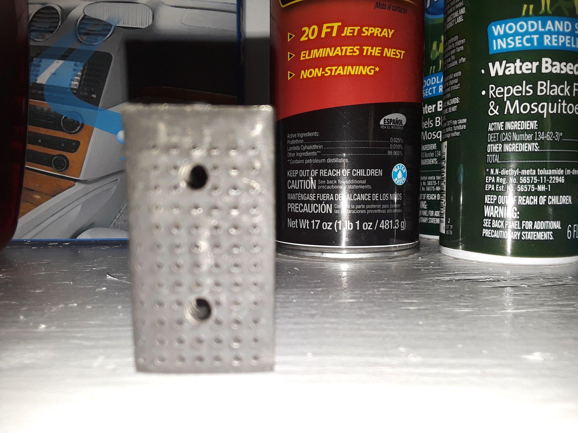

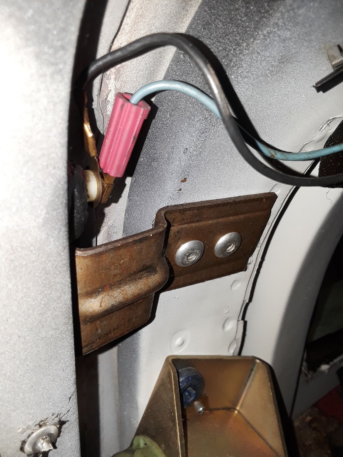

Well, I decided to try to locate the T-top lock plate back that I removed the screws from. Found it laying inside the pillar where the seat belt is installed. Was able to retrieve it. To reinstall it you have to remove the interior panel and then you can reach where the lock plate goes. See photos. Help...Still having problem with new seal being too dense and lock pin is off by1/8 inch...and wont go in to the lock plate hole. Any suggestions?
Lock plate that fell off when screws were removed
Remove this panel to reinstall lock plate.
Lock plate gets put back in this area.
