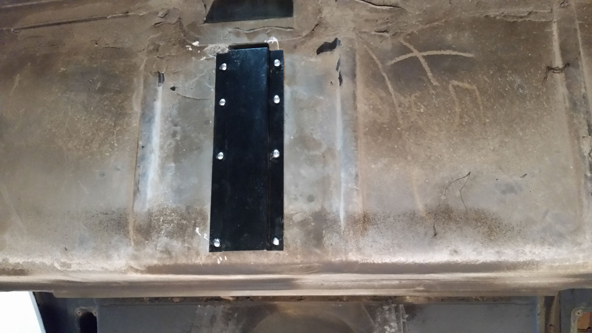

The alum. rivets work the best and like mentioned above you can cut them to length. An adjustable air hammer can be purchased at Harbor Freight along with bits. Practice and keep the air pressure fairly low. As you peen the rivet head move the gun in a circle motion to obtain good results. Good Luck
r
The bit in the gun is an off set bit I had to order but you can get straight ones also.
Hope this helps
