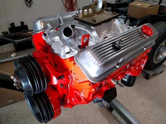

I choose to keep original # matching motor block, and original turbo 400
and stuff it full of money= translated = built the motor for the HP.
I wanted; head work, crank,rods, pistons,cam
looks like stock, but runs much better.
Do not let them surface your block and remove the numbers.

@69vette, Great pic! I think i'm going to follow your lead.
