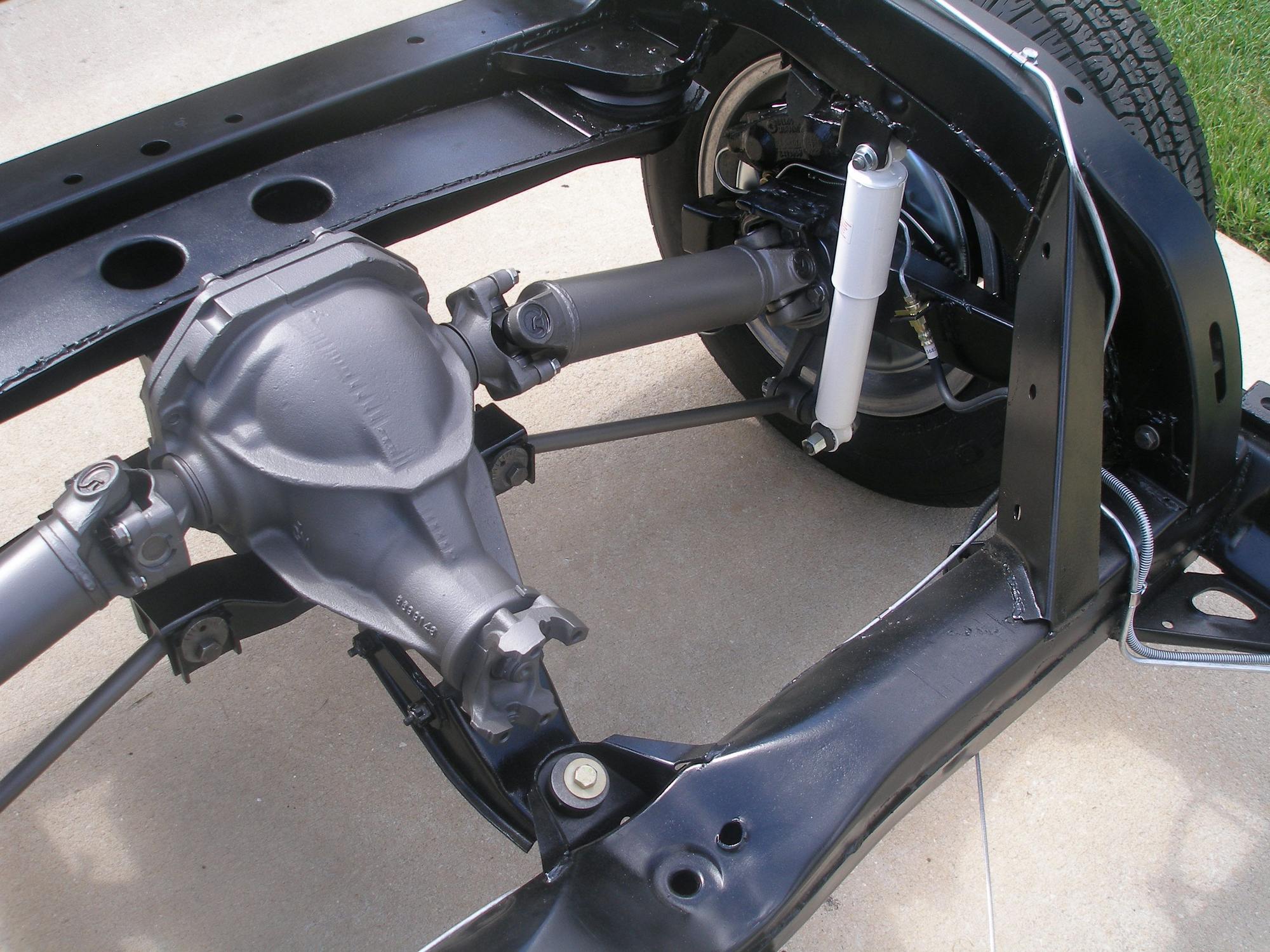

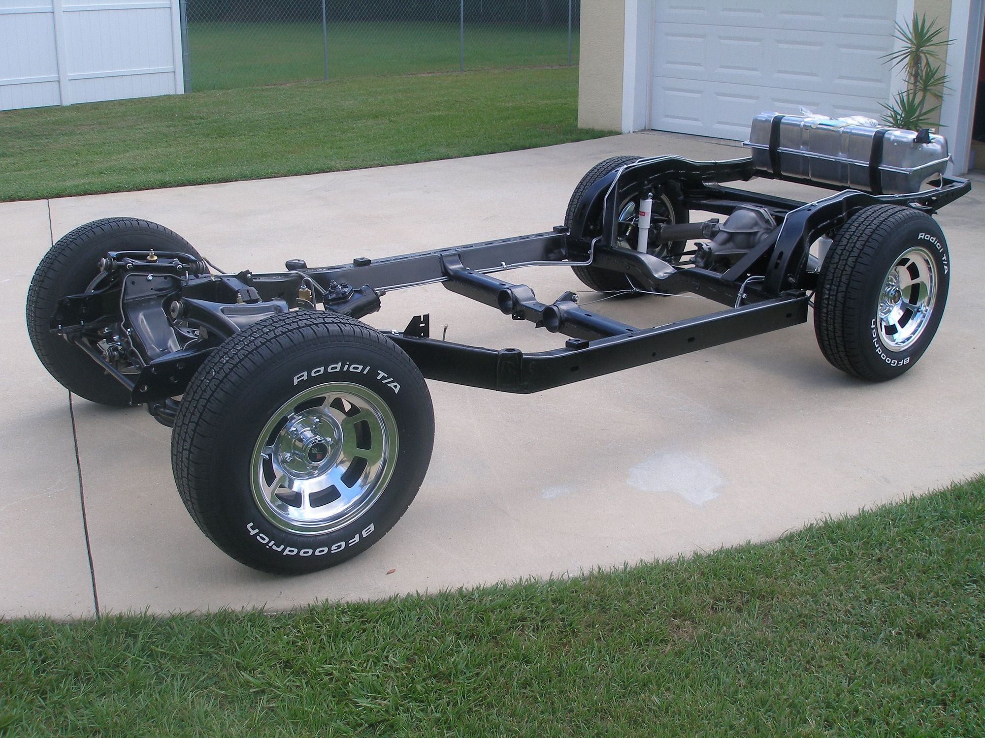

POR-15 is formulated for just that situation. It uses the existing [firm] rust to bond with the part. If you clean all the rust off, there would be no reason to use POR-15. But, if you knock the loose rust off, leaving only well adhered surface rust, POR-15 will work well to seal the surface and eliminate future rusting in that area.
If you have bare metal with no rust, priming with a self-etching primer and using Rustoleum semi-gloss black should do the job.
That looks amazing!
