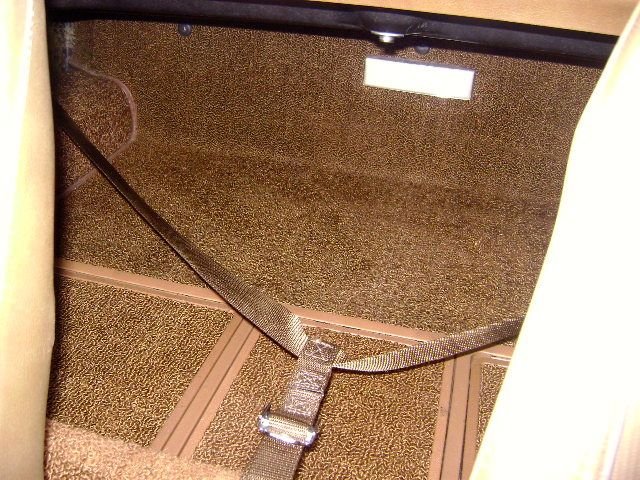

I am trying to understand what the back cubby should look like from immediately behind the seats, up the panel to the flat (storage) part of the cubby. The attached picture shows what I have right now which I don't think is stock. I have covered the rise from the cockpit floor up with some black carpet just to tidy it up. When I bought the car it had two 6x9 cutouts for speakers which I have since covered.
At the top of the rise up from the floor is about a 2" lip? I have no idea if this as it should be or if it was added to hold back anything from sliding forward.
Appreciate any help/suggestions.
Thanks
Greg
This is what I'm working with right now:

Looks otherwise fine. You are missing the storage compartment door locks and pull loops. The 72 assembly instruction manual (AIM) shows how these install and lists the original part numbers for the hardware you need.
Jack and lift out tray install in the compartment on the left in your pic (passenger's side); center is the glove box; right side is the battery compartment behind the driver's seat.

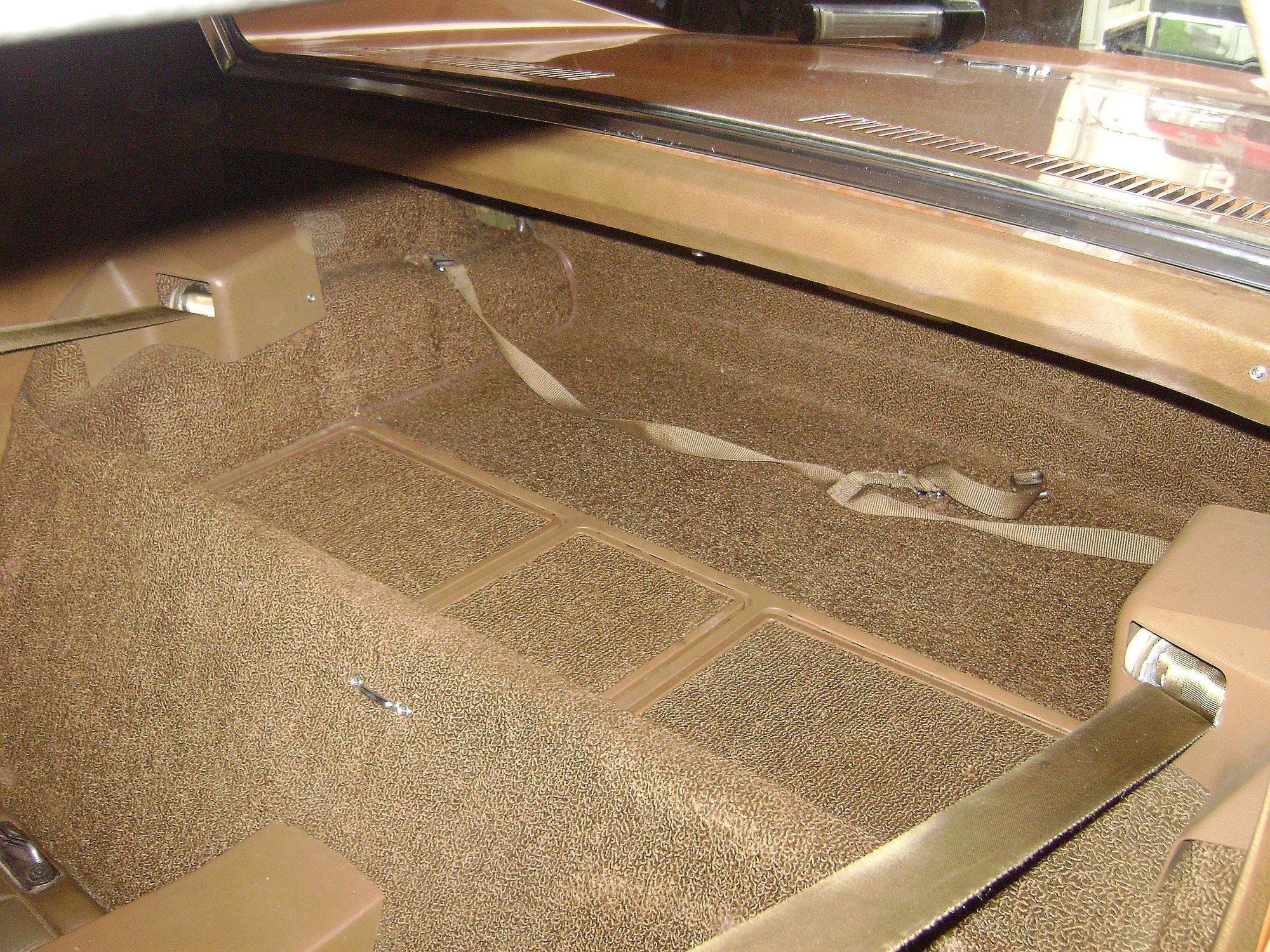

Originally the carpet went up over bulkhead behind the seats and was tucked under the forward edge of the compartment door frames.
It looks like yours might do that but I can't tell for certain.

Shout up if you need anything more specific

Hi Alan.
As far as I know it's the original carpet. Cars only done 30k and it doesn't seem to have been taken out at any time
Stuart

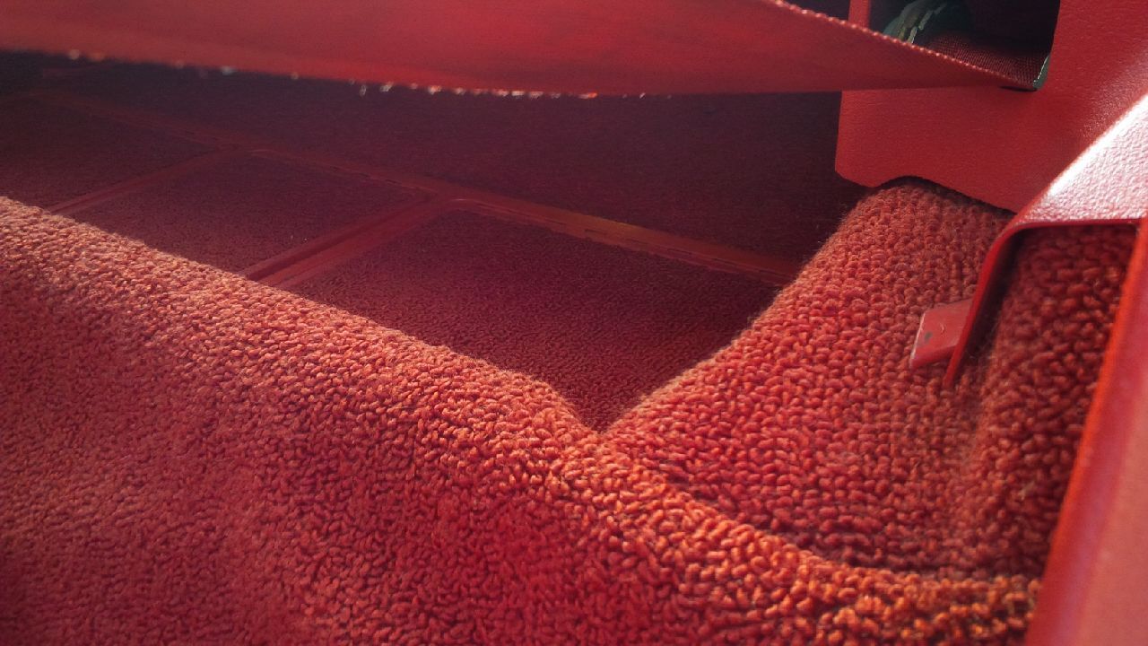

Alan/Brit:
Great pictures - that is what I need. It seems that at the top of the bulkhead, under the carpet on the rear side there is more mass of some description than what I have. Mine is only about a 1/4" thick at the top. It looks like there is something an inch or so wide needed that the carpet wraps around and then transitions rearwards.
Thanks
Greg

Hi Greg,
Originally there was a strip of jute underpayment on the REAR side of the bulkhead that helped 'fluff' out the carpet as it went over the top of the bulkhead.
