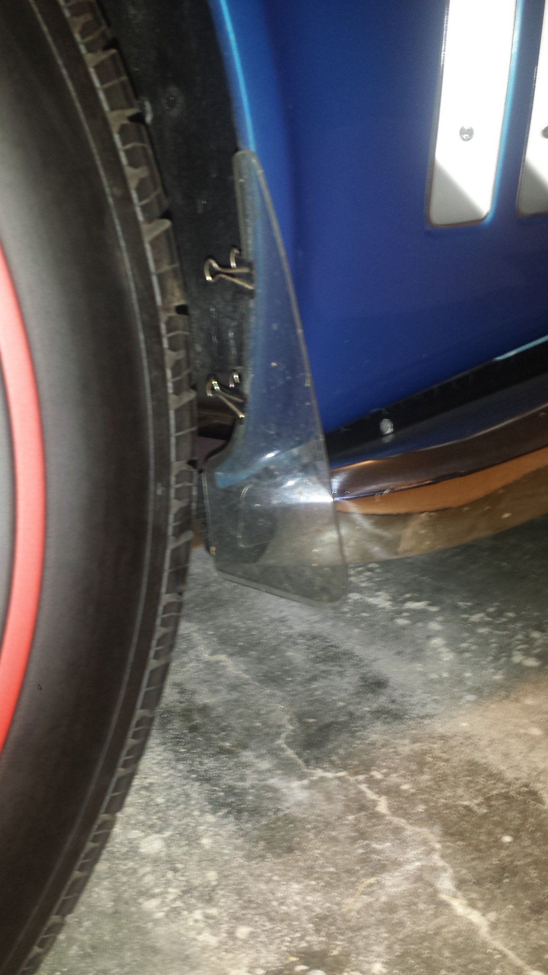

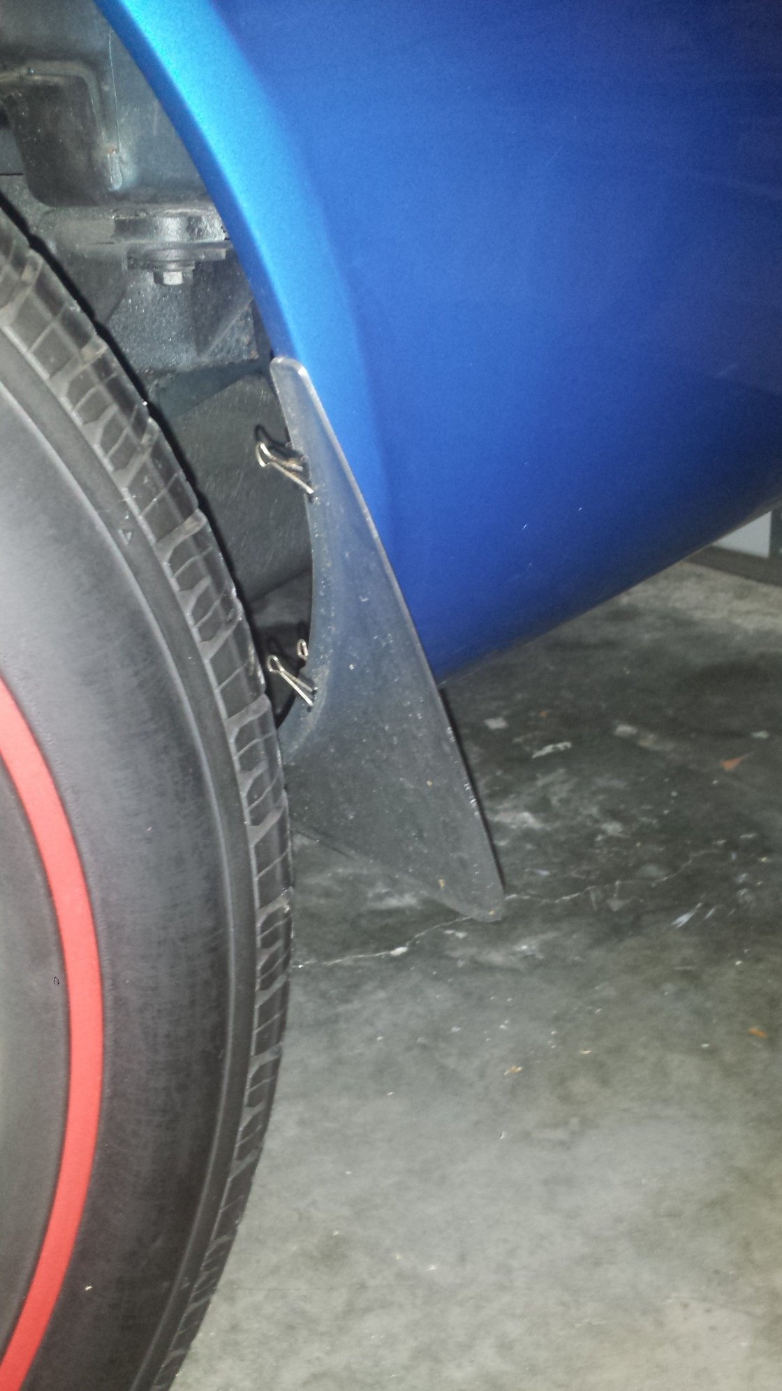

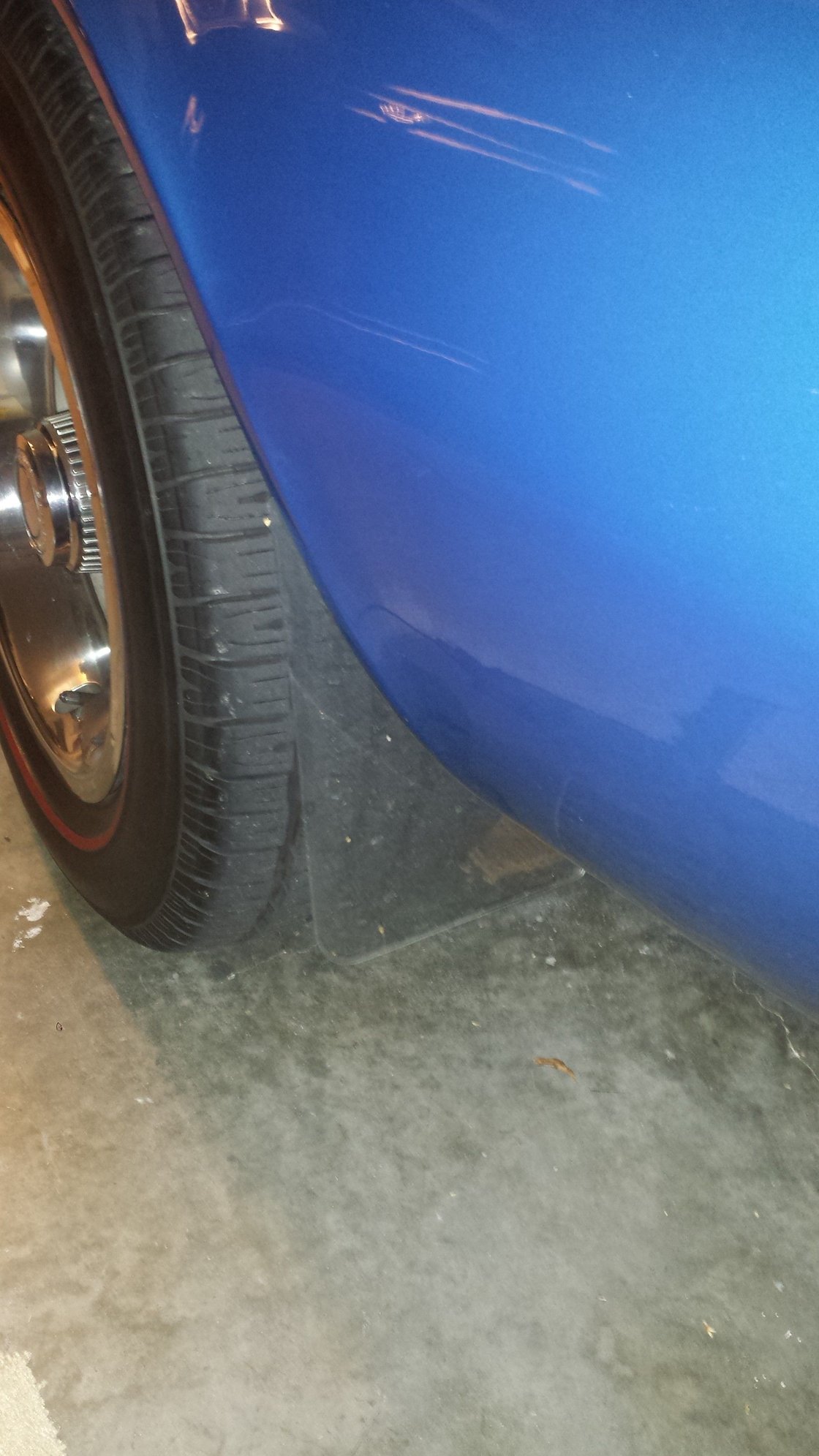

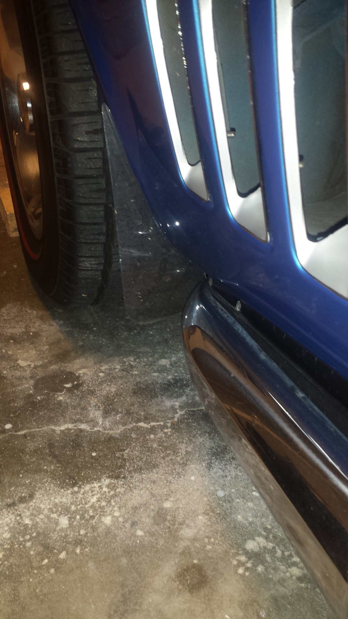

Sorry for the delay. 6 month old baby and my wife is training for an ironman.
As you can see, they are dirty as they catch alot of road debris. If you drive over gravel, you can hear it hitting the plastic shields. They have the same shape as the inner fender and have a rubberized area where they make contact with the paint.
I have another friend that wants a set, I checked about 6 months ago and they were out of stock. I will try to stop in again and see if they were re ordered.
Gary
