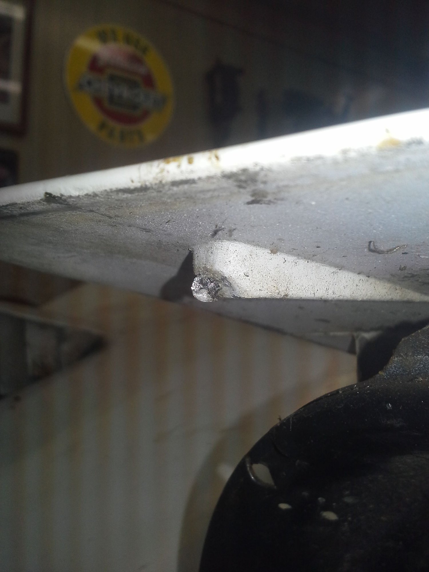

I need your expert opinion guys. These little scews broke off when takin apart my headlight assembly and I have no idea how to extract them. Do ya think they are threaded into the fiberglass? or is there metal in there under the fiberglass? I'm open to all ideas since I have none thanks

The headlight doors are Metal. I have the same problem w/one of mine.I'm gonna drill out and try a self tapping metal screw.

I thought I was also when mine did the same thing. After debating whether or not to take them to a machine shop. I grew a pair and drilled them out myself. not a big deal. Take your time and use the right size bit but need to smooth out the surface and hit with a center punch to keep the bit from walking. then I tapped it out. or use self tapper screw. Just take your time...

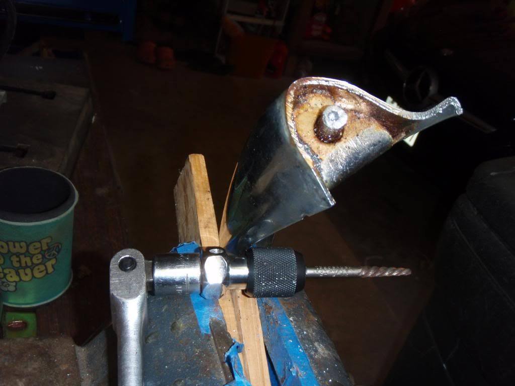

Originally Posted by Indigoblue
Try "Sears" ...they have a nice selection of extractors that should work for that...they come in kits...all the way down to micro screw extractors...good to keep in tool box for such a problem.... ( i have various size screw extractor sets and bolt extractor sets in my box)...price is not that bad and they usually have them on sale... :-)
I think I got this at Sears.
It removed this (easy out didn't work):
