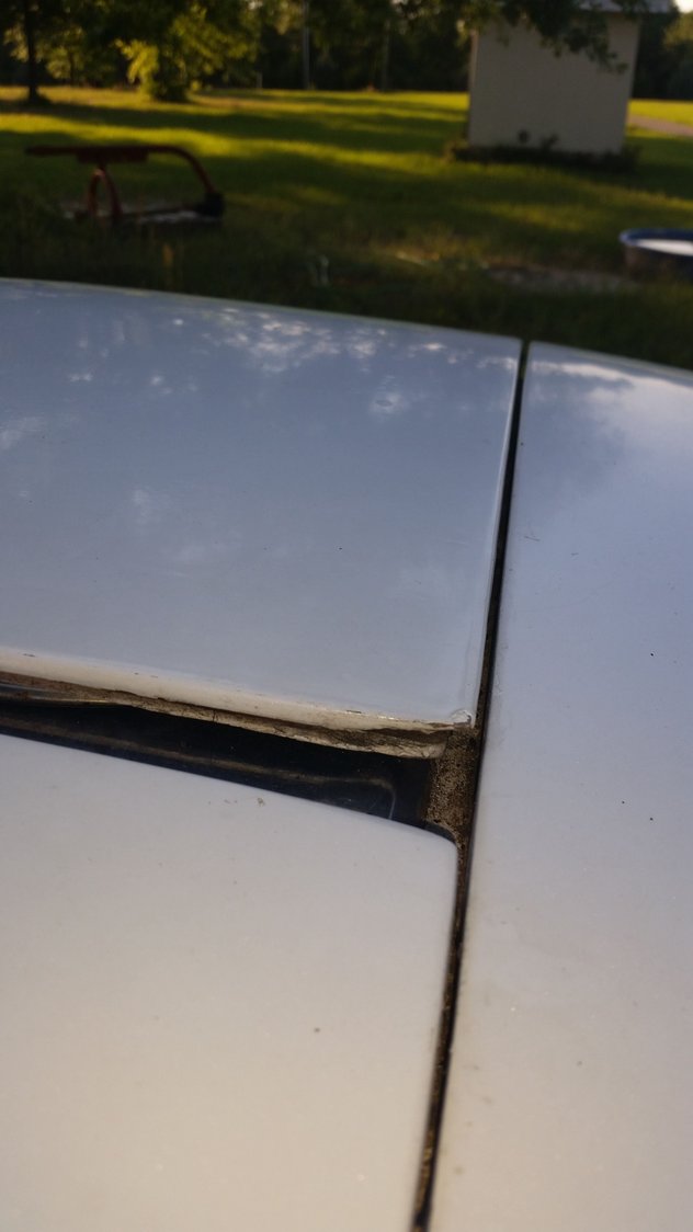

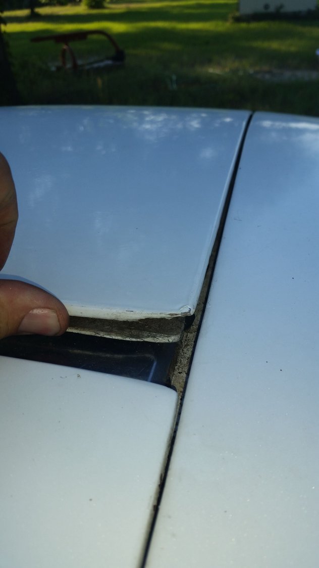

If this had already been discussed I apologize. I couldn't find it with the search function. My passenger side t-top, the cover and the frame, are coming Disbonded on the inside aft side. I'm sure someone has had to fix this before but I can't find a thread on it. Any help is appreciated.

Glass or body panel top?

Fiberglass.

What year?????

The car is a '76.

You could use Evercoat's SMC panel adhesive ( part number 994)
Follow the direction on the can....or you can use a 2-part adhesive....and that may require a special gun to apply.....either way....you are going to have to spend some $$$$$ to get his done unless you have a body shop close by that will bond it for you..
