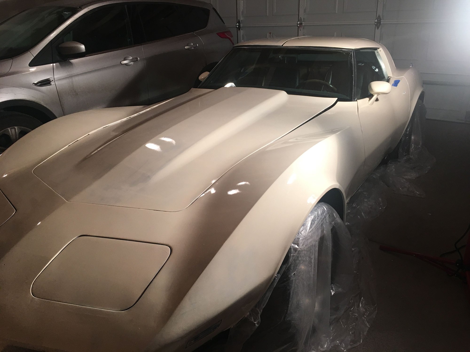

I'm in the middle of rolling on my paintjob right now too. She's been sitting for years and I finally just got her up and rolling and finishing up the paint now. Here's some pics of the 1st full coat, should be done in a few weeks. I think it looks fantastic, especially for $100. By the way, I ended up choosing Interlux Brightside instead of Rustoleum as it's made for fiberglass (boats), has a higher shine, and is supposed to last much longer than Rustoleum. It's a little pricier and there's only a few color choices, but so far I'm thrilled with it. Hope to post some final photos soon.

I call B.S.

LOL... B.S. on what???

You didn't paint that with a roller brush.

And that response is what makes it oh so worth it!
My neighbor says the same thing. Looked at me like I was crazy when I told him I was gonna paint it myself with a roller and then said "ahhh, I see you decided the roller was dumb and you're doing a real paintjob huh?" when he saw the first coat... Nope, that IS from a roller. Can't wait until the final coat is all sanded and polished out!
I promise you, this is with a foam roller and $100 worth of paint. Look it up... there's plenty of guys getting show quality results with rollers. Mine won't be show quality, but it will definitely be good enough and leaves me with a few more thousand to spend on other stuff!
Just to "prove it" to ya, here's my tools and here's one T-top that just got it's very first coat with roller marks and all.

I'll believe it when I see the video of you rolling it on the car.
