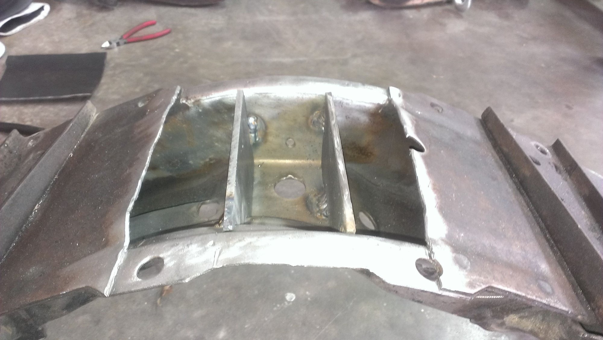

Here's the bottom of my front cross member which clearly shows what can happen if it is used as a jacking point. DON'T DO IT!
I cut the section out and restored it... installed vertical ribs inside now, so could be used as a jacking point now.

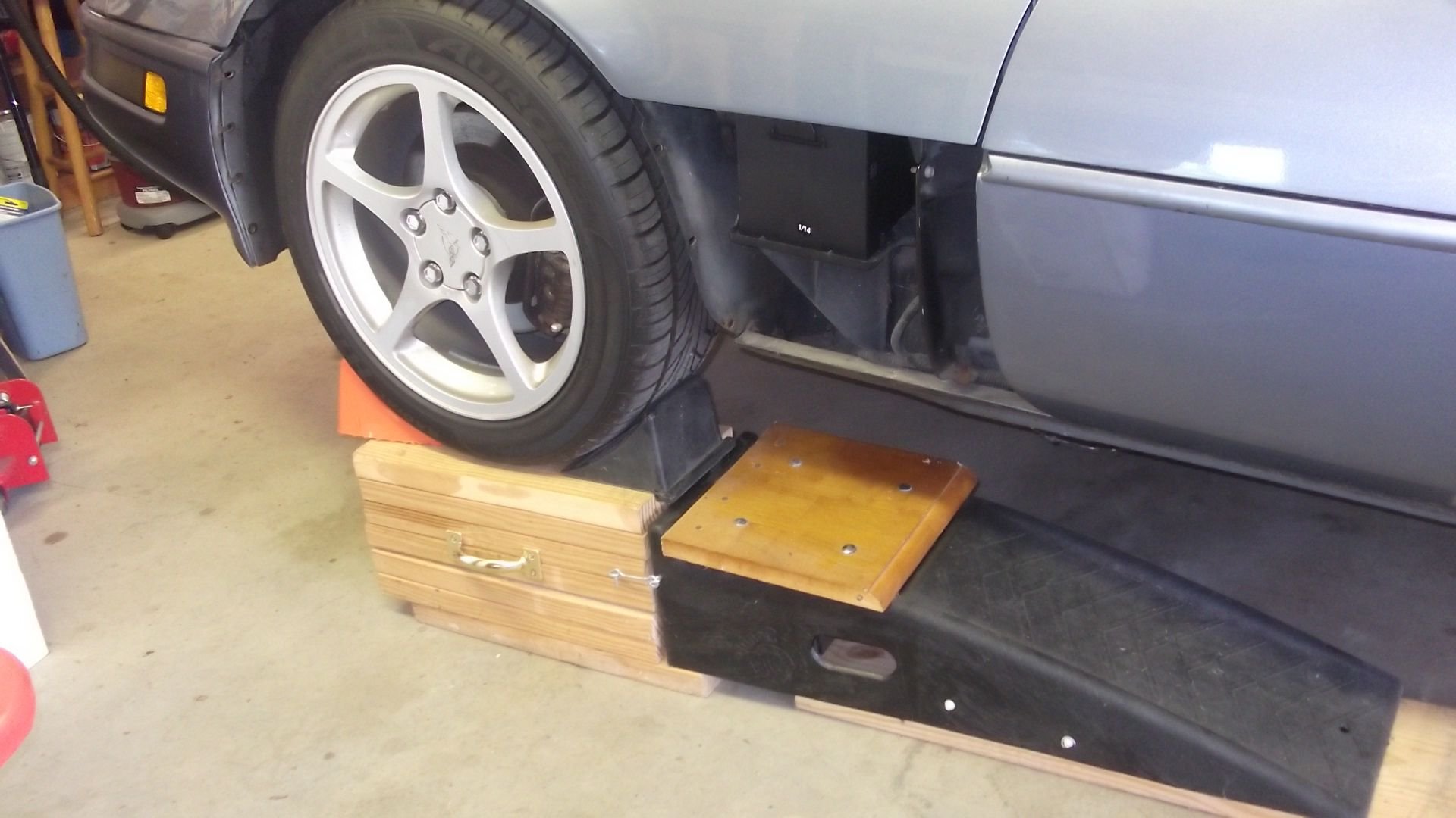

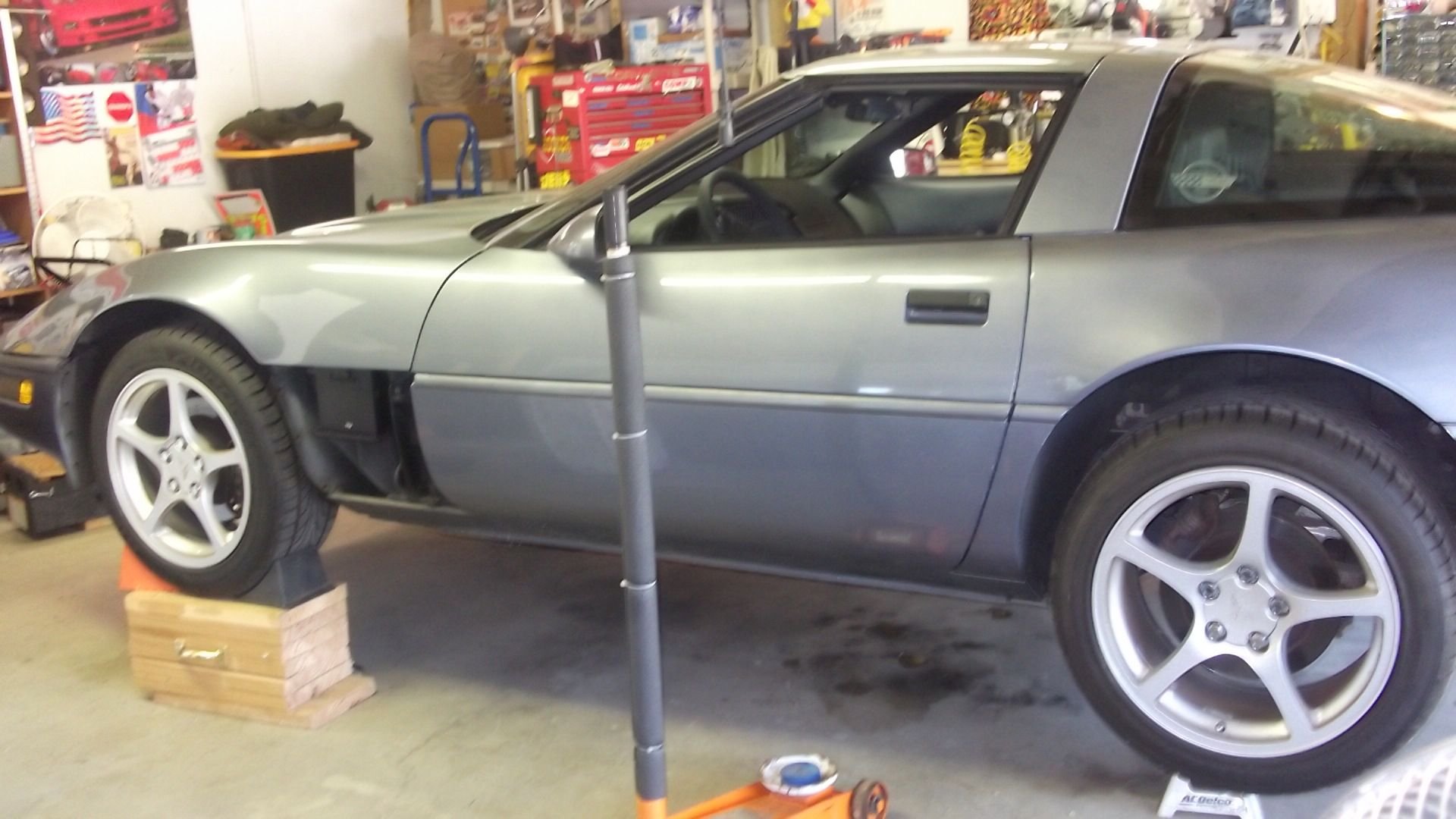

Here are my ramps. Home built using some Rhino Ramps, scrap lumber, liquid nails and lag screws.
I use a garage-sale mirror to watch my tires as they go up. I then detach the eye hooks to remove the ramps so I can work under the car. I then raise the rear with a floor jack and put it on jack stands.
You can add 2X10 pieces to get it higher if you like.
