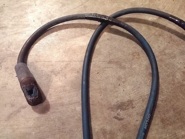

My recently purchased 79 has never run right, it has always had a slight miss and just lacked the power that it's rebuilt 350 with Edelbrock intake, Holley carb and MSD ignition should be making. So I finally had the opportunity yesterday to do some engine tuning. Beginning with replacing the wires with AC Delco wires and new plugs. Apparently the previous owner thought that you install spark plugs the same way that you install oil filters, as almost every one of them was only finger tight and 3 of them weren't even tightened at all, easily backed out 1/3 of the way.
Needless to say, after replacing the plugs and wires and some timing adjustment, the car runs like a champ again! Loving the chirp from the rear tires as it up-shifts when I'm on the gas hard! Check out this pic of the old wires...

pretty burnt. thats cool you got her running good

Sure looks like the smoking gun to me.
