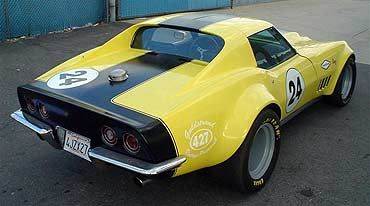

Depends on the look you desire...there is L-88 in bolt/screw/glass in, which are the road race look.
^^^ Going on my car...
The L-88 was to cover race car tires for the rules but allow the fenders to get snad blasted on a street car...I plan to run this style in screw on.
Next is the refined and nice looking ZL-1 an Ecklers idea, made on the fender they are easier to install and at least one ebay vender sells on the fender L-88 for 650.00 OBO.
This is a better flare for the street due to the way it's like an enlarged stock flare with kick out to keep road crap from beating up the car...it gives a nice custom look yet still has a racy feel...

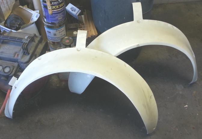

The mod isnt hard the easiest is the screw on then the flares built on the fenders, Ecklers sells them as does ebay and Craigslist....

1-1/2" extra on factory flair. Covers a 275/60/15
72 fenders on my 73

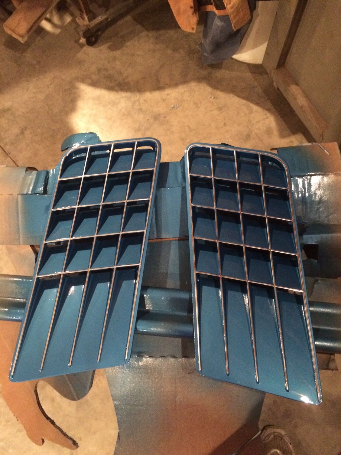

1 price tilt & L/88 scoop on my factory 73 front end. Hood grills are from a '65 396 vette hood
Home build and paint. fia fixed headlamps for the lighting
