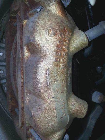

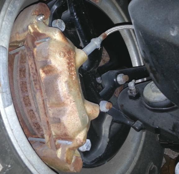

So then I learn I have these odd ball J-56 brakes, I believe these calipers ended up on this 68 chassis when it was rebuilt with vette brakes transverse stuff, I have learned the pads are pretty darn expensive,
I was told cars that came with these brakes had an actual proportion valve...it that a must to run these?
So do I need these for my street cruiser? pros vs cons....
I am just trying to get the car going again...

I know that the 1966-early 1968 used the proportioning valve for the J-56 option... It was more to allow the owner to custom tailor the brake bias to their preference. Later cars that used J-56 used the standard brake distribution switch without a proportioning valve. Don't know what the 1973-1975 Z-07 cars used.
Bottom line is that if you can get them cheap, you don't need the proportioning valve.
The calipers should have pistons with thermoplastic insulators... The front calipers use brake pads with dual pins... The stock pad material isn't ell suited for street use, but it's doable... You can have custom pads made using stock backing plates... Neither stock nor custom pads are inexpensive.
Do they offer an advantage over the stock calipers? Not on the street.

In the condition shown about what would they be worth?

I guess what someone is willing to pay for them...and what the purchaser intention with them are. From the photos you posted...I can see small stamped numbers on the caliper where I can see it was ground on so the numbers would show. This is telling me that they have been rebuilt and it looks like possibly from Vette Brakes and Products....But I can not enlarge the photo to make absolutely certain.

With the casting numbers milled off? Not a whole lot. Some of the rebuilders used to do this and stamp their own codes into the castings... Not great for resale. Of course, you can have castings with the numbers still on them machined for dual pins (that's what the factory did), but that may be farther than you want to go.

I also believe they have a VB brand stamped on them, the stamp isn't very good, them being a VB product starting with the chassis being rebuilt with the transverse vb package wasn't that hard a chain of clues for even me to follow...
I asked value only as I hoped that they were worth a swap for good single pin calipers since I would rather not be locked into some odd ball hard to get & expensive pads caliper.
So they are junk...okay...I will clean them up and run them...

Seems to me that that is a pretty crappy way to do business, grinding off the original casting numbers. You can't tell me that there isn't another, discrete, spot on the calipers to stamp their numbers into. Someone restoring a period racer would want the casting numbers to be correct looking. I feel for you Bats. Lou.

I would much rather have plain old stock calipers but since these are not worth even what the stock ones are worth because they have been machined then I will make them work for me, because if machined they are sleeved and will work....
If someone desires I will take a better picture of the side so the machining can be better and further critqued...

there is a lot more to J-56 brakes than double pin calipers, the money is in the stiffening brackets (that I can see you don`t have) and as mentioned above the insulated pistons with 5/8" thick insulators (which we also can`t see), any Corvette C-2/C-3 caliper can be modified to make it a dual pin.

But in my case these are just a modded fakes that will cause me grief when I need pad....
Why in the heck would anyone want to pay to get a stock caliper ruined into 2 pin?

pull a pad and post a pic of the pistons

Okay...it will be tomorrow afternoon....
