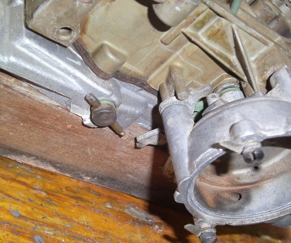

Almost sounds like your secondaries are not opening properly or the air flaps for them.
You should be able to put a brick or board or whatever to fully depress the throttle when the engine is off and see if the throttle blades are opening all the way, primary and secondary both. This does not eliminate the mis-functioning of the air flaps on the secondaries though.
There is a lock-out lever on the right side of the carb that moves out of the way when the engine is fully up to temp that allows the opening of the secondaries. Check it's function to see that it moves when up to temp and the high idle has gone down to normal idle.
You can see it in this photo. the pin on the shaft engages the lever to it's right. That lever has to move so that the shaft can rotate. Secondary blades are on that shaft.

I thought GVWR might mean "maximum allowed", not actual empty vehicle weight, but threw it out there anyway. I'll check those secondary throats next.
Will prop the pedal down all the way, then see if any more can be opened at the carb by the cable. Will also investigate the possibility of a wrong carb gasket hindering the Secondary butterflies from opening. Any thing's possible with me.

Photo with pedal propped to the floor. Note cable's casing.
I can pull the linkage more and open the secondary's by hand, with the limiting factor being that cable casing.
Steve

Ok looks to be a throttle cable/pedal problem. That casing can be cut back if it is restricting full movement. Looking down the throat of front and back barrels are the blades vertical when you push it all the way open?

From that picture it doesn't look like the rear throttle cable and bracket are quite right. When you force the throttle all the way open look how much bend there is in the throttle. That should be straight. You may need to re-orrient the bracket so it holds it further back and maybe even flip the part of the cable shield that hooks to the bracket over so it is underneath if you can.

Looks like you can move the cable back in that clamp and get more throttle travel. It also looks like the bracket could/should be sitting back a bit farther. That second hole in the bracket is ahead of the hole beneath it. Your missing a lot of fun right now!
