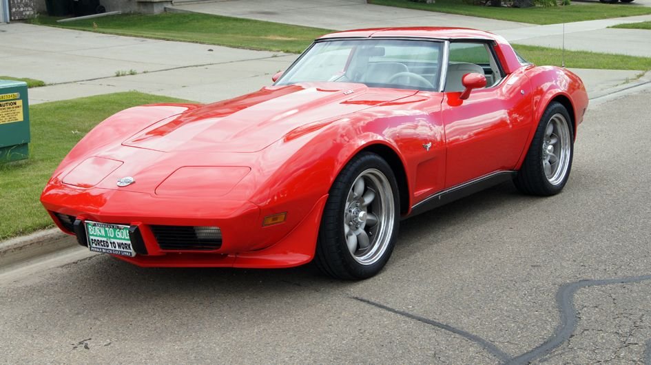

I've finally got my car back from paint and now I'm thinking about some new rims. I don't want to modify anything or have any rubbing, so let me know if this combo seems like it will work with no issues. I'm looking at the Foose legend black 17x7 with Firestone fire hawk wide oval 235/55r17. Thanks for any input.

Why do you want to go with wheels that are not as wide as stock? There are so many wheel choices. You can't find anything that you like in your price range that's 8" wide?

Don't stop @ 17" there are plenty 18" x 8 or 17x8 that fit your car.
All you need is 4" backspace (-12mm offset) to match stock 8" wheel.

Found these rims for what I think is a good price and the tires I listed are only .3 narrower than the stock which I didn't think would be noticeable. Will there be a big difference in appearance with the 7" wheel. I forgot to say that the wheels have 4" backset.
Wrong Backspace for a 7" rim. Your wheel will be 1" inward. This will look funny. You would need a -12mm offset which would be a 3.5 " back space for a 7" rim. This still will be 1/2" inward and provide additional clearence on the inner side of 1/2".
To have a 7" Rim and have the outer tire the same as a stock 8" wheel you need a 7" rim with -24mm offset and 3" backspace.
