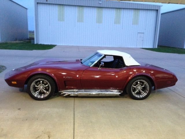

Since it's a '69 in question here I thought I'd toss a few shots of my 17x8, 17x9.5 set on the '69 that I usually keep them on. They've never rubbed (on either the '69 or'72) and the car has not been babied. But that's not to say that some cars might have an issue.

thats sexy!

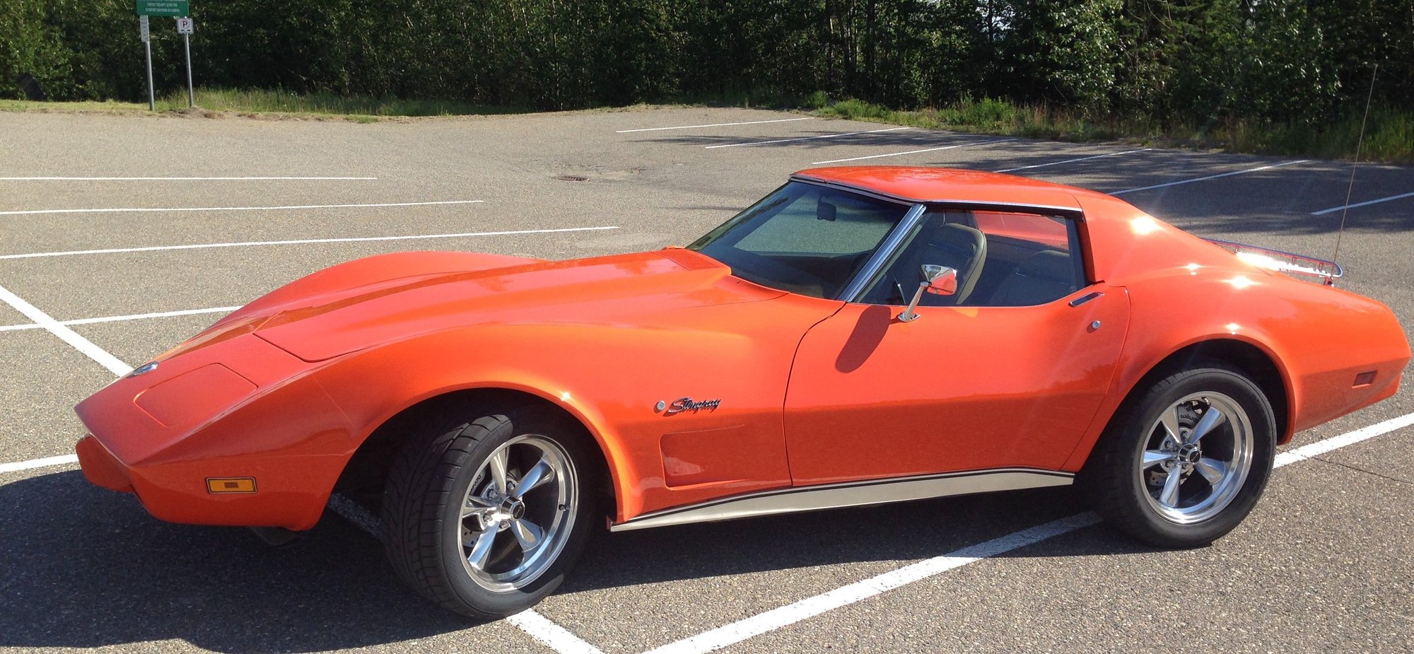

I like 18" wheels on the C3's. Just enough to fill the wheelwell nicely.
Here's my moms car with some 20's off another car of mine...I was just seeing what it would look like. A bit big...20x8.5 front and 20x10 rear. Rubbed a tad in rear when accelerating hard.
