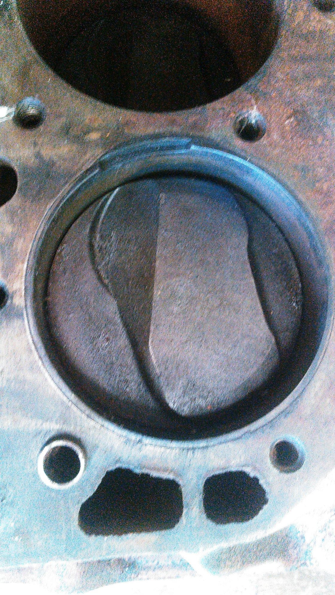

I purchased a 427 Motor to put into my 1937 Chevy Pickup Rat Rod. With doing some research I would like help figuring out the Value of the Motor. Pending the real value, I may not use it in my Truck.
Someone out there can probably put better use to this motor. If VIN 710909 is still out there; that's where this belongs. I have matching heads, exhaust manifolds, flywheel, & other misc parts that were in the barn with the motor. The guy that had them was a racer from the 70's who had passed away.
Here is what I have...... This would have been in one of two cars. VIN #'s 194679S710909 OR 194379S710909 pending a coupe or a convertible.
Casting Information.....
Block Casting: 3935439 = 427
Bore: 4.250
Date Casting: "HIPER" is cast typically where the date is cast.
Under side Cast: G 5 8 or July 5, 1968

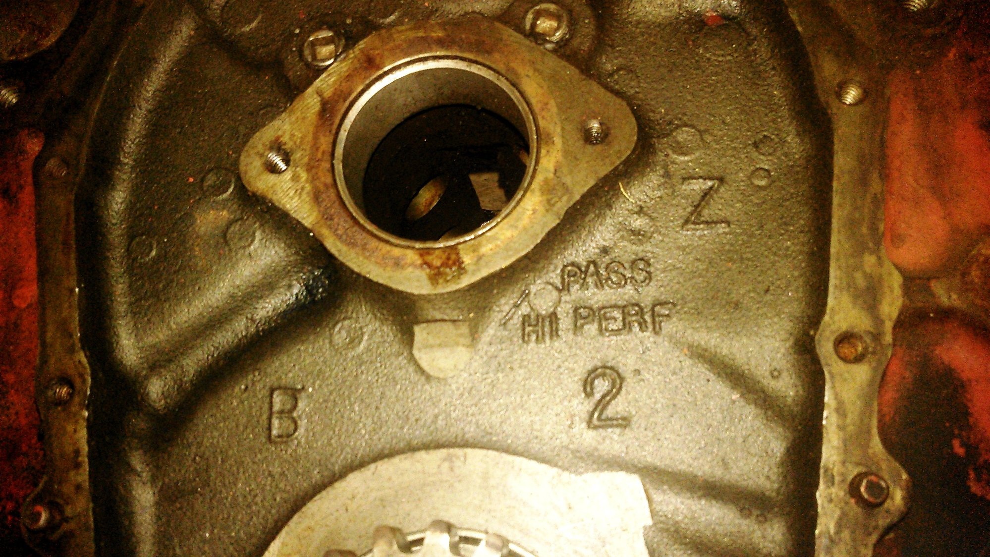

Front Cast by Chain: B 2 Z in different spots. & PASS Hi PERF
Back of Block Cast: HI PER TRUCK PASS BZ
By Oil Filter Location: HI PERF PASS 7 K

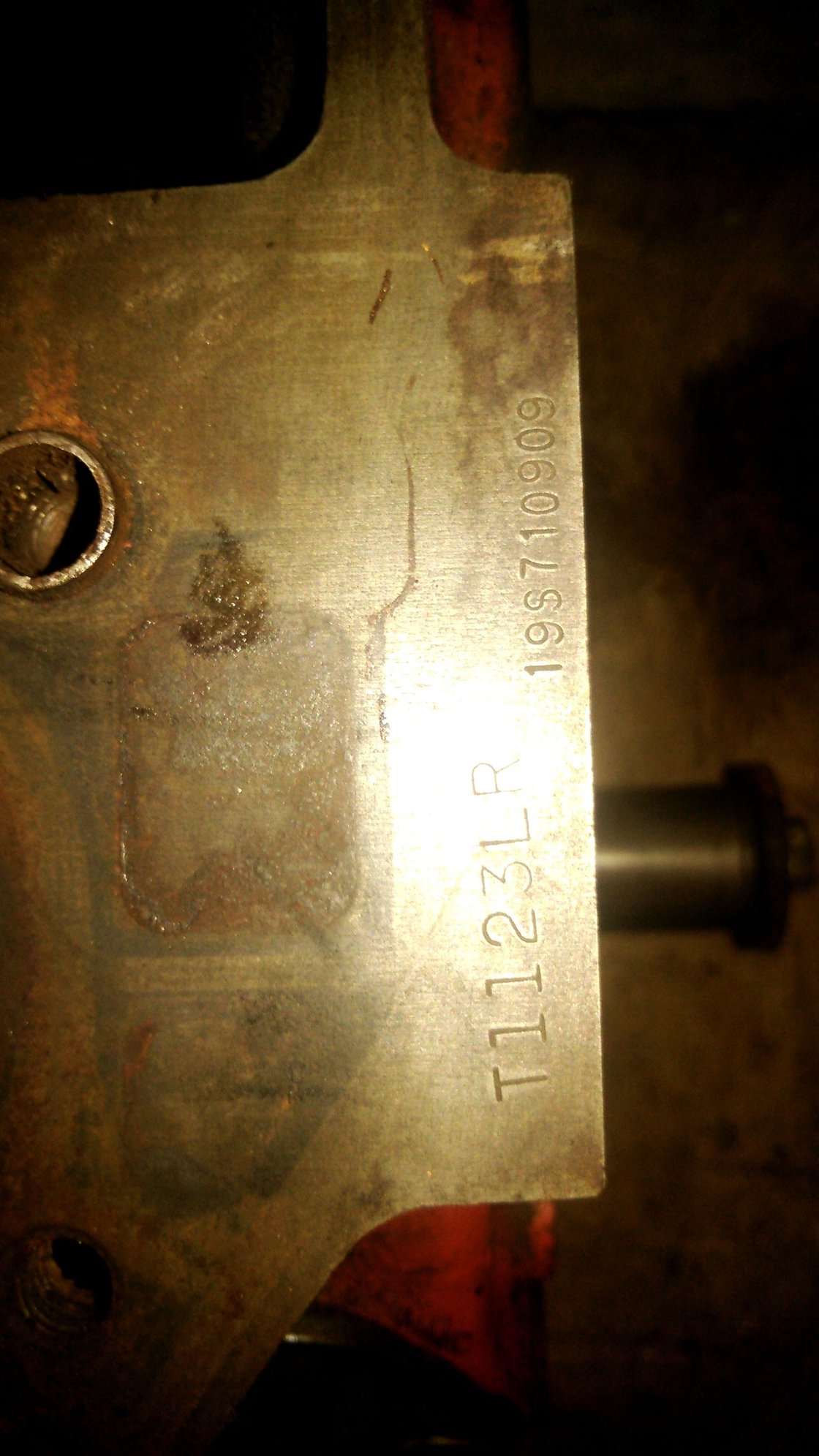

Stamp Pad Info.......
Left Side of Pad: T1123LR
T: Tonawanda
1123: November 23, 1968
LR: 435 HP with Holly Tri-Power
Right Side: 19S710909
1: Chevy
9: 1969
S: St Louis
VIN: 10909

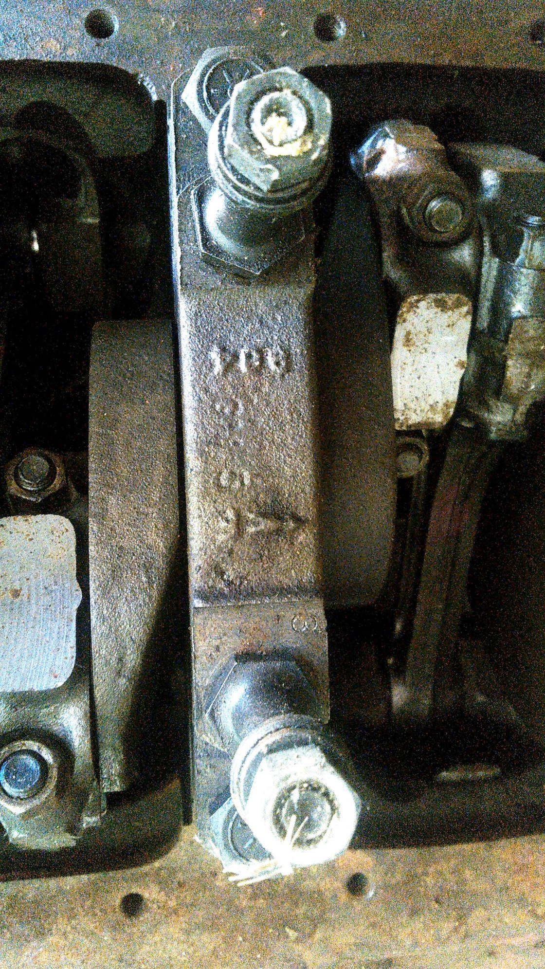

The motor has the Pistons installed with the Crank. It is a 4 Bolt Main.
SO..... With this information, can anyone give me a real value? I have seen values all over the place. THANK YOU!!!!
