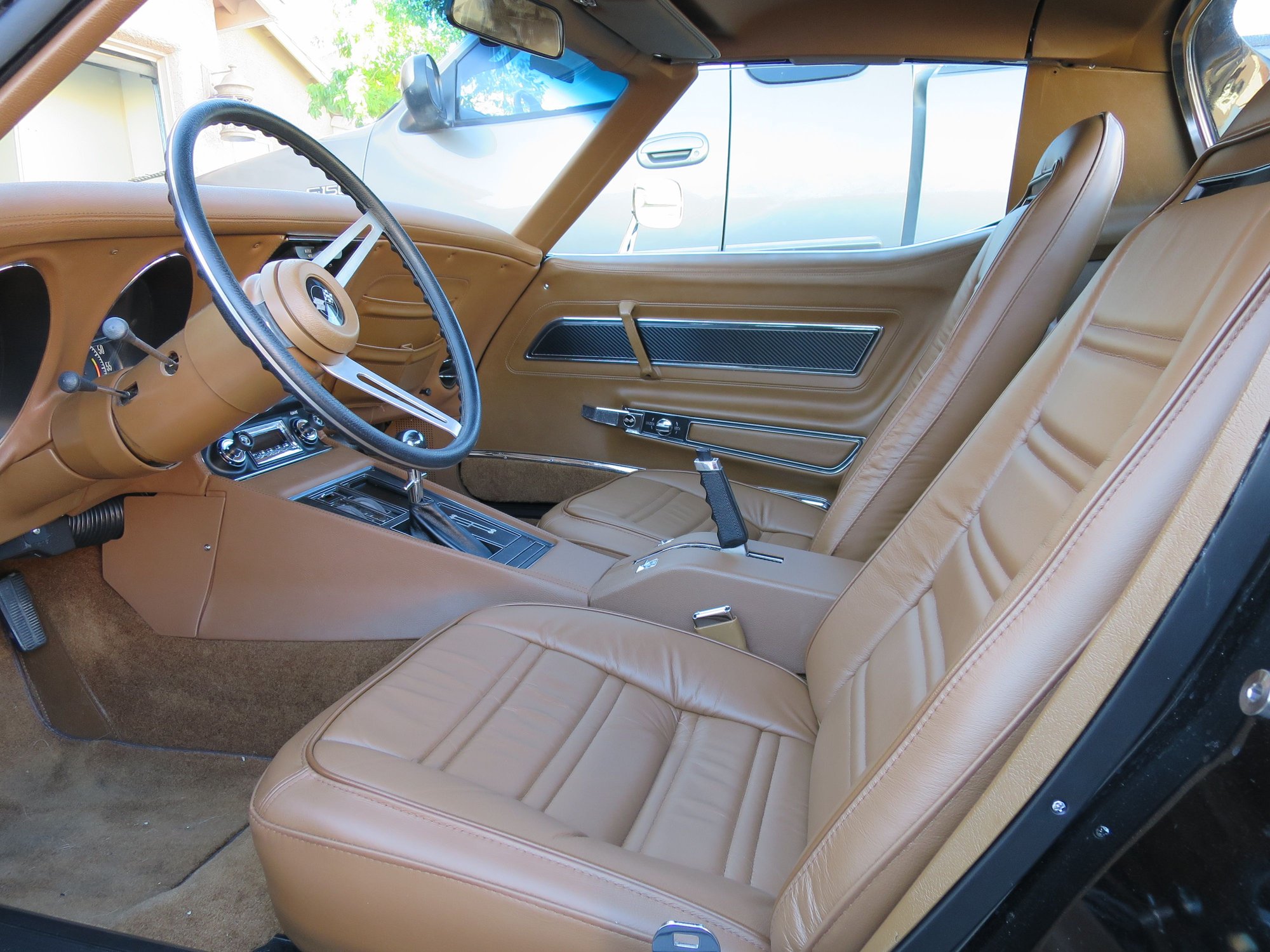

I did mine, with the help of my wife not that hard. I even installed new foam.

just the hog ring pliers, and I bought them with the clips covers and foam all came from Wilcox corvette. There are a lot videos on how to do them.
