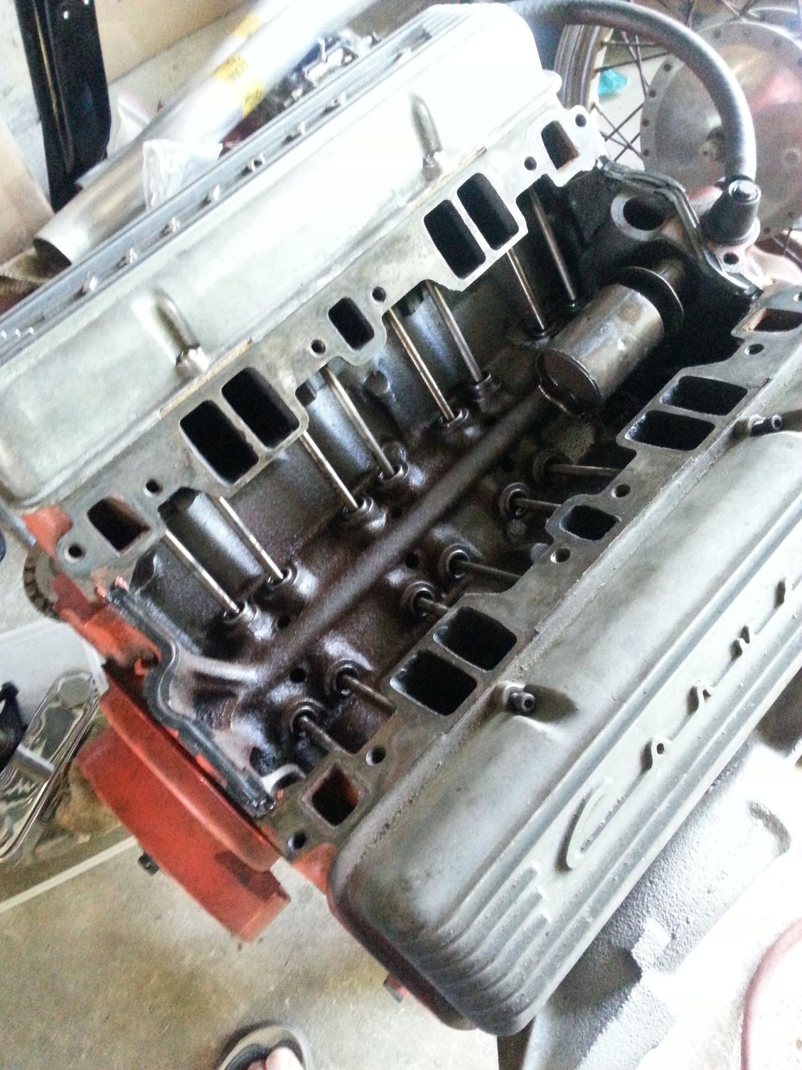

I picked up a CE 68 engine for my car for a price too good to be true
Then I opened it up to look see what I got
Cleaned it up to see the damage, a little surface rust on the front push rods an lifters.

wow, they must have gotten in through the distributor hole

looks like more of a mouse nest than a mouse trap

I'd say it's earlier than 68. Road draft equipment was gone by the mid 60s. Front mount is C1; Valve covers and carb are C1-C2 items. Nice find.

Agree, that would be a 283 probably

It's a 68 large journal 327 3933180 casting with 1966 461 heads a 1962 carter intake manifold, it came out of a 1960 and it was not original to the car.
